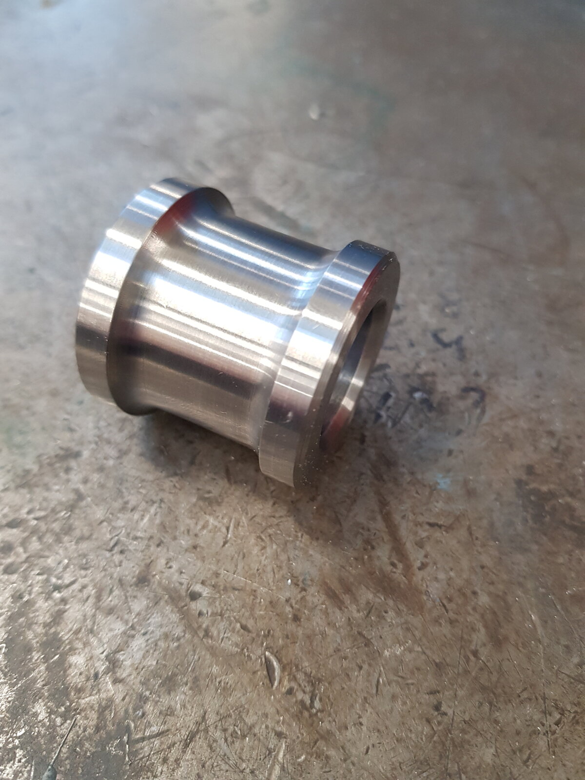

  9. Crankshaft flywheel nut spacer. EN24T steel.

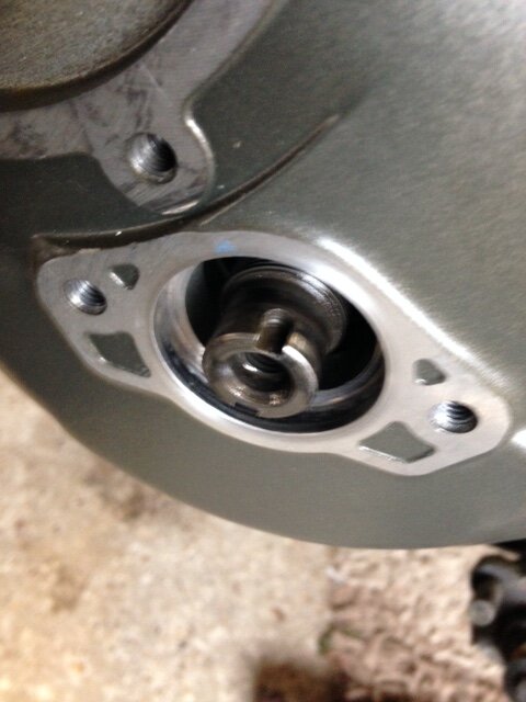

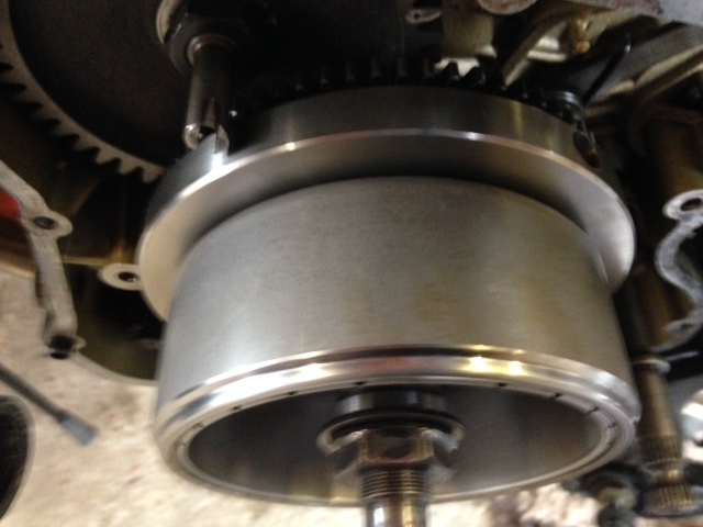

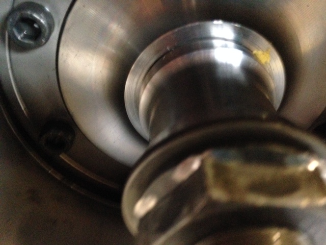

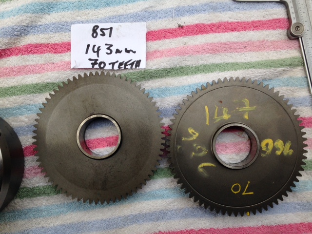

  11. 996 rotor and flywheel with 851 starter gear..
  12. Tried to use the 996 gear but couldn't get it to mesh with starter gear. Measured 996 gear and the 851 gear O/D and the 996 is 4mm wider. Both are 70 tooth...
    Fitted the 851 gear, perfect fit..
  13. Spacer in place..

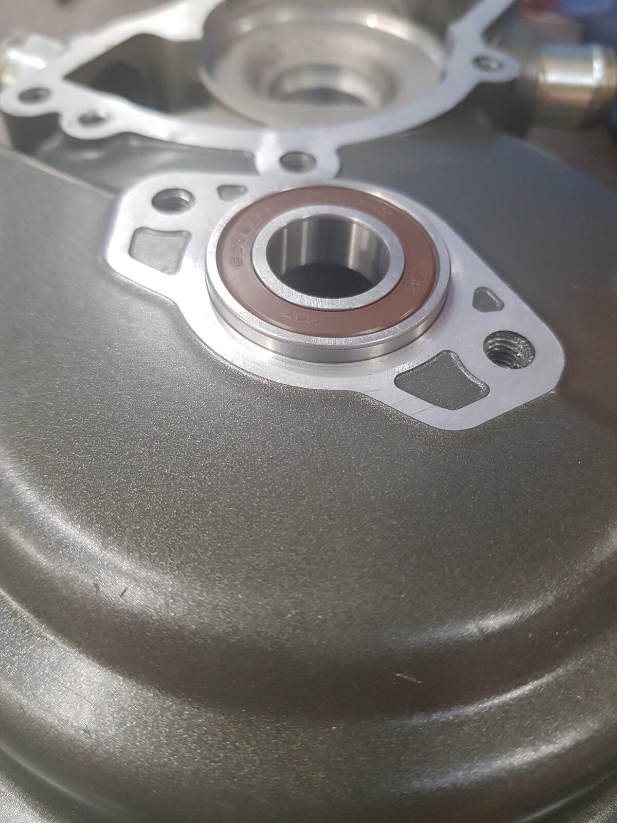

    Cover fitted [pro temp] with no bearing in place to make it easier to put on and off..

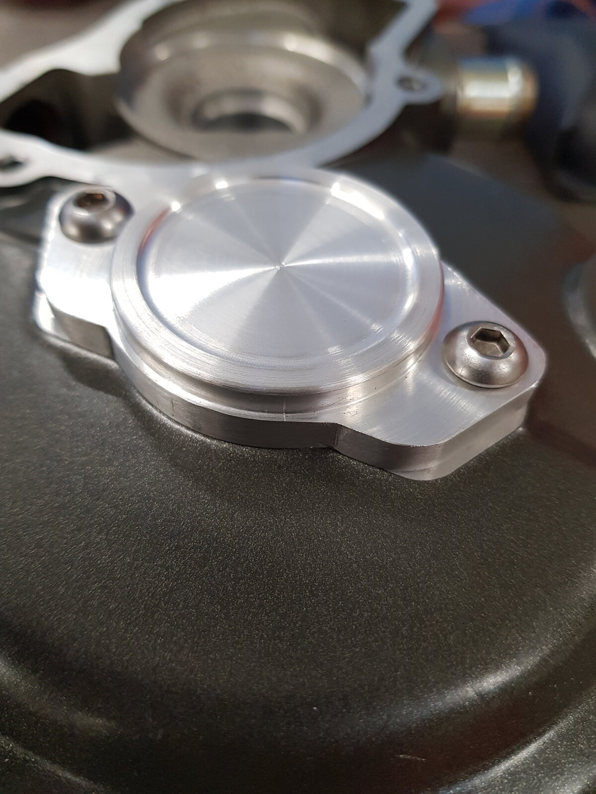

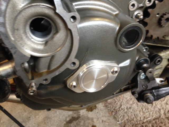

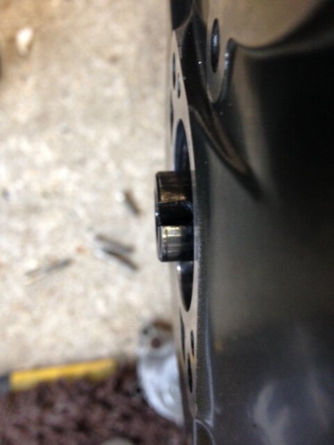

  14. 851 crank protrudes 5mm past casing...

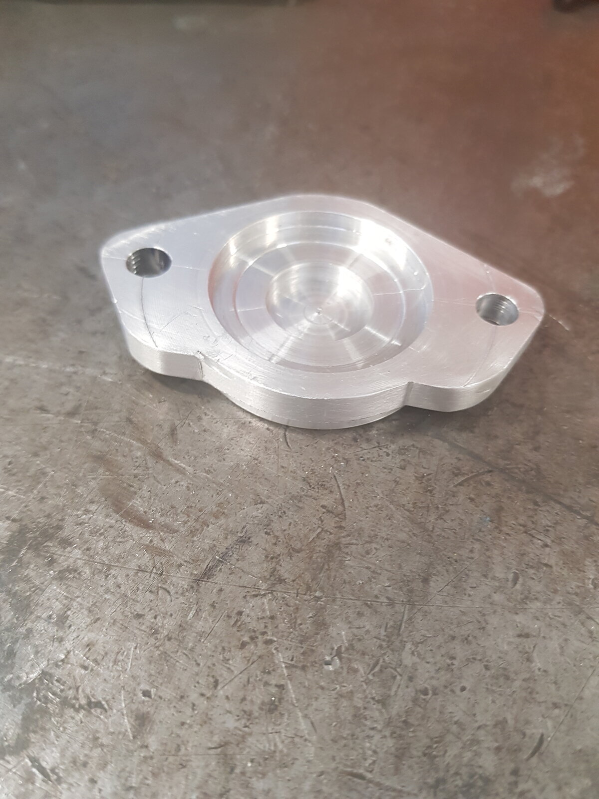

    FE milled an end cover to fit..
