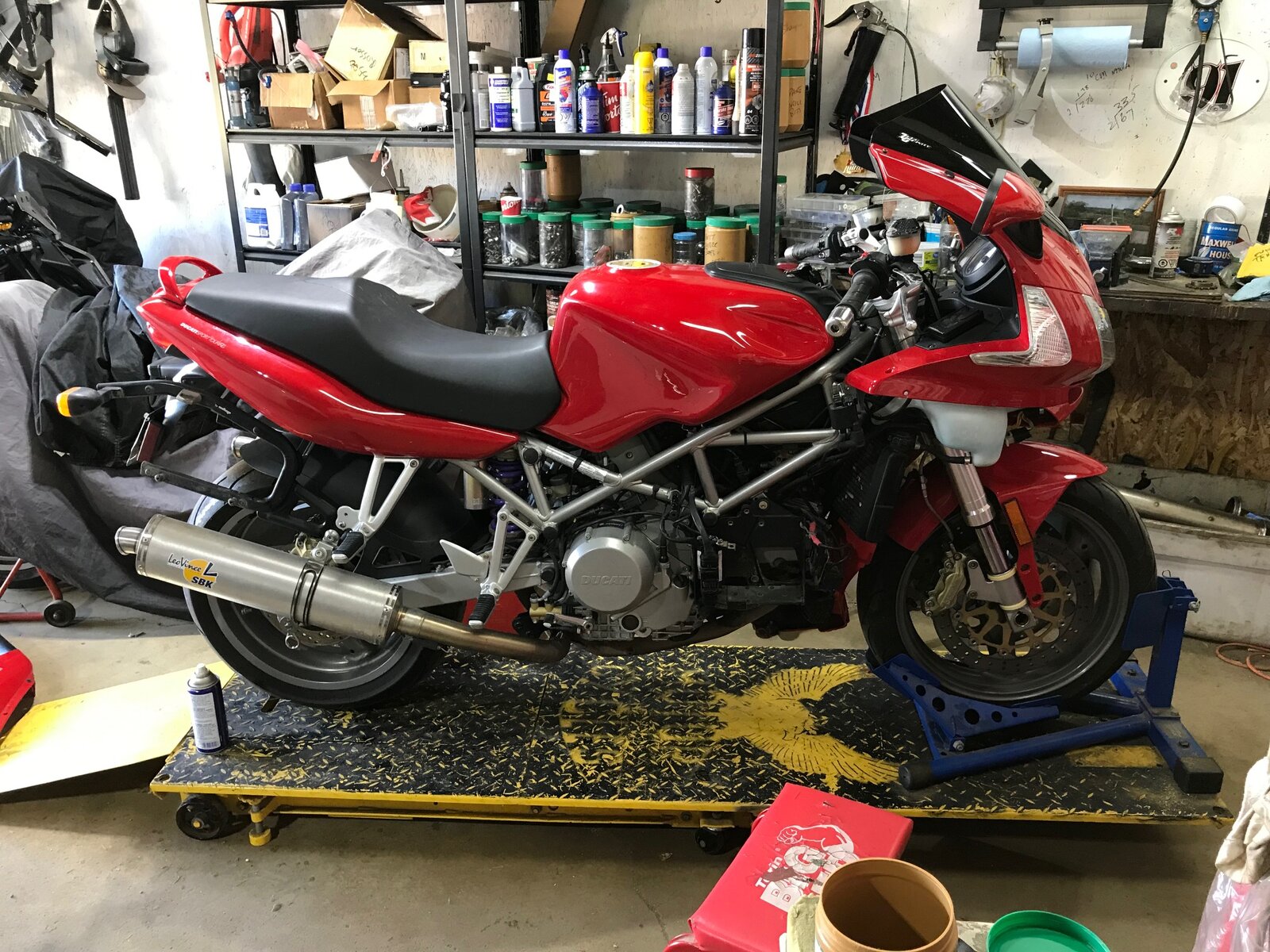

    Picked up a lower mileage ST3 for a great deal, off the wife of a former race buddy who passed on, sadly. 24,000kms, fired right up after sitting for awhile. As soon as I got it home I went to work:
    Hope to create my own 851 replica similar to the ST2 project featured here and in Performance Bikes magazine before it went off the air...

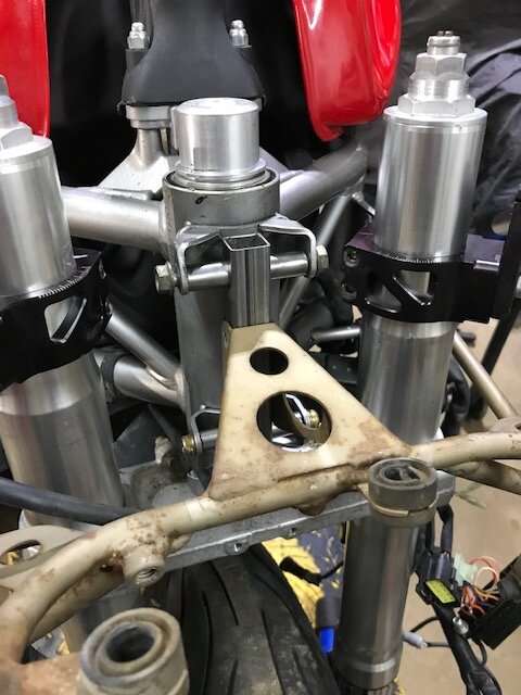

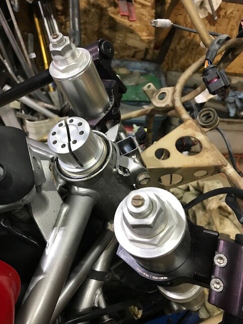

    I also spent some time test-fitting the 900ss fairing stay I had lying around. It will need to be significantly modified to bolt to the headstock, but as I have no access to a 3d printer or a milling machine, my solution will be steel. My current clip ons (risers) won't work.
    The next plan is an alloy swingarm, and a set of Monster s2R forks (fully adjustable) and an ST4 top triple clamp (as the monster forks are shorter). Forks and swingarm inbound...

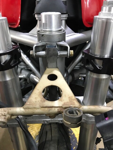

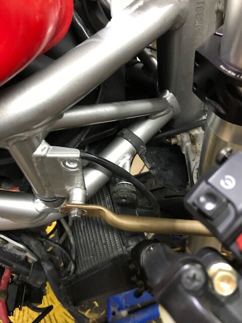

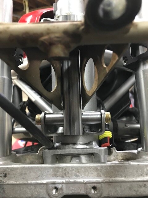

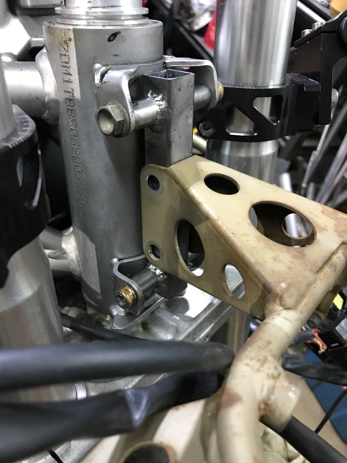

    Start the process to fabricate an adapter to mate the 900ss fairing stay with the ST3 frame. Some 3/4" square tubing, some 1/2" OD round (which the M8 bolts slide into nicely), and some careful measuring and drilling. Looks like it should work in principle.
    As a bonus, the side "ear" of the fairing bracket mounts to the coil bracket very conveniently!
    Center everything...
    While admiring the S2R1000 monster forks (full adjustability). Thought I'd go for something more "period" than GSXR forks or something with radial mounts. These are much shorter than the ST3 legs. I'm 99% sure an ST4 upper triple clamp will work with the shorter forks.
    And crack on with the welding. The old acetelyne torch comes in handy again!
    That should work. I'll wait until I decide on the bodywork (from where/whom, not what) before I drill the mounting holes in the adapter.

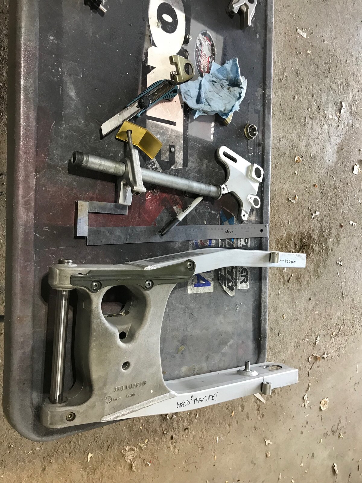

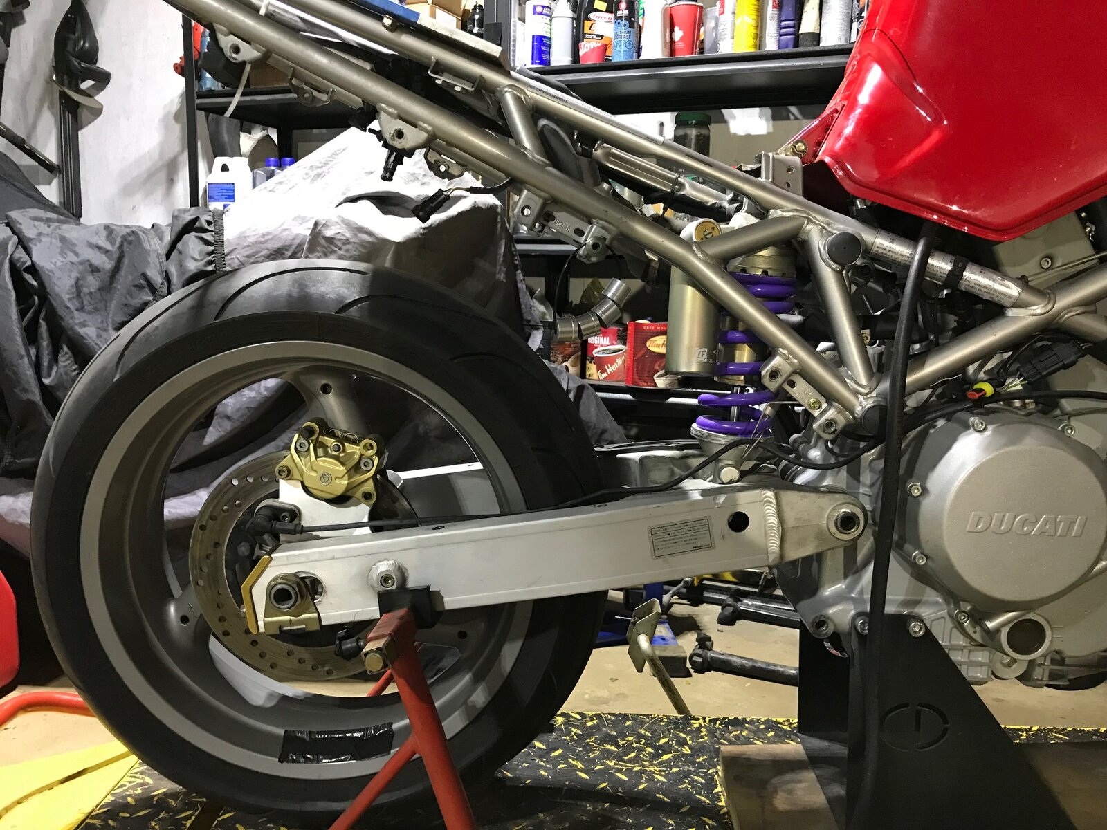

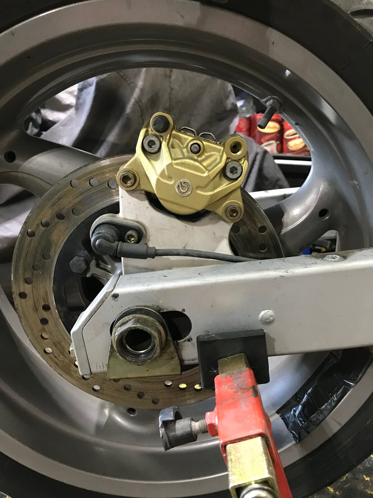

    The aluminum rear swingarm showed up. I took some time to clean it up, and mock up the location of mounts to be welded for swingarm spools. I can't weld aluminum, so if I do proceed I'll need to take these to my welding guru to do. Might just leave them off and use the "pad" style swingarm lift (although I much prefer spools!)

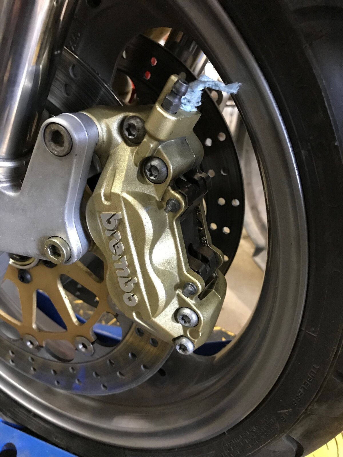

    I also went 2 for 3 on the calipers. Turns out one of the front calipers had some torn seals, so I guess I need to spring for a set of brembo brake caliper seals. Will get 2 sets I suppose, as it's always good to have a spare.
  6. Rear swingarm on -- took the opportunity to clean up everything and re-grease the swingarm pivot bearings in the case while I was at it!

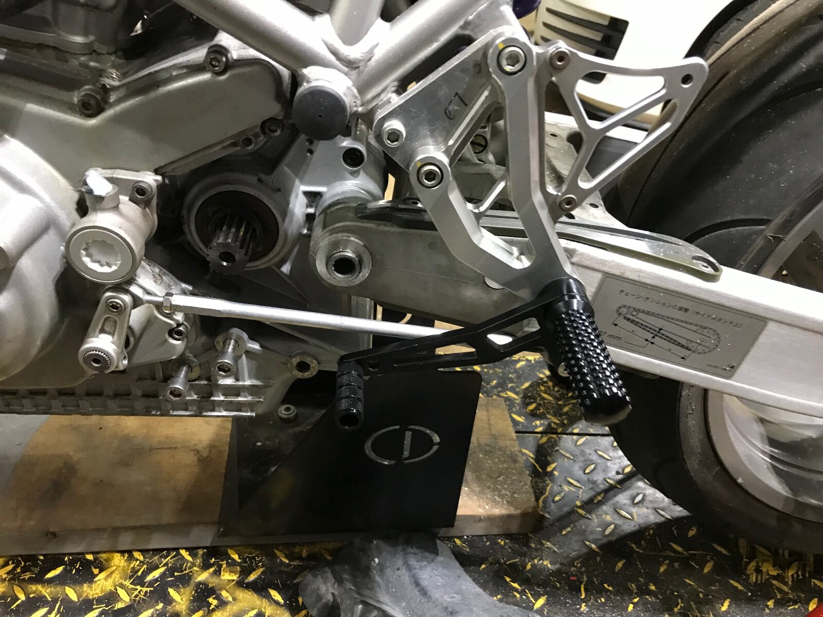

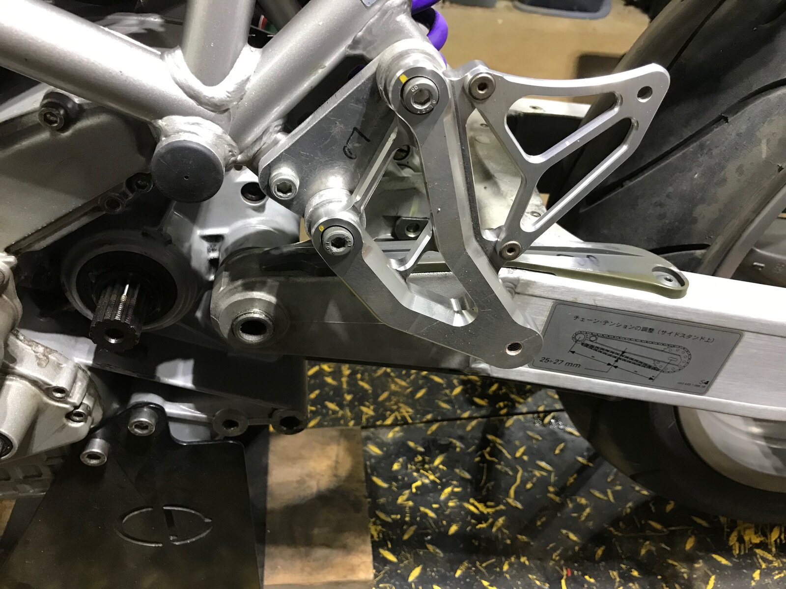

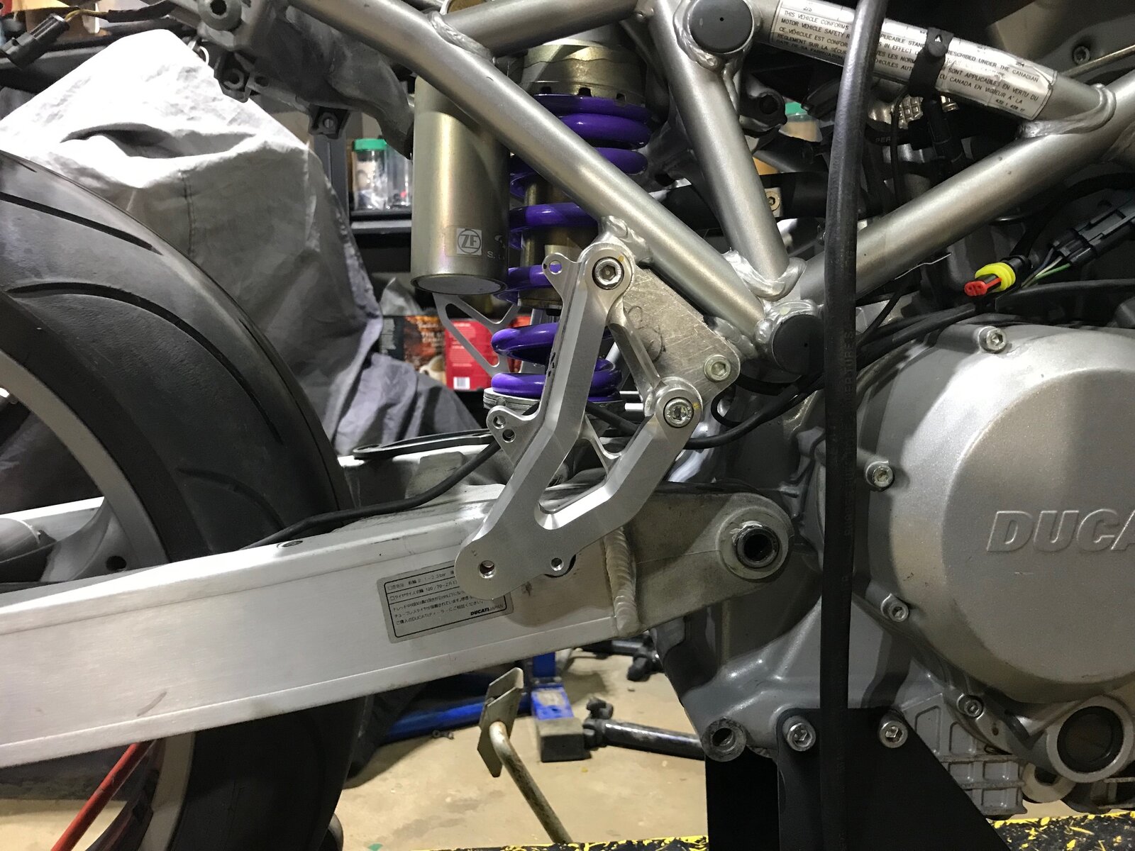

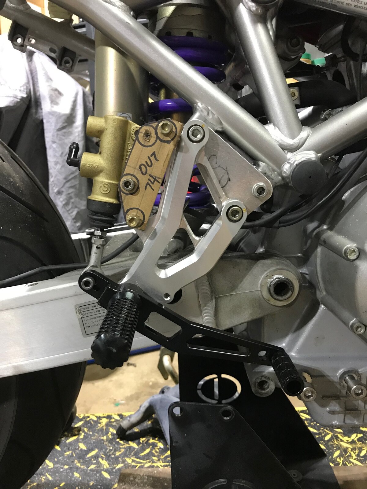

    A quick glance at the prices of new or used aftermarket rearsets reveal they are either quite thin on the ground, or obscenely expensive. Some research showed that both the monsters and the STs shared the 70mm mounting spacing, so I was able to pick up "just the rearset plates" from my favorite Japanese source. However when mocked up, they actually moved the peg location a few mm closer to the swingarm pivot -- opposite of what I wanted.
    So it was time for some CAD -- Cardboard Aided Design. I made some adapters out of some 3/8" alloy plate I had handy. I moved the peg location up an to the rear, as befits a racier rider stance.
    This is all done by yours truly, without a mill. Some careful measuring and my handy drill press got the holes marked out, and then some quick access to a bandsaw and a sander (not mine) got things serviceable. I'm waiting on some chinese pegs and levers off of ebay to test fit. They might work well enough to keep, but if they are crap at least I have a proof of concept to buy some more expensive items from driven or woodcraft.

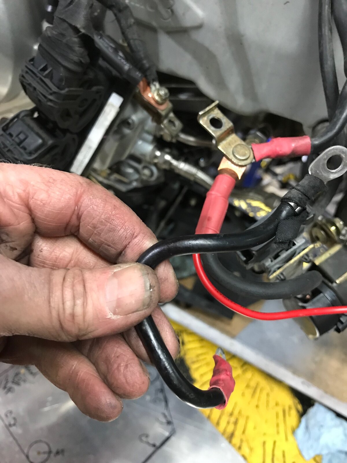

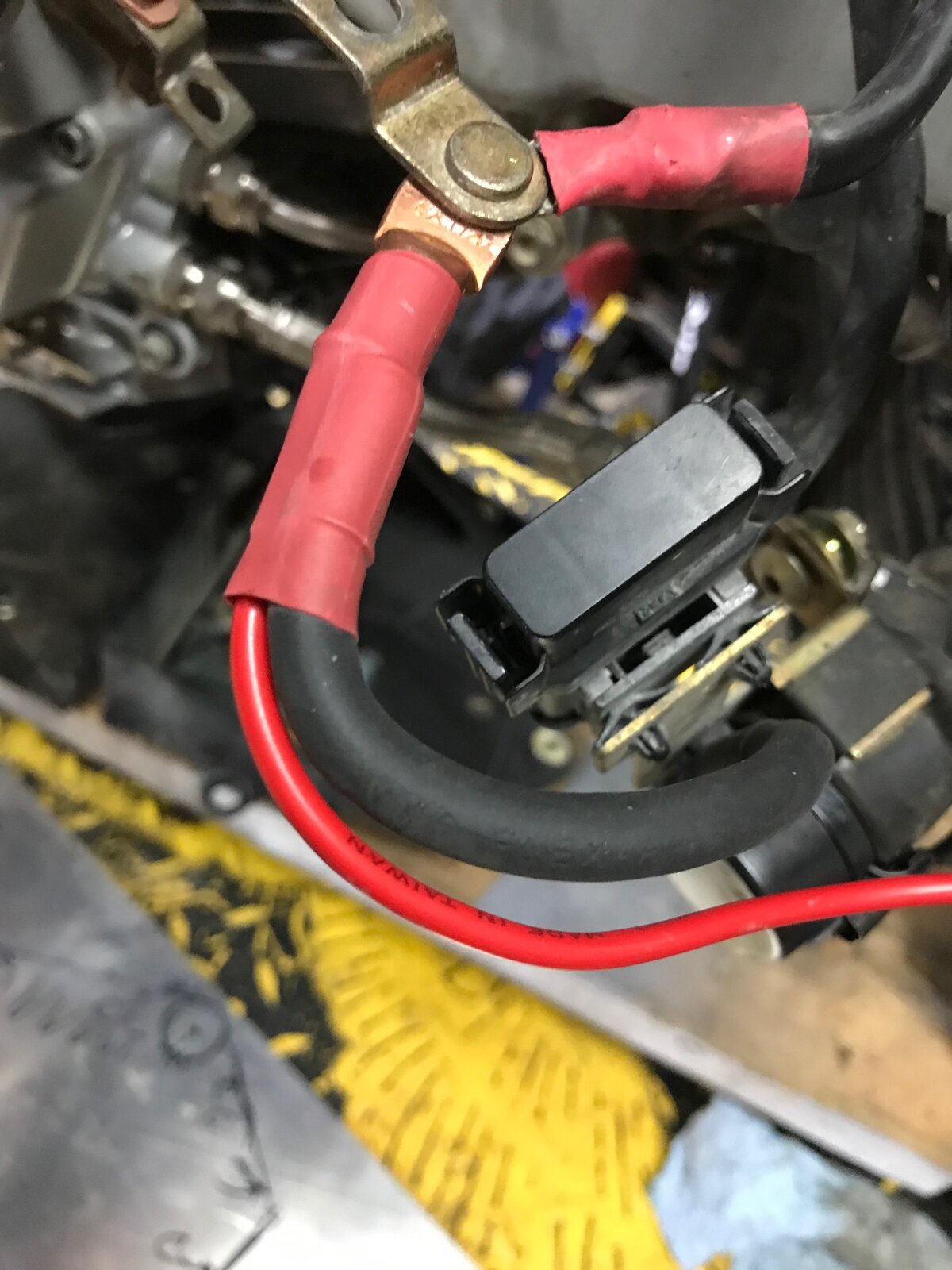

    I have also been upgrading the wiring. Rather than buying a set of "custom" starter cables, I make my own with high quality 6ga welding wire (bought by the foot) and some eyelets.
    I've soldered in a pigtail for the reg/rec -- I plan to use a mosfet one, wired directly to the battery.
    Compared to the stock one -- already stiff and maybe brittle, despite being thinner gauge than what I'm using to upgrade.
    Also did the lead from the starter to the solenoid. I was able to re-use the protective boot. Also upgraded the ground strap from the neg battery terminal to the engine. I've removed the plastic battery bracket -- I plan to make a pattern one in aluminum, so I can mount an antigravity 801 8-cell lithium battery. A fraction of the weight of the stock lead one, and will work with an aftermarket reg/rec.

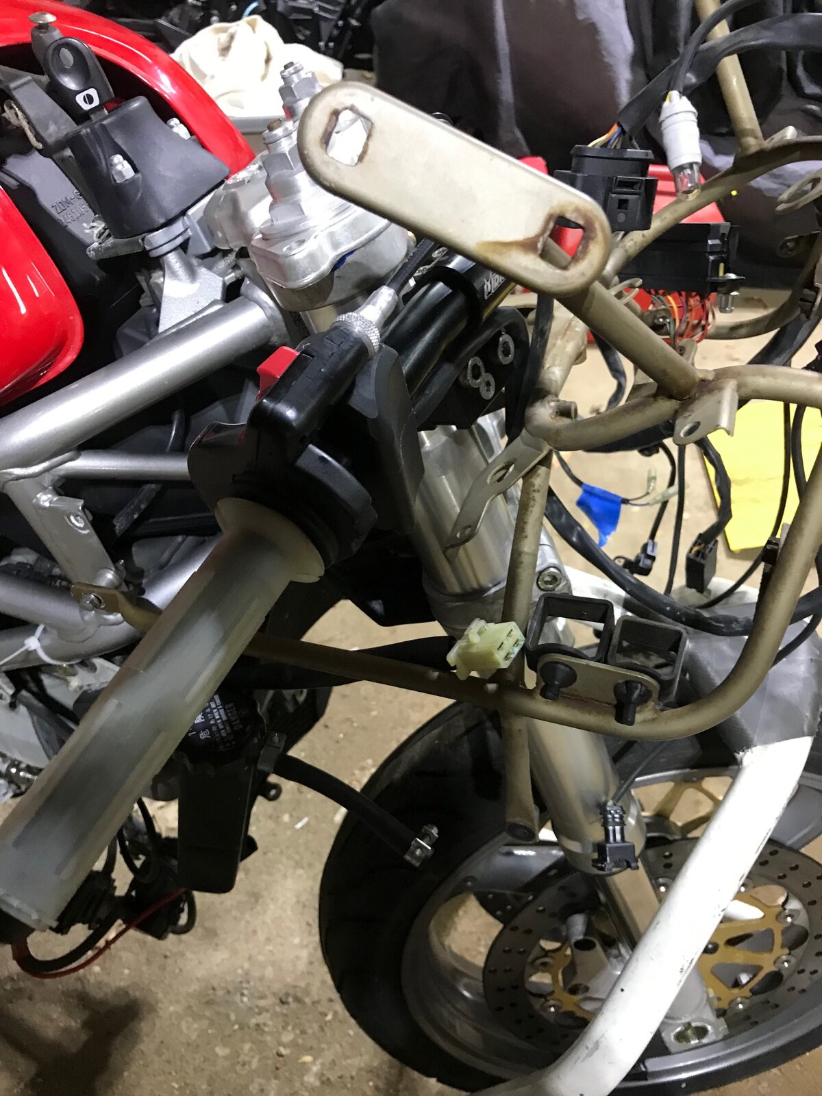

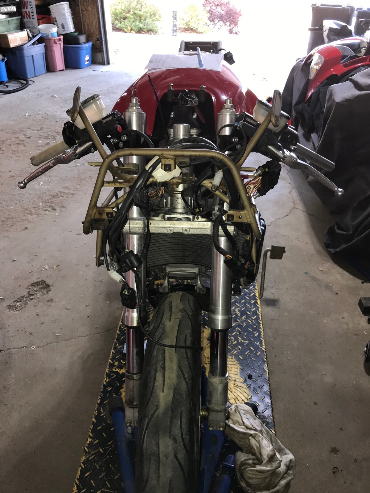

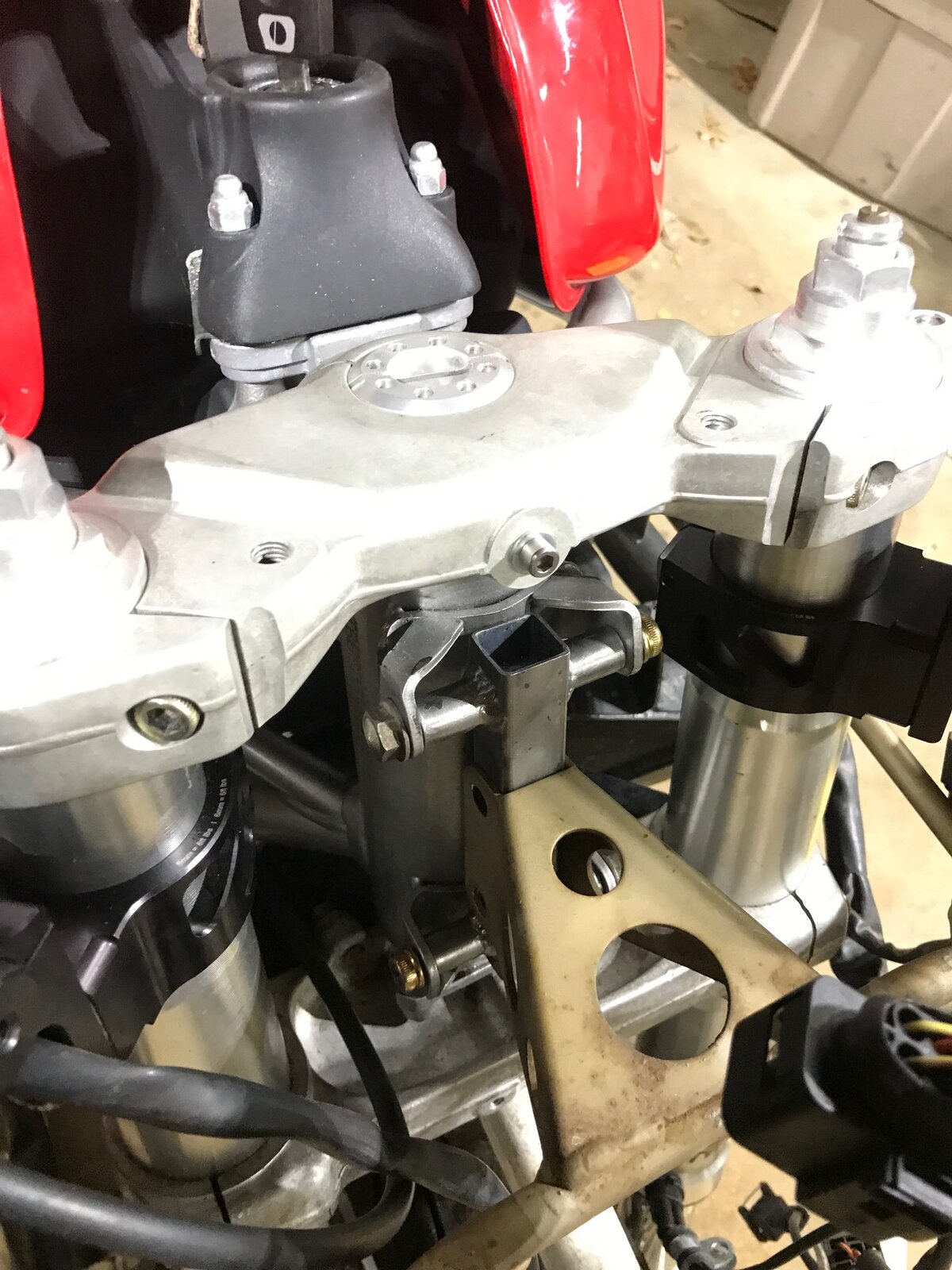

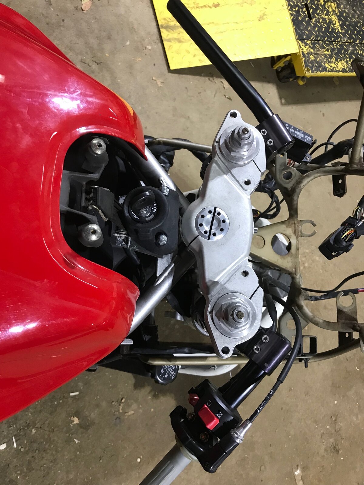

  8. Surprisingly my ST4 top triple showed up on the weekend -- I guess that's the competitive nature of shipping services. Once I had the bike up on the front paddock stand (weight off the forks/wheel) it slipped right on. Result!
    Checked clearances between the tank and bars, and the fairing stay, and nipped things up a bit tighter.
    Glad I have the riser clip on brackets, as one the fairings have showed up I can make some more adjustments.
    Even a neat little m5 bolt to perhaps mount the bracket for the brake and clutch master cylinders.

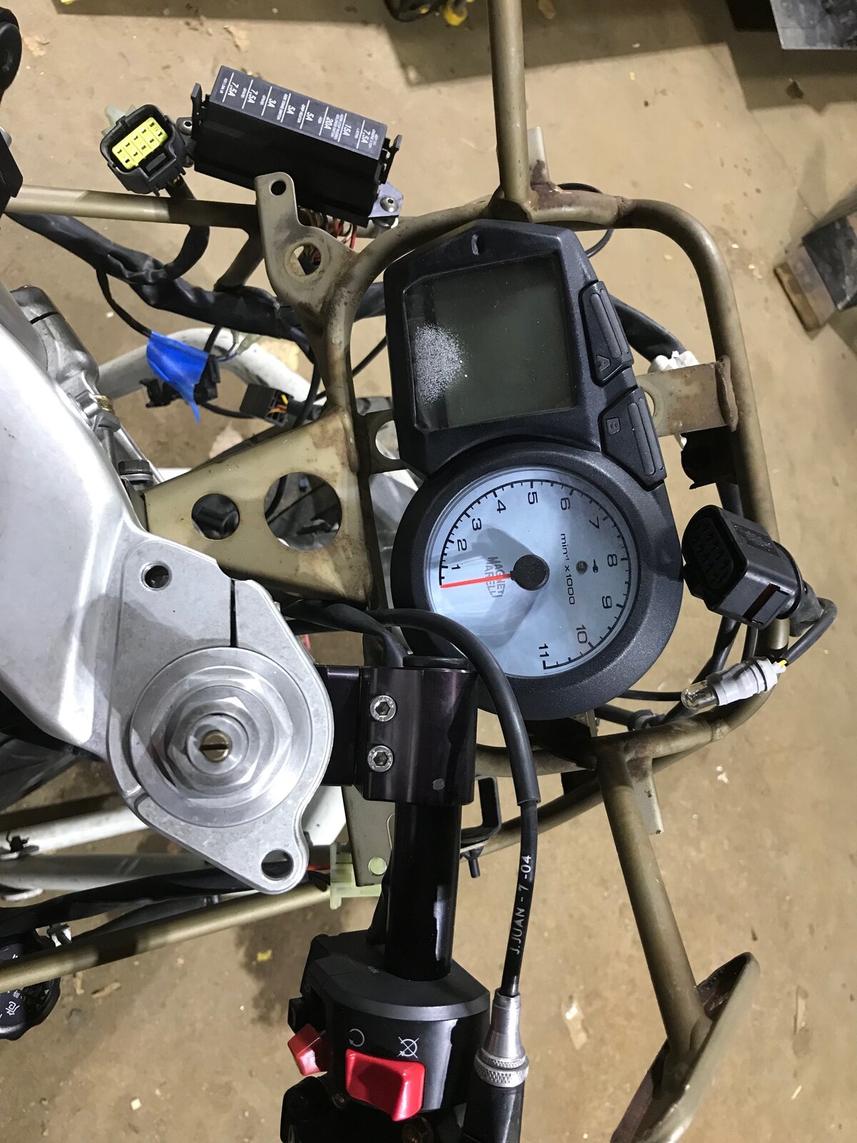

    Quick test-fit of the ST3 guages. They should fit OK once I've fabricated some tabs to mount a backing plate.

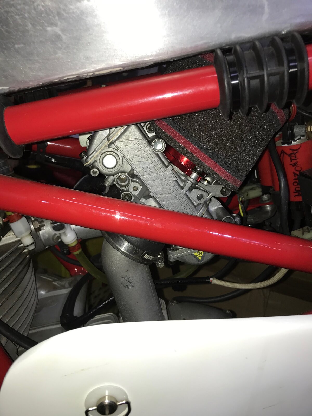

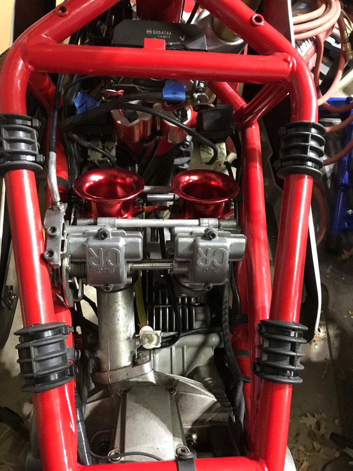

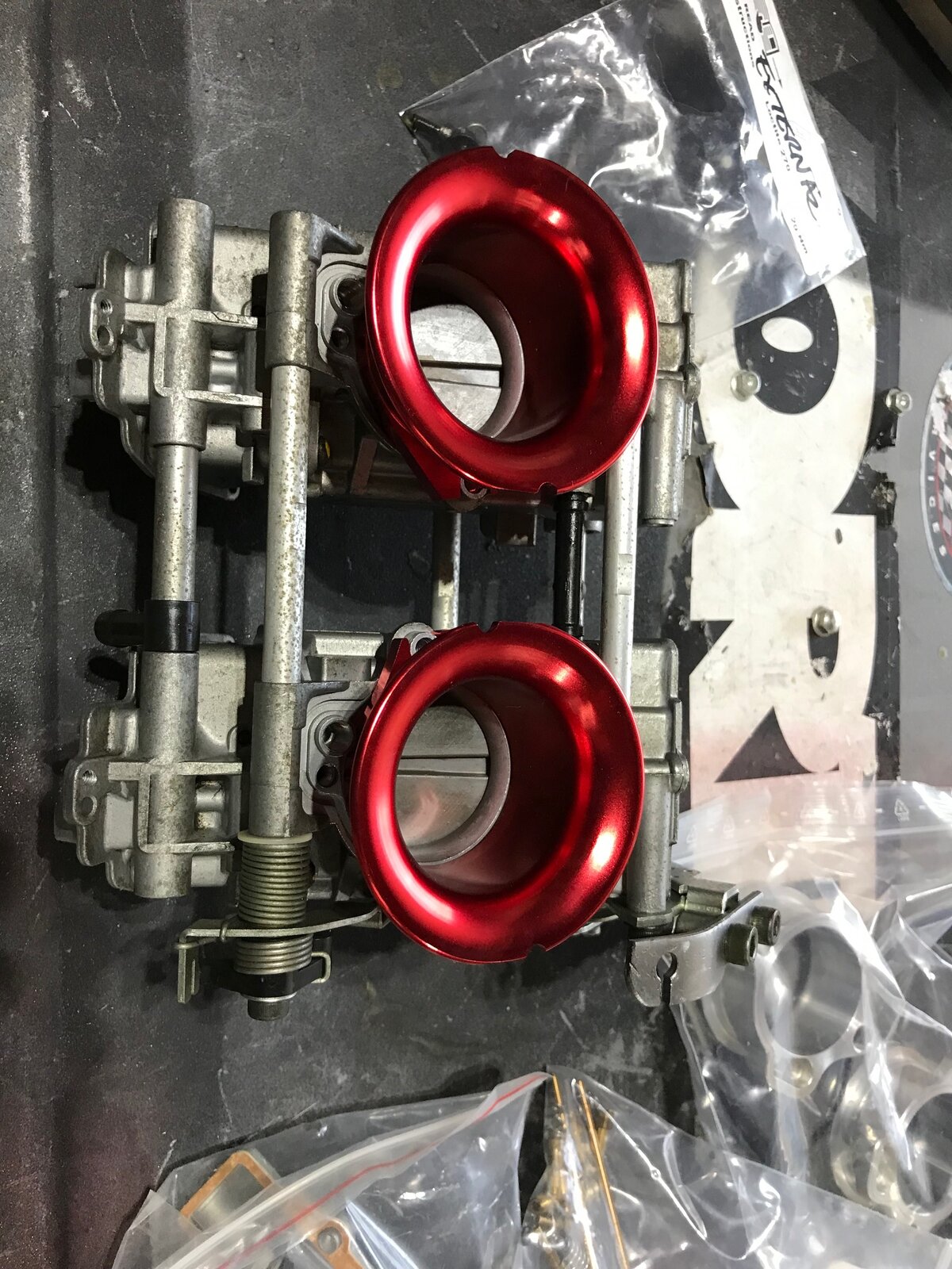

  9. In the other corner of the garage, I was able to track down a set of FCR39 carbs for a good price. They needed a rebuild, but Frank MX parts from Belgium helped me out again.
    These super cheap alloy bellmouths from China fit perfectly and they are a fraction of the cost of the pukka Keihin plastic ones.
    After way too long a wait the rebuild parts showed up, and I put the carbs back together with new gaskets, o-rings, and the like:
    I had to modify the routing of the throttle cable to clear the TT tank.

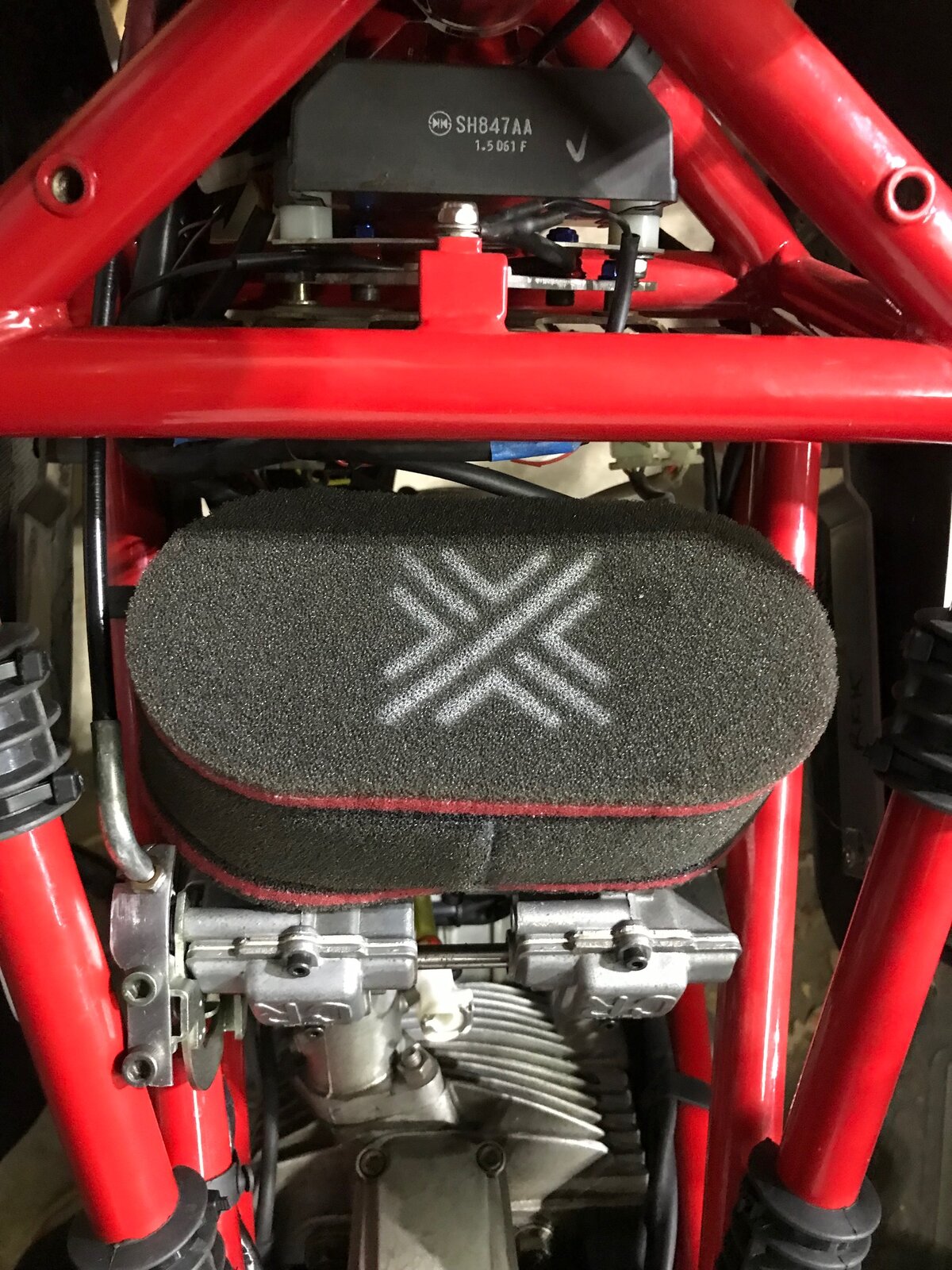

    Pipercross sock filter on.
    And tank mounted.
    Might be too cool now here in Canada to tune the carbs. So they will wait until the spring before I try to get them running properly. Patience....! I've since seen this TT on a youtube video and am thinking that might be a nice paint scheme. Mine is just rattlecan white.

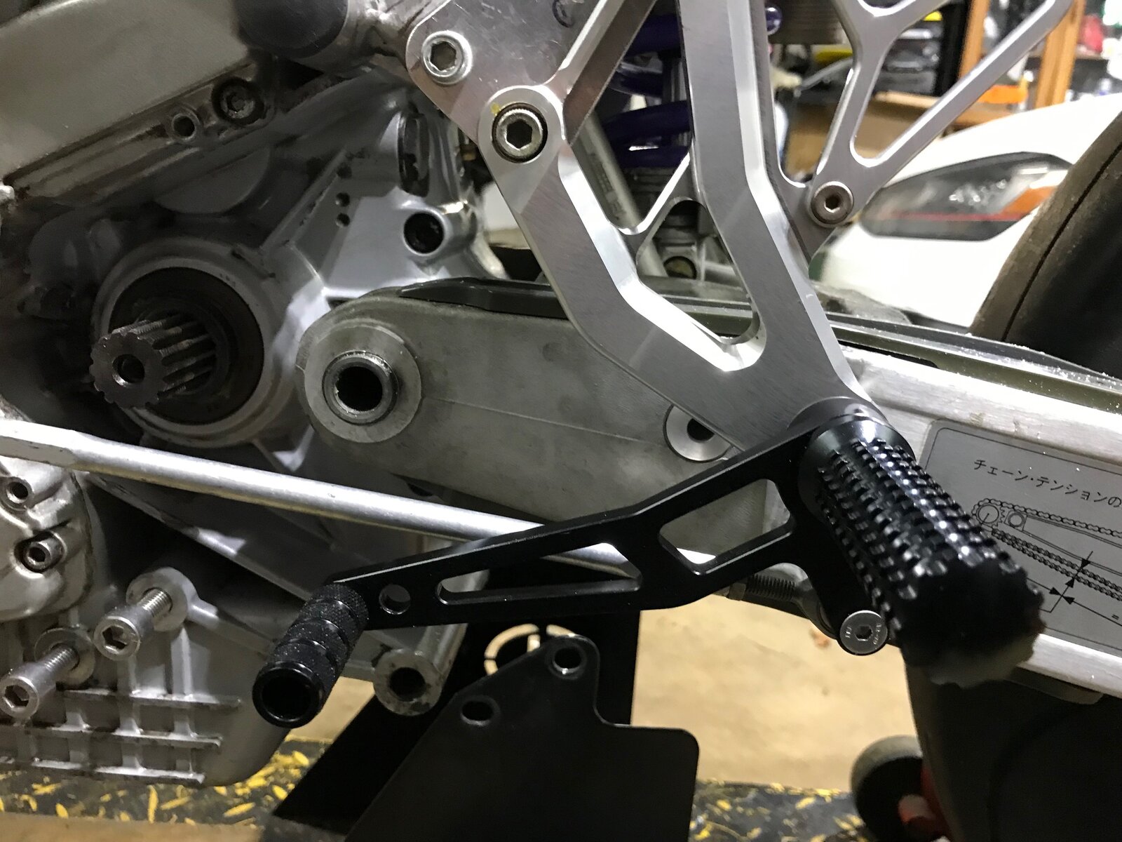

  10. Some more parts arrived today from China -- a set of GSXR footpegs and a brake and shift lever. Super cheap at around $50 CAD shipped, but would they be any good? First blush, it appears that they are decent quality:
    The end of each peg has two locating pins that I need to cut and file off to fit flush against the Aella rearset plates. With a bit of careful work with the hacksaw and file (I don't have a lathe), the end result is the end of the peg sits just proud of the two bearings in the lever. Tightened down, both levers spin freely on the peg.
    Left hand (shift) side.
    Looks like I will need to order a longer shift rod, but it works well in principle.
    Brake side:
    As you can see my first CAD (cardboard aided design) template was a bit off -- that's why I start with cardboard!
    In the end, these are going to work fine. All in, the rearset plates cost me $70CAD plus shipping from Japan (I bundled it with another part), and $50 CAD for the pegs and levers. It's not a bolt on, and I still need to do some fabrication, but at 1/4 of the price of a used set, I'm pretty happy -- plus I got to put the pegs exactly where I wanted to.

    Time to finish rebuilding the brakes. I got a proper brembo rebuild kit (with 2 sides) so I have a spare set just in case.
