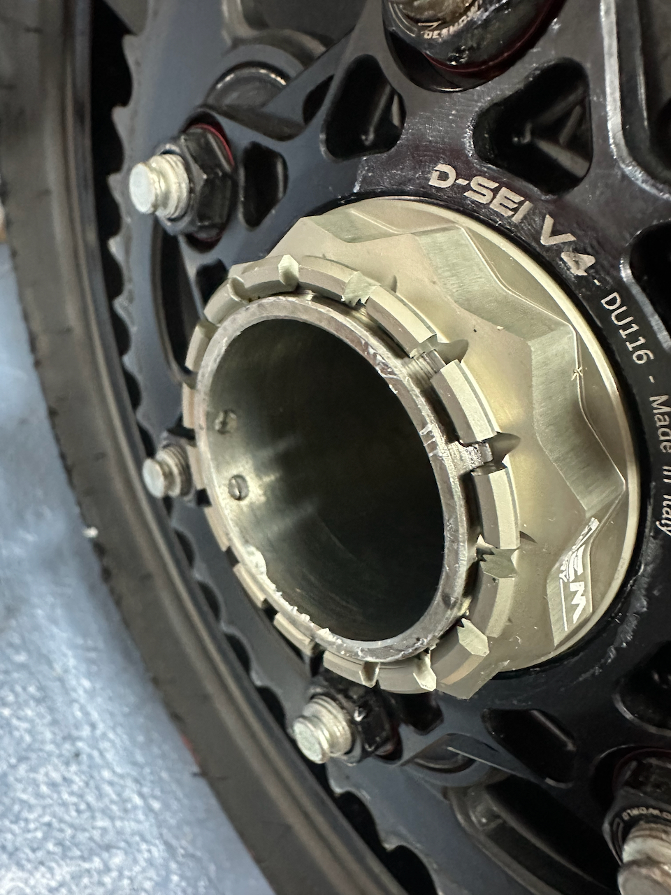

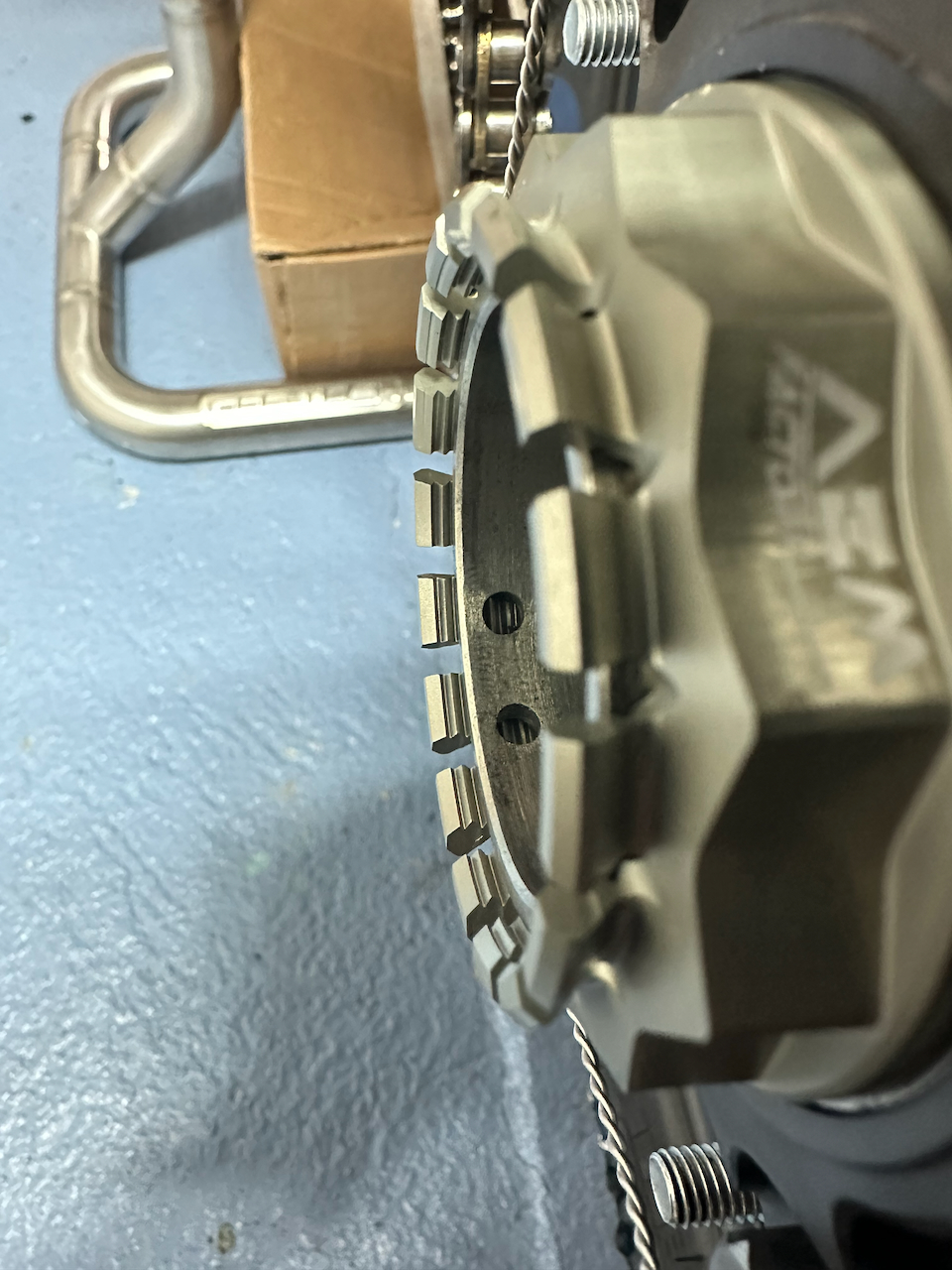

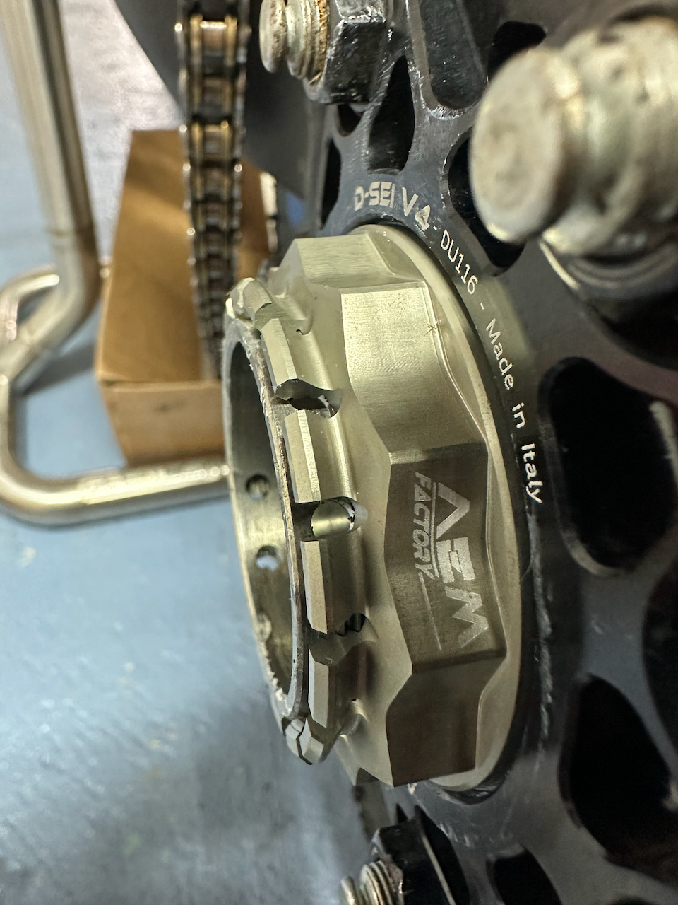

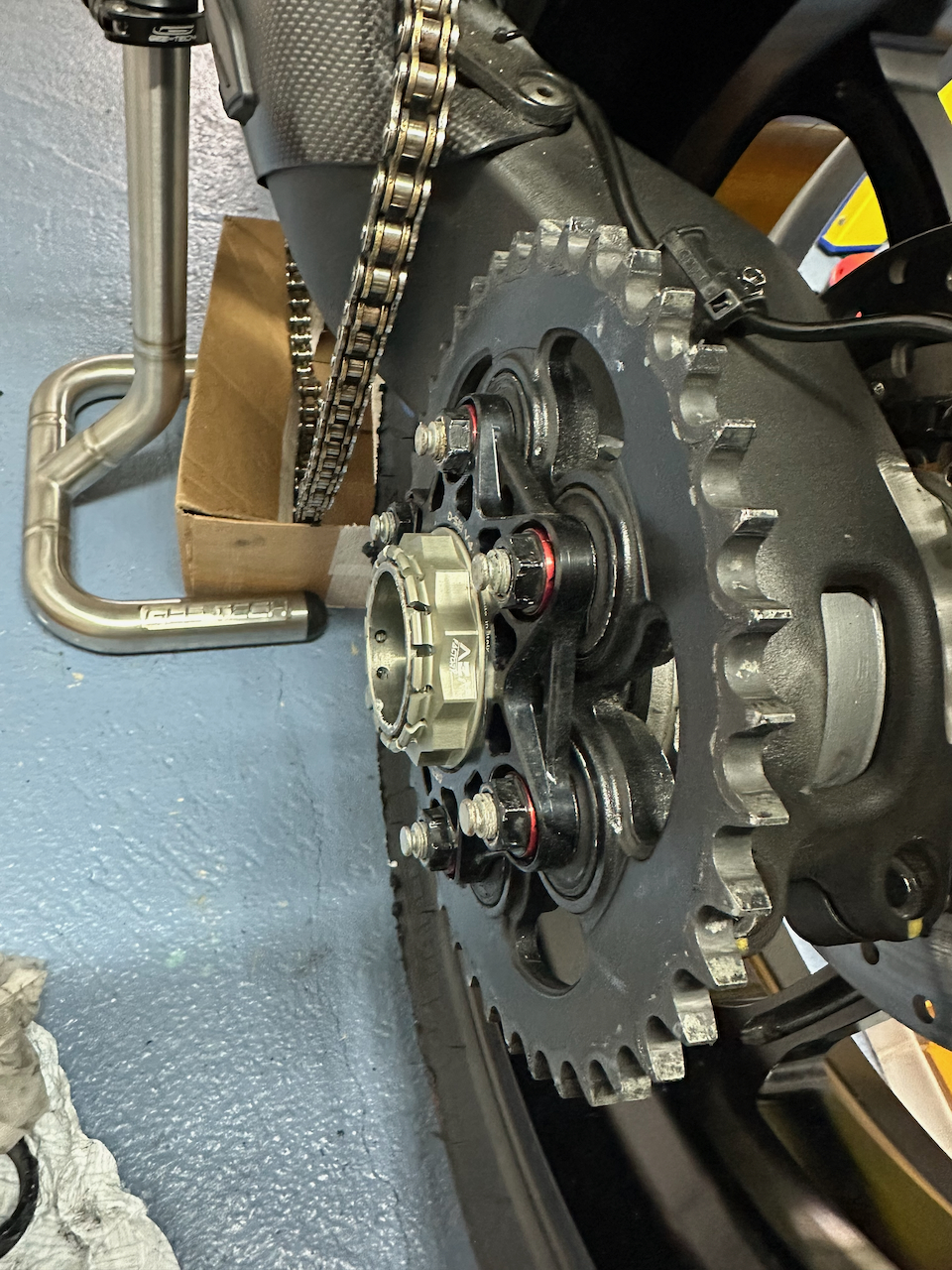

    The nut holding the sprocket carrier on my V4 Panigale does not thread onto the shaft enough.
    I am suspecting that the aftermarket carrier / flange is incorrect, or the spacer between the carrier and the hub bearing is incorrect.
  2. I have tried a different nut I already had (for a V4) and the issue is the same

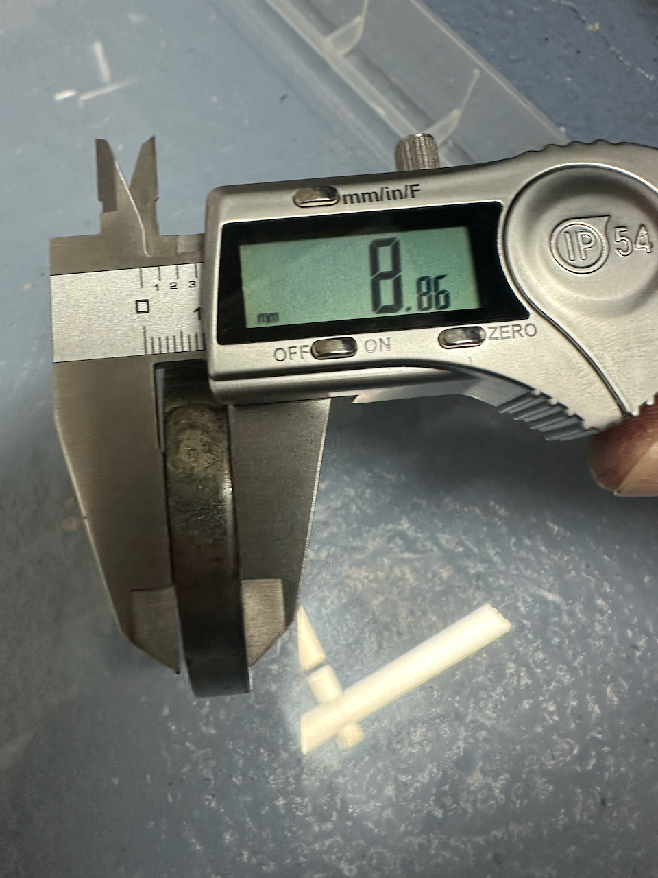

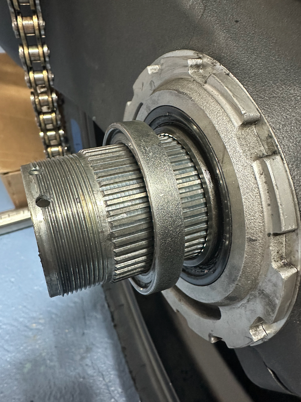

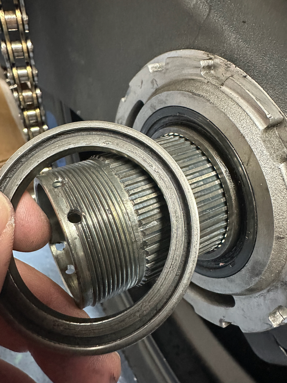

  3. This is the spacer between the carrier and the hub bearing

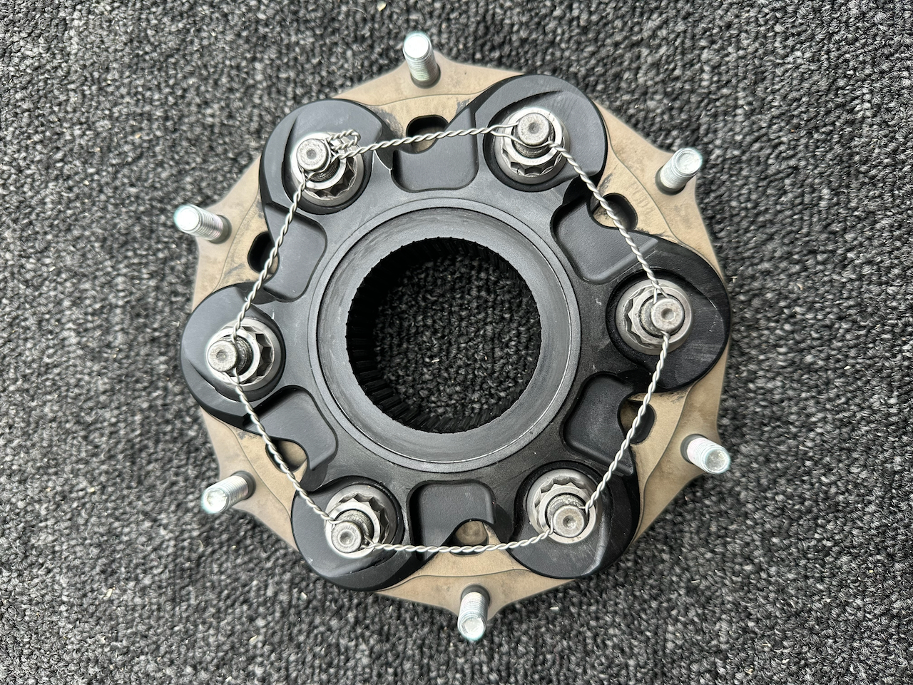

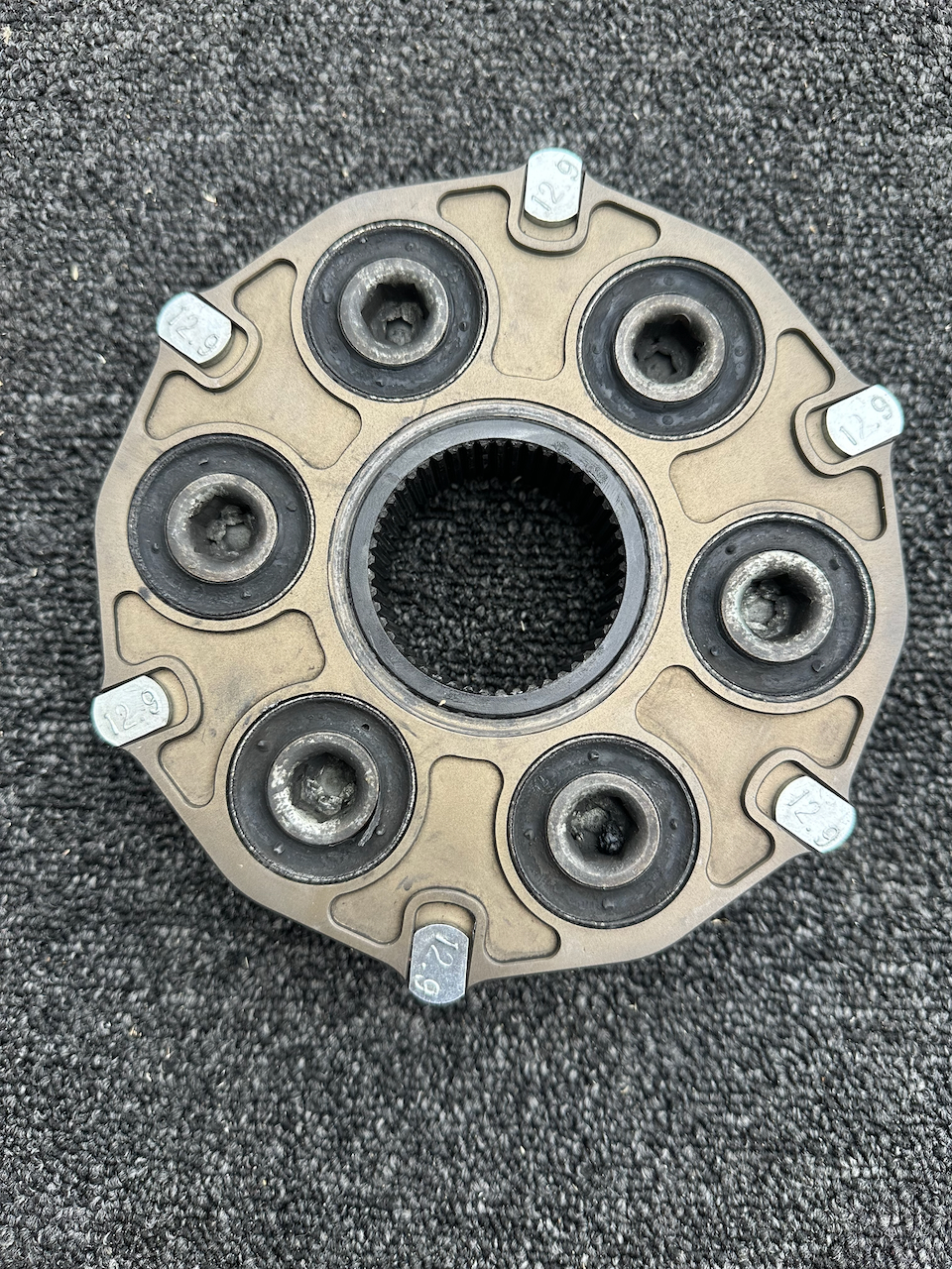

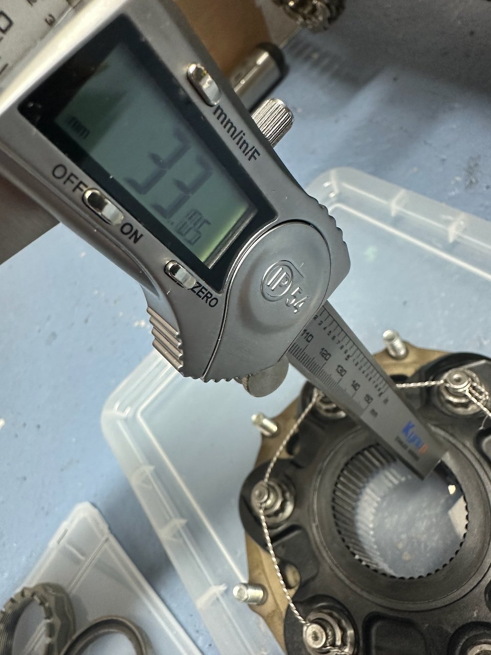

  4. This is the sprocket carrier / flange - does anyone recognise the brand?
    I have tried to measure the depth of this but its a little tricky, I think it may be closer to 32mm

  5. Does anyone have a standard V4 flange they can measure?

  8. Moto Rapido have confirmed the spacer I have is the correct width (9mm) as are both of the nuts (17mm)
    the AEM nut is every so slightly over size at 17.5mm

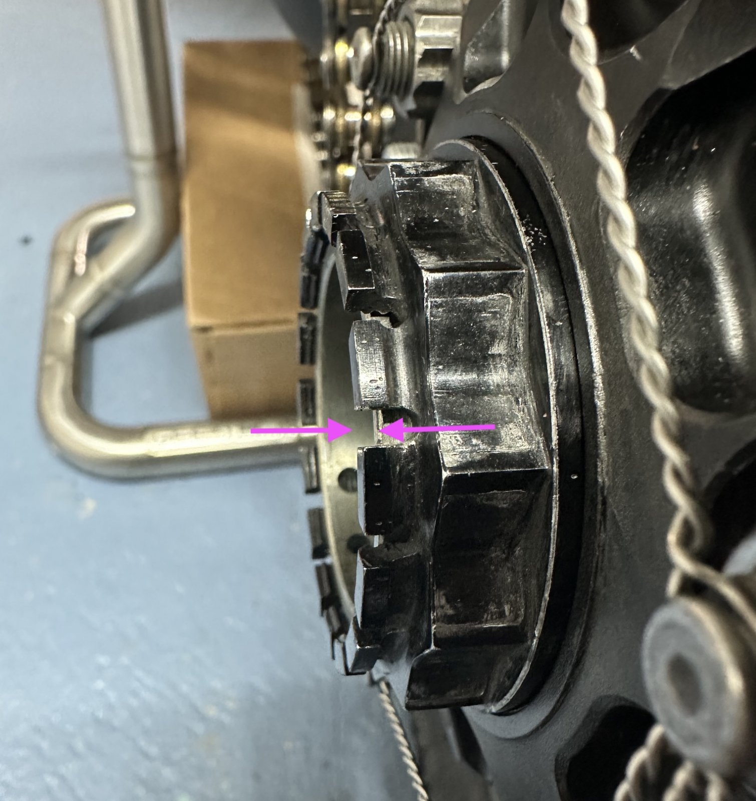

  9. Well..
    I have now fitted a flange / carrier off another V4 and..
    Fits perfectly, everything aligns and the nut threads all the way home.
    I guess someone fitted the incorrect flange / carrier at some point, happy to have noticed that..!
