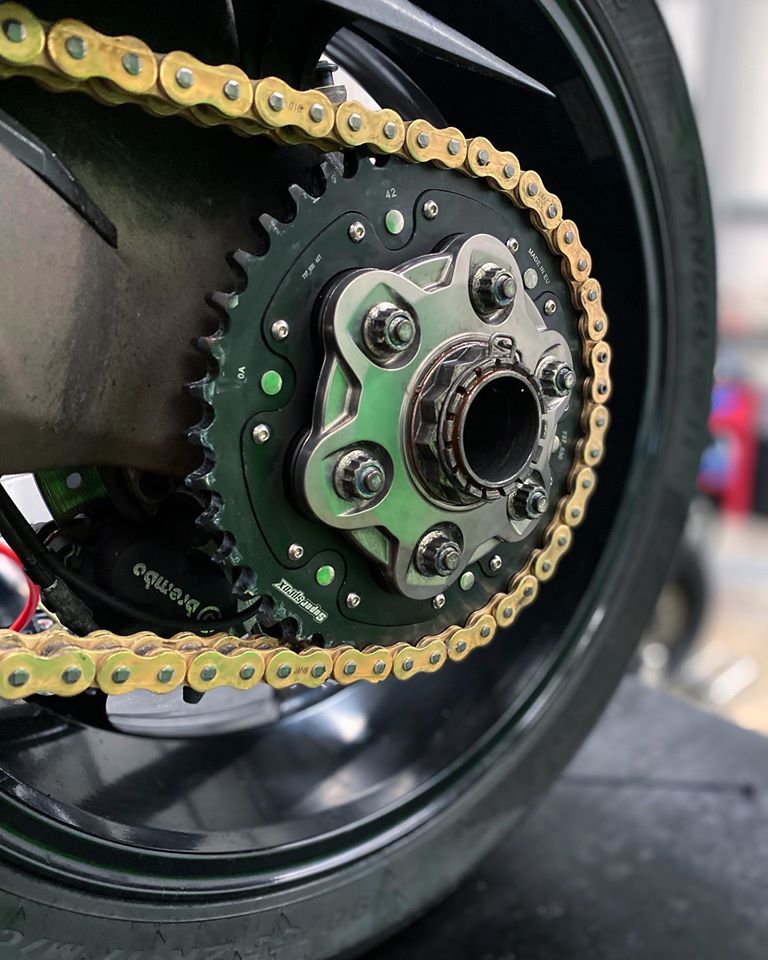

    What brand is your sprocket carrier?
  9. The carrier is the std. one.
  10. Label says SuperSprox...
  11. I’ve got the supersprox sprocket, i just thought the carrier looked like an aftermarket NCR one. :upyeah:
  12. Supersprox is the sprocket.
  13. If you already had a carrier, there was no need to remove the large nut.
  14. Are you sure? Looks like an aftermarket quick release one to me :thinkingface:.
  15. @Broduc64 Mate you have an after market sprocket carrier, the item you may think is the carrier is actually the sprocket flange.
    edit: TBH I would seriously reconsider letting this *cough* mechanic anywhere near your mutley!
  16. Ok guys, I take your word for it, must've been previous owner.
    Not looked at a stock one for comparison.
    So, are you saying I could've undone the six bolts holding the carrier and sprocket and removed it over the large nut ?!?
