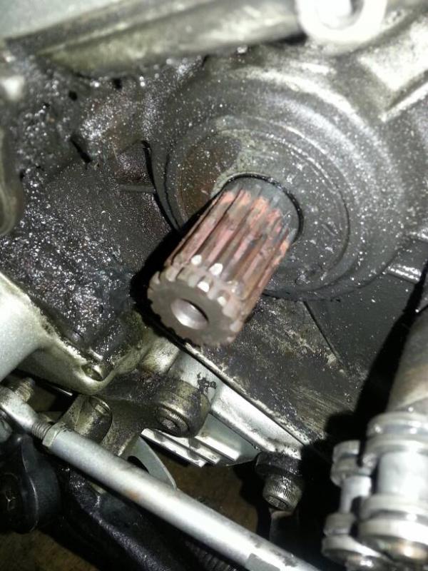

  1. Just got back from a run out and decided to checkout chain tension.... Something did not 'feel' quite right - found that the sprocket retainer had been pulled onto drive shaft. I'm now concerned that the shaft is damaged and will need replacing - advice please. uploadfromtaptalk1362243830946.jpg uploadfromtaptalk1362243859063.jpg
  2. The shaft looks ok to me get some new locking washers and a new front sprocket and you should be tickaty boo!

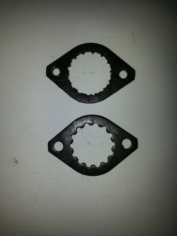

  3. Two retainers in picky - bottom one is new top f****d. I'll put the new one on and take it easy for a few miles - then remove and inspect to see if it is OK. What worries me is why this has happened and how bad it would be if the sprocket had come off rather than go further onto the shaft.

  8. I had one very similar.......no permanent damage, but I don't really like the small amount of movement of the sprocket on the shaft even with a new retainer.........I guess it keeps the chain in line a bit, but I think it is a wanky way of keeping a sprocket on a shaft.
    I inspect my retainer about every 500 - 1000 miles and always keep a spare.
    AL
  9. Sound advice - I'll certainly be doing this in future - I'd hate to have one go badly wrong at speed!!
  10. It's still a sh*tty way of holding a sprocket on a shaft.......I reckon SteveB (duc904red) should start knocking a few out in a better material.
  11. I'll take a couple or three in Titanium!
  12. I'd be interested in a couple of titanium items
  13. Isn't it a sacrificial part ? If you use a good (hard) metal won't it wear the shaft instead ?
  14. I think you may be right about that..............Maybe good quality stainless would be better...........or certainly something better than the pressed slice of cheese.....
    AL

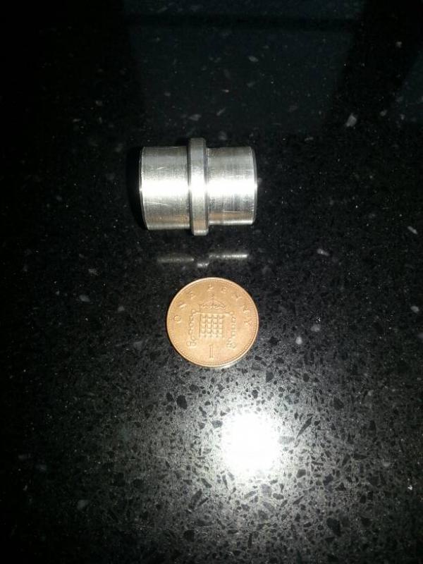

    My only issue now, is to make certain the wheel is correctly aligned (it's an ST4s BTW) and the chain tension right! The markings on the swinging arm are crummy at best - so I've just knocked up a bush that is a nice fit in the spindle and makes measuring distance from swinging arm centre and wheel spindled centre easy. uploadfromtaptalk1362328799396.jpg
    Now if only I can find details that tape measure....
    Bush is double ended with different diameter each end.

  17. Regardless of how wanky I think the method of holding the sprocket is; the retainer is worn by one thing only……Movement.
    I don’t know about your bikes, but when I fit a genuine new retainer plate, it is actually a bit loose in the shaft groove……by loose, I mean that the plate is too thin for the groove.
    If this intentional by Ducati for chain alignment or something, I haven’t got a clue, but as the sprocket and shaft are similarly hard steel, the shaft itself doesn’t appear to wear, just the retainer plate.
    When I fit a new plate and the sprocket, and get it all bolted up, the sprocket is decidedly wobbly, caused by the loose retainer teeth in the groove; consequently there is the potential for a lot of movement.
    Therefore, if a tighter fitting retainer plate was used, it couldn’t rock so much in the groove, therefore reducing the movement…..
    It’s my theory only, but I have a new plate here so I can always measure it and the shaft when I get five minutes and produce a decent accurate Cad drawing.
    AL
