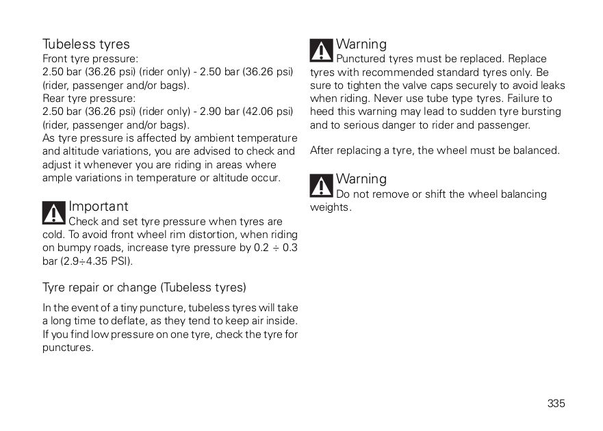

  1. 42 psi is the rear tire pressure for rider / passenger and bags.
    36 psi is the rear tire's recommended pressure for rider only.
    The front is always 36 psi regardless.
    Owner's Manual snippet attached.
    Screenshot from 2020-09-22 18:07:51.png
