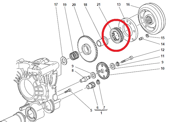

  2. Sprag clutch slipping maybe. How many miles on it?
  3. 27000 km. Sprag clutch ?

  5. AS 900streetfighter
    said it must be sprag clutch. Number 21 on drawing.
