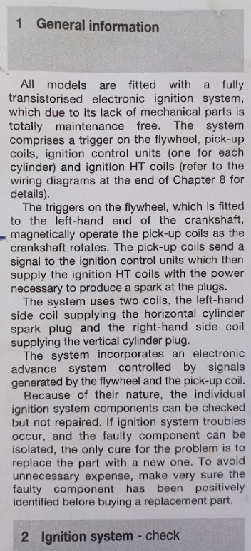

    I've started with the easy one - HT leads
    As per the following, the left hand coil (as you look towards the front of the bike) is connected the the horizontal cylinder. So unless there is a misunderstanding here, the HT leads are connected in the correct manner.
  11. The HT lead may be connected correctly but what about the coil trigger wires?
  12. Yep, that’s a good one too.
  13. And double check the polarity, if the contacts have been swapped during work.
