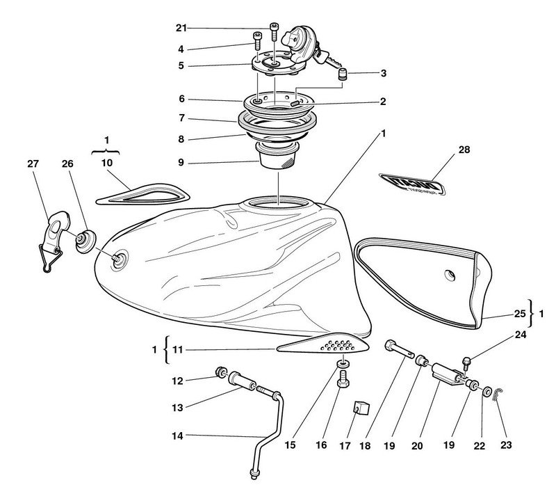

  3. left hand side rear there is a drain screw/bolt
    all comes off quite easy
    number 16 on diagram

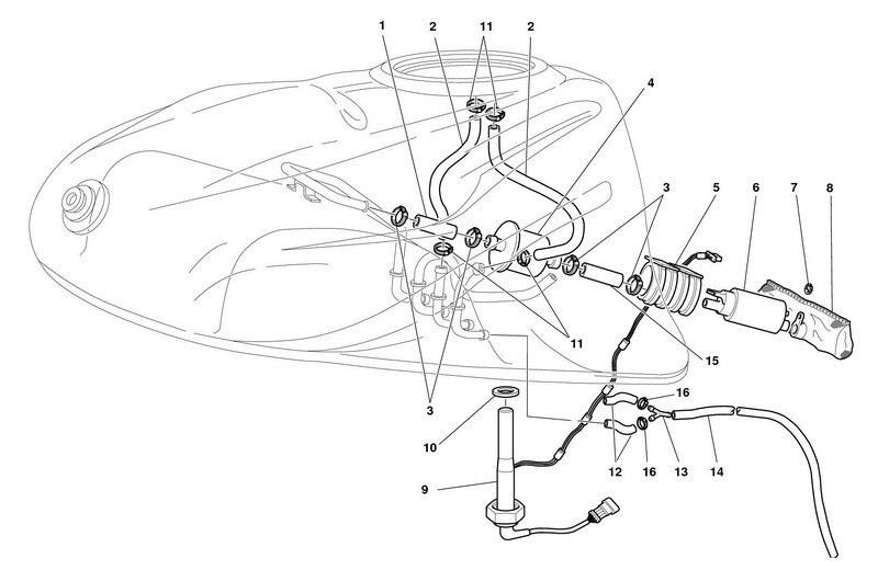

    The 1000SSie(and 800) tank is unfortunately different to the 750/900 in that it does not have the drain plug.
    As mentioned, internally the return pipe appears to be very low in the tank and I'm worried it will be below the level of the fuel when I pull the pipe off the stub.
    See below.

  7. It will not flow out to empty but on initial removal and if you subsequently move it around the workshop without tipping it on its nose it can release a fair amount of fuel. Why not use a short piece of fuel pipe between feed and return to close the loop?

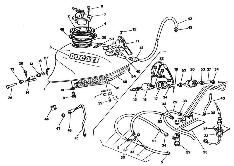

    900SS/SL parts diagram for comparison.
    Nasher

  9. Friday afternoon swapping tanks about went well.
    I can confirm that as I suspected pulling the return pipe off the stub results in the tank trying to empty itself, but an old T shirt underneath, a good impression of a little Dutch boy, and a spare piece of fuel pipe to loop between the outlet and fuel return stubs(As suggested by John Wright) had it sorted.
