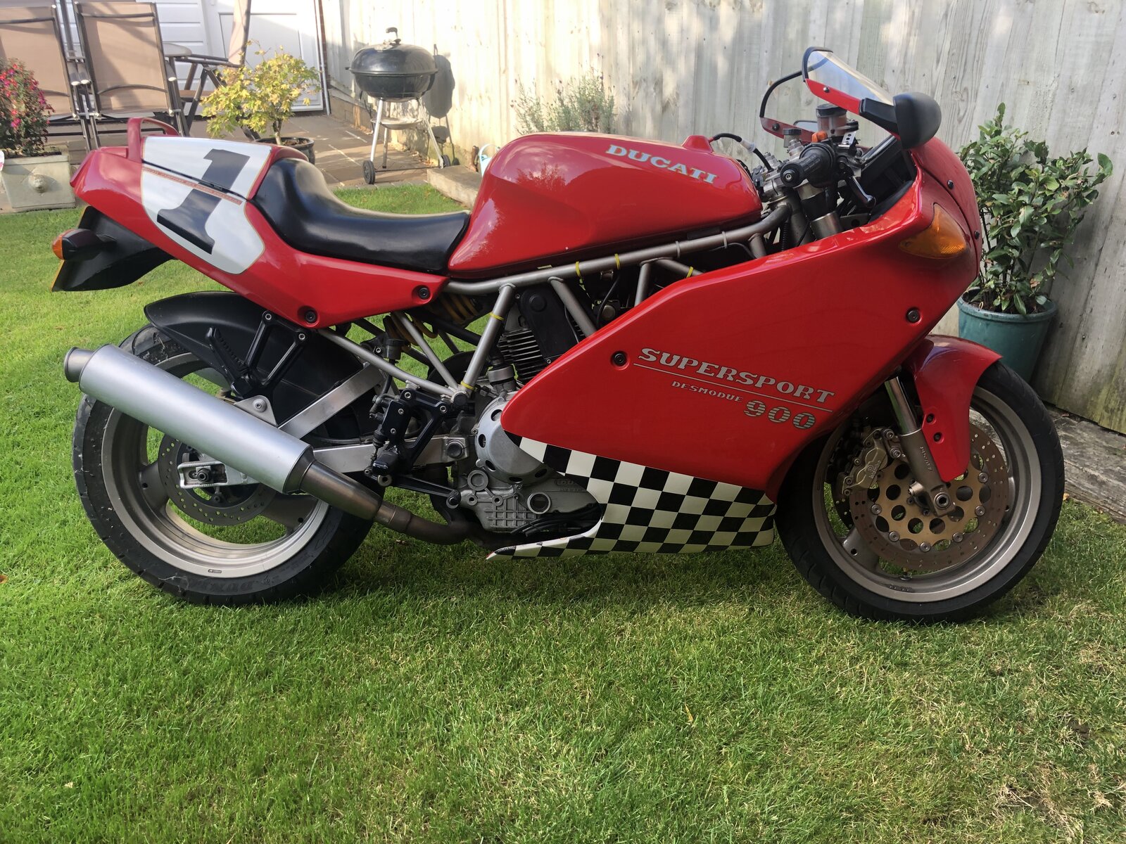

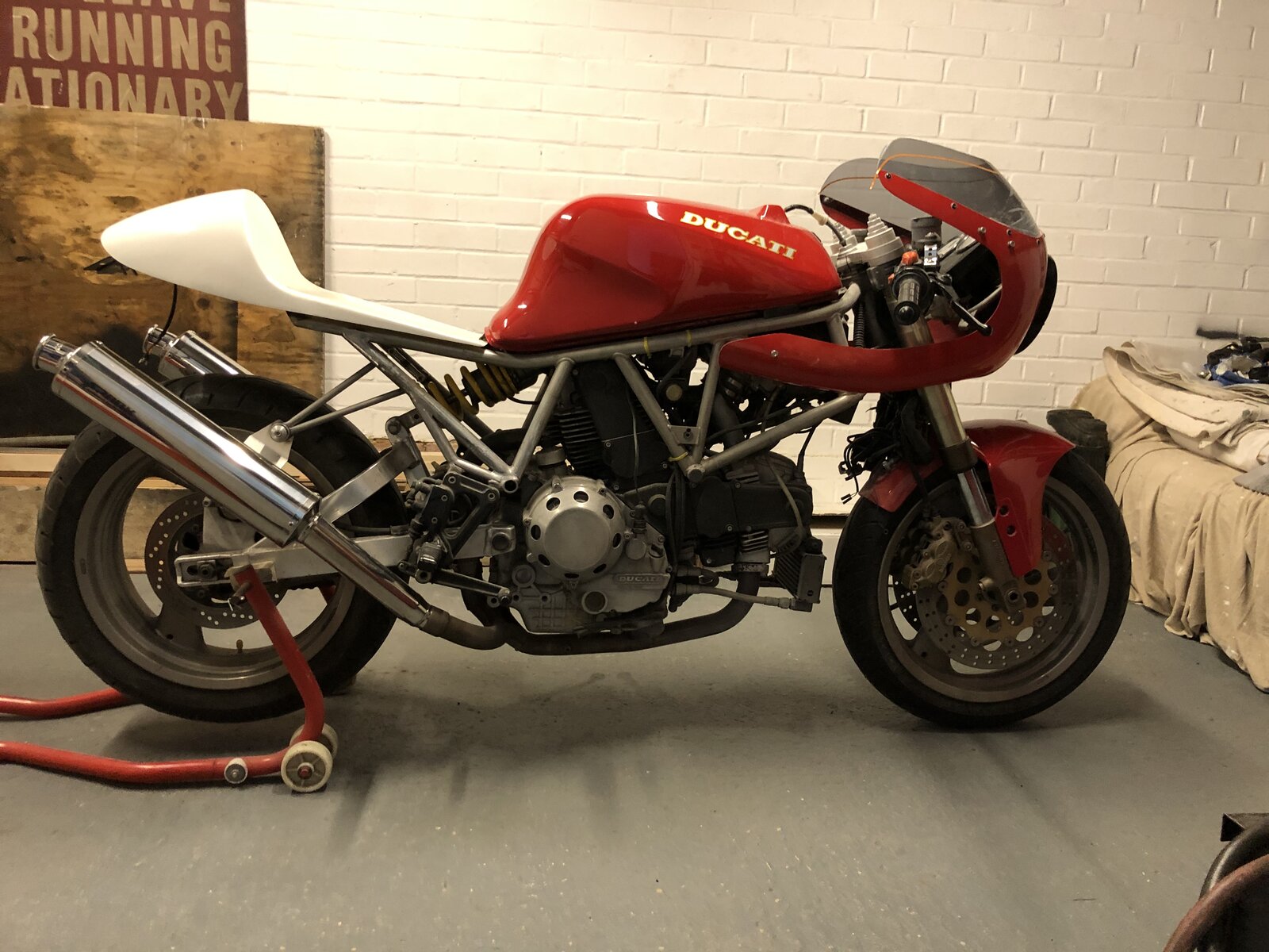

  12. I recently had exactly the same dilemma as you. I was intent on building a cafe racer and set about looking for a suitable donor bike. I eventually found a 900ss that hadn’t been on the road since 08 for £1500. I bought it home then wrestled with my conscience for about a month until I eventually took the angle grinder to it! My reasoning was that it was what I’d bought it for. Pictures are of as purchased and current state of build. Having done 95% of the fabrication work it’s just about ready to strip down, paint and detail.
  13. You animal :eek::D looking good, just kidding about the animal bit :upyeah:

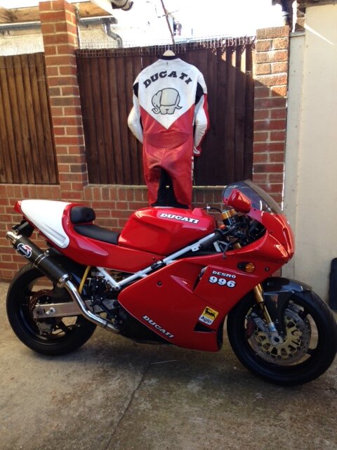

  14. I bought that bike from Rushjob, and put the engine and wheels into my 851 frame..

  16. You should start a build thread on that, even if it’s well into the project. Plenty would be interested.
