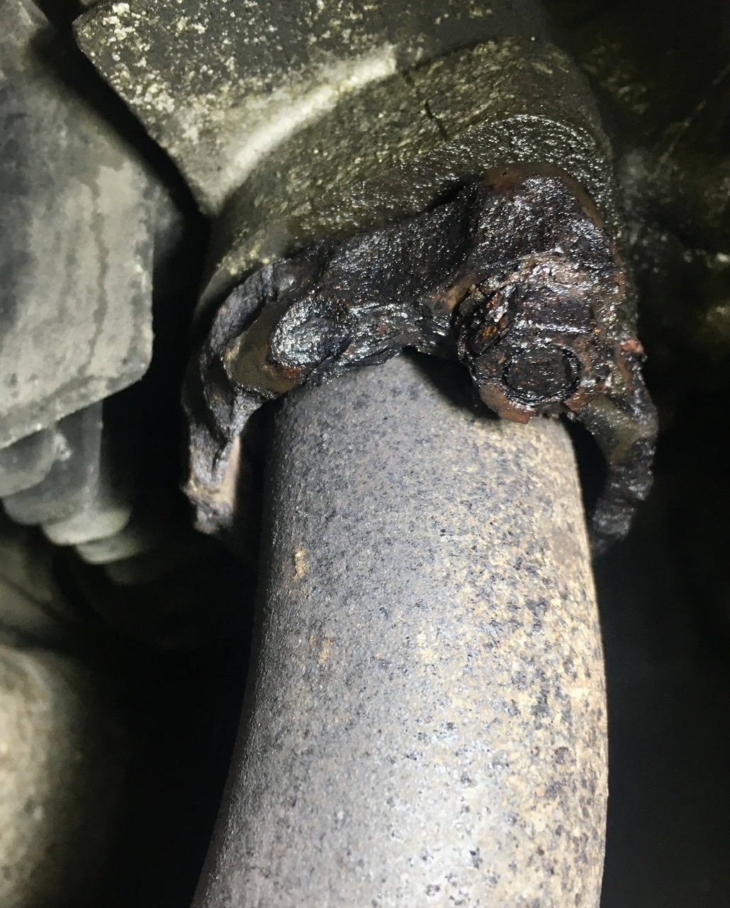

    However, not all good news:(, whilst underneath the bike attaching the new starter cables I think I’ve found my ‘sprocket’ problem for this bike. Have you ever seen an exhaust manifold as corroded as this :eek::(
    No, that’s not gunge on there, that’s corroded into that shape, it’s all hard:(, and yes, I have seen what looks like a crack in the photo, I didn’t notice it in the flesh but will be inspecting it more closely in the morning :(.

  9. that pic looks nasty dawg!!!

  13. Looks fine for being at sea for20 years ;) sure a bit of dettol and a wire bush will have that looking lovely :thinkingface:
  14. I know, that's some serious corrosion on that flange :(
  15. You will probably have to wreck the exhaust nuts and studs to get the flanges off. Try using a Dremel with a cut-off disc to cut down through one side of the nut, as close as possible to the threads. You should then find that a blow with a hammer and chisel will loosen the nut and get it off and hopefully leave the studs more or less intact. Access might be a problem for the nut at the back though.

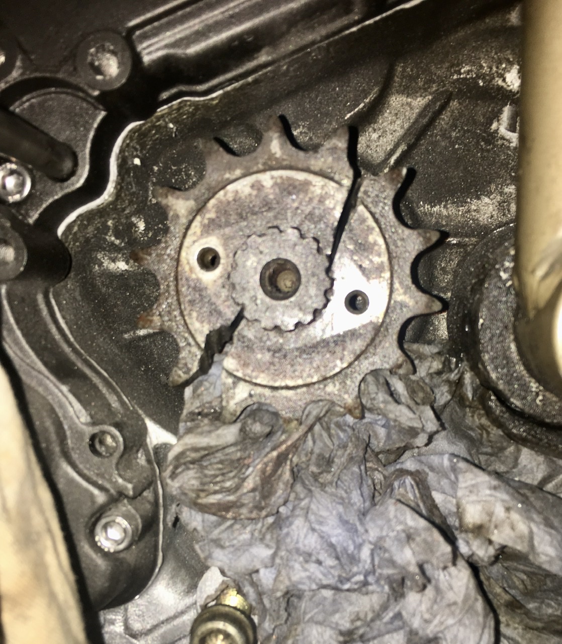

  16. Thanks Derek:upyeah: However, don’t forget you are talking to the man who had to use an angle grinder and then a Dremel cutting disk (disks actually, about 6:mad:) to cut through a front sprocket which with subsequent judicious use of a hammer and chisel still refused to detach itself from the output shaft:(.
