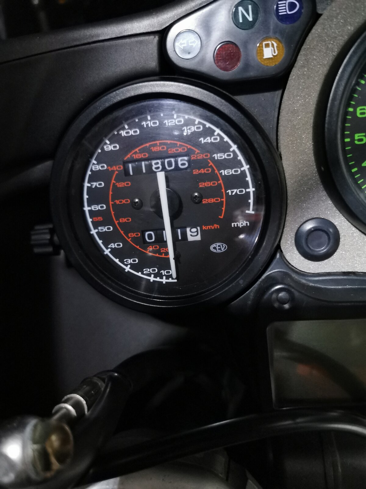

  10. For info 2002 ST4 UK speedo;

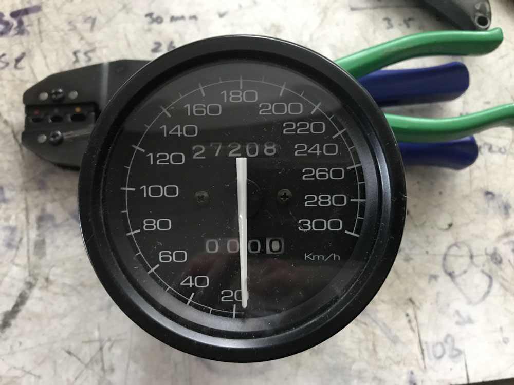

  11. 916 speedo reads upto (an optimistic) 300kmh;
  12. 186 mph. Not much different from the ST4 one.
  13. Your ST4 reads up to 300 KMPH too.
    Edit. Stupid boy. No it doesn’t!!
  14. Mine is marked up to 300 kph (post 10) but I'm not quite sure that is actually required...... :D
    Ducati claim 150 mph in standard form (for ST4) but I can't confirm that as I am a Jessie :bucktooth:
  15. I am having a bad day. I’m going back to bed for a lie down. Yours was the picture I was referring to in initial post. Then the worm of doubt hit and I incorrectly edited my correct post.
