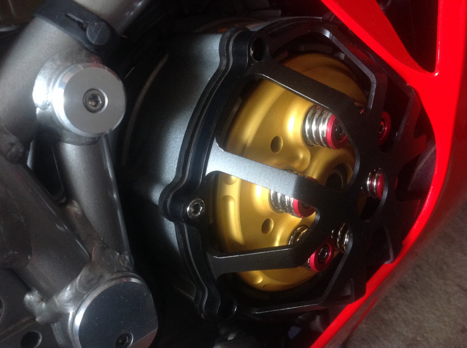

    Here's a pic of the clutch installed with Chinese cnc cover, Ducati Performance pressure plate, Avanti stainless springs, bolts and anodised caps.
    Inside are Suzuki GS650 pattern friction plates, which have been cooked at 200c with lithium grease until the smoke stops (the lithium grease mod).
    There is also an additional friction plate beneath the first, bottom plain plate (the quiet clutch mod)
    I discovered that the existing friction plates were already aluminium but must be sintered with ferrous material as the magnet I was using would just about pull them out.
