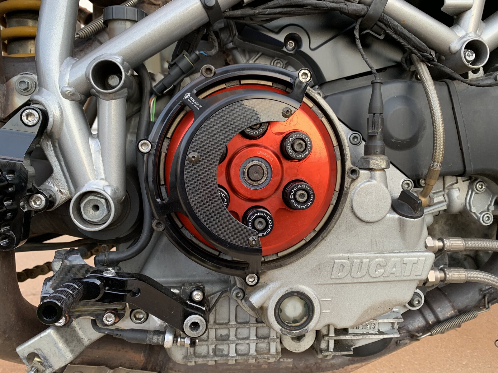

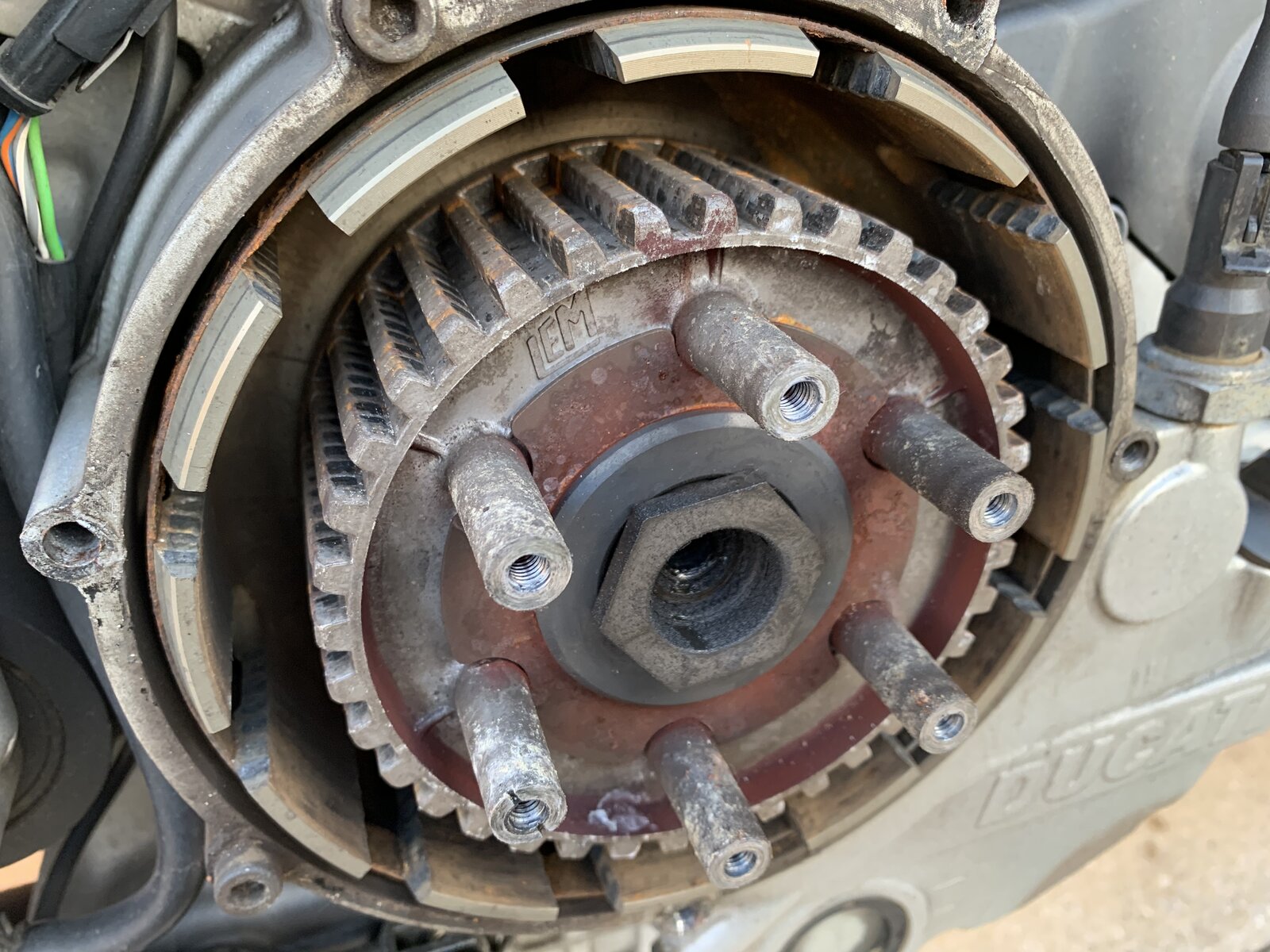

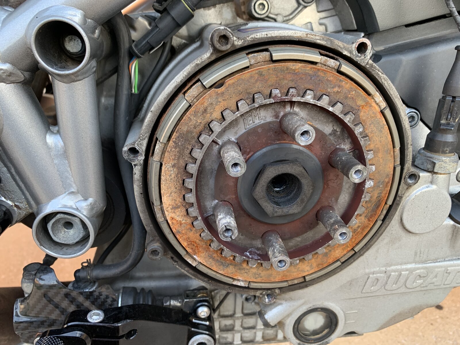

  10. I swapped out the plates and pressure plate from my other project(still quite worn) and fitted new springs and caps. The clutch felt better but still cutting out when closing the clutch fully.
    F5FA753A-72A3-45DF-8FDA-F72E51A08237.jpeg C3ECDB9E-A6A6-499C-A91B-A236A688DFCF.jpeg
    the basket looks worn aswell, I think maybe new plates and basket?
    I then fitted my oberon slave cylinder from the other project, fresh fluid and bled.
    Better feel but still cutting out when the clutch is fully closed, but the window of me pulling in the clutch slightly and holding opened so its made the bike semi rideable, as long as I catch the right point on the lever it doesn’t stall.
  11. the suggestion re: rubber gasket is not relevant after looking at your pics, Was bearing free/ok in pressure plate?
  12. Yeah, but a lot less play when I fitted the bits from my other bike.
