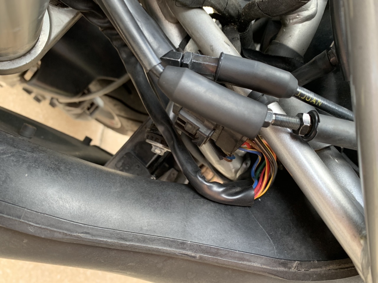

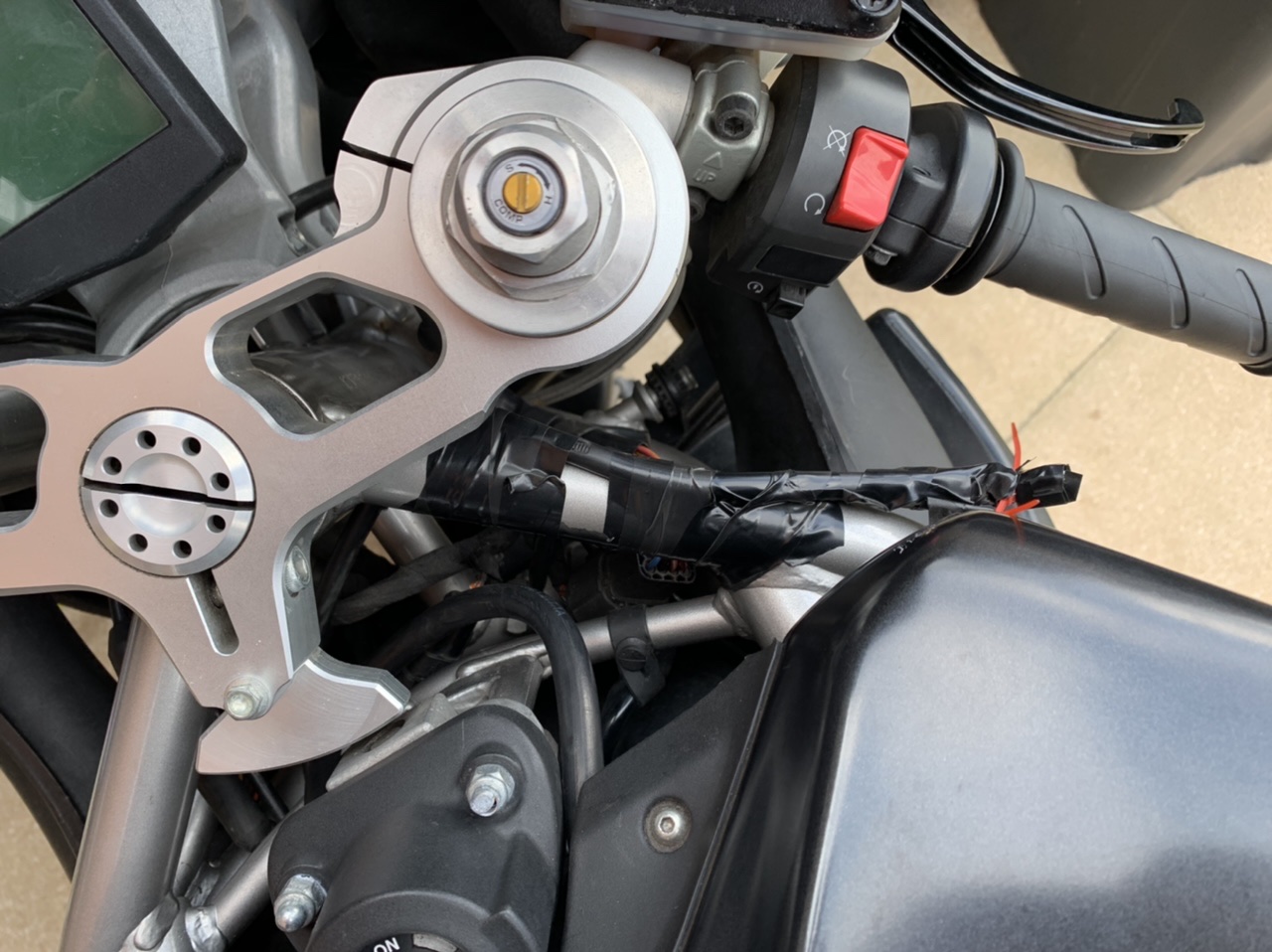

  3. So first test ride, I re secured the fast idle in a way that the idle stays at 2k, still cut out when the clutch was closed. I noticed that moving the throttle past the closed would start to drop the revs slightly, I fully screwed in the close cable adjustment and fully unscrewed the open throttle cable adjustment, I also should note I fully closed the air bleed screws on the throttle bodies aswell. The bike ran well on the second ride, it stalled twice on the ride but I had about 20 stops, I can get it to stay alive all the time provided I apply a little throttle when closing the clutch. @Cream_Revenge looks like the cables were a major factor.
    Fast idle temp bodge:pensive: 66857A3C-2C06-4E8A-9ECE-1CB78F77AB54.jpeg
