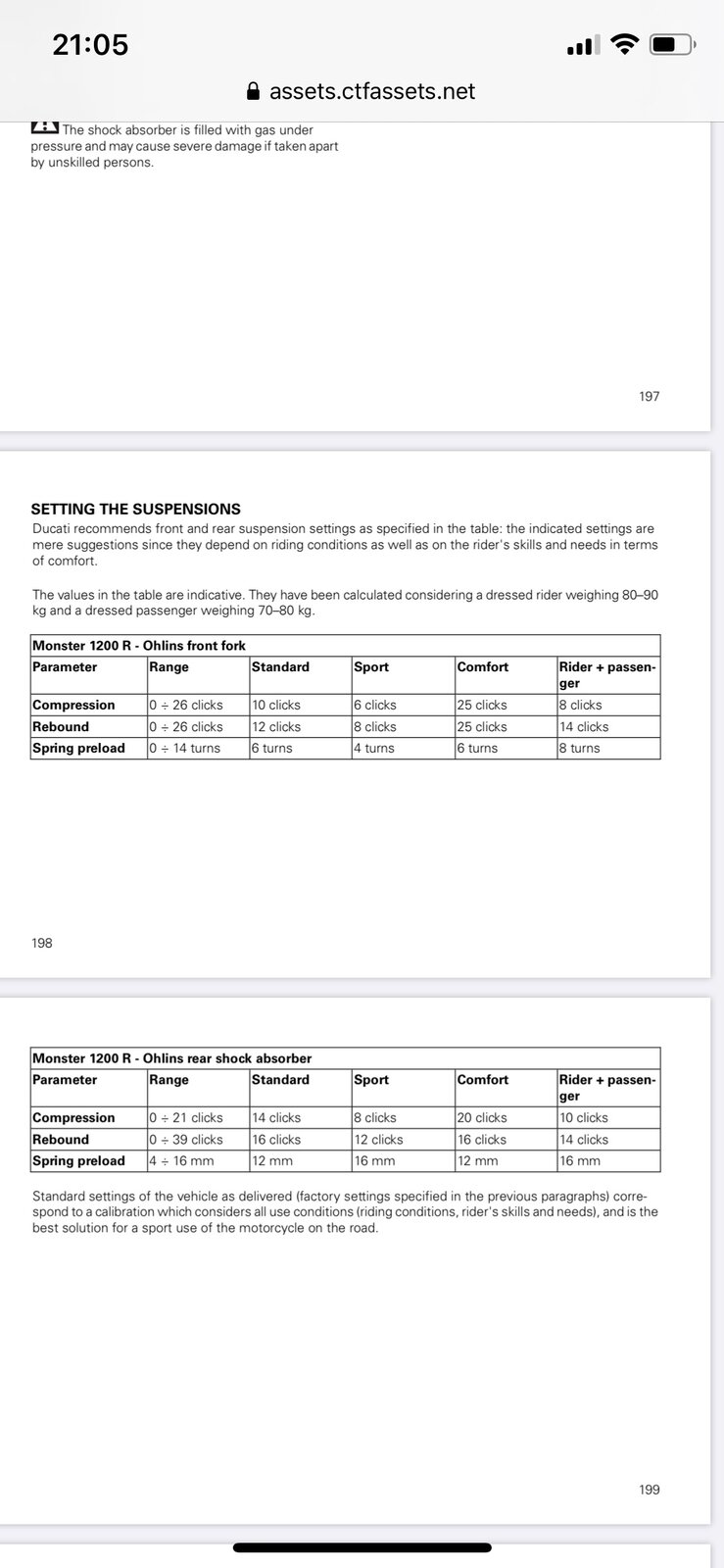

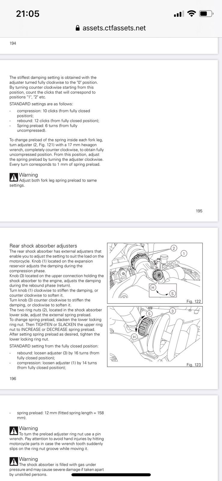

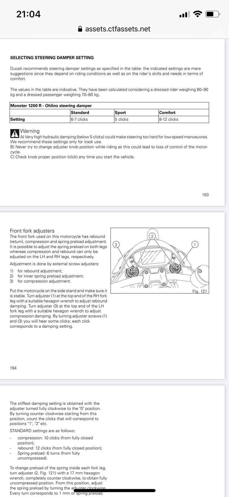

  3. I used the Ohlins app yesterday trying out my Motool Slacker and found it really easy to use.
    here's a copy of the relevant pages from the 1200R owners manual

  5. They’re screen shots from my owners manual
