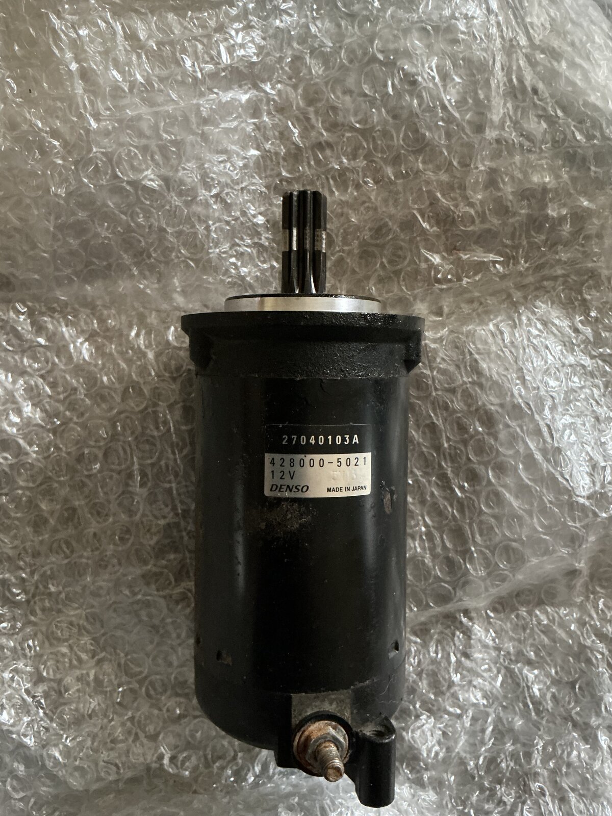

  8. Found it, p/n 27040103A and you are correct, fits pre DVT Multistradas according to your link. Apologies for getting it wrong …… again : unamused::joy: Andy
  9. Thanks Andy. Still possibly compatible as it's superseded by the listed for my PP (27040107A). However, it's four iterations prior to a current one. Also searching under that part number shows starters with a shorter, fatter pinion.
  10. Mmm :thinkingface:, no short, fat pinion on mine. Andy

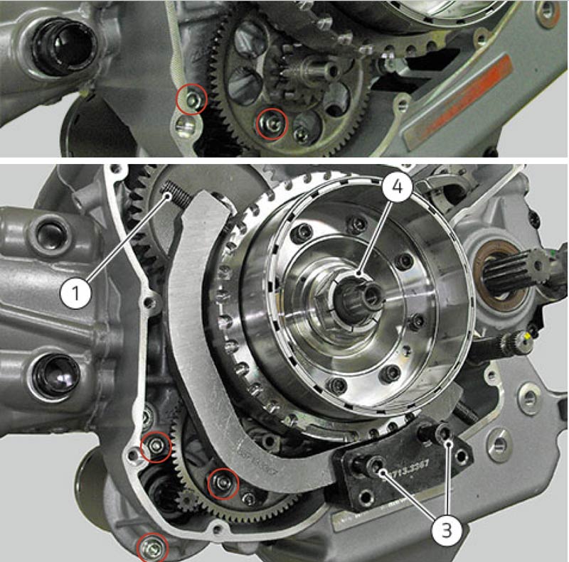

  18. Found a good as new looking starter motor on eBay and snapped that up. Have spoken to Tim at MotoVation Racing, my local Ducati indi spanner man, as was wondering if the flywheel has to come off. My 996 riding best mate seemed to think this was necessary. However, the manual seems to show suitable holes in the reduction gear to access the one of the three starter motor retaining bolts that it covers. Tim has confirmed that this is indeed the case, a relief as removing the flywheel could be a pig of a job requiring, ideally, an expensive locking tool as in this pic. Not to mention the nut needing to be done up to some monstrous torque.
    Have bought the equivalent of 3Bond (Elring Dirko HT) from GSF, as recommended by Tim, to seal the alternator cover on reassembly. Ordered new oil and need to check which coolant to use. Myself and my 996 riding mate will be using his workshop in a couple of weeks to get this job done.
    I've already fitted a new battery and ExactStart cables.
    TBH I'll be surprised if the replacement starter motor will make a huge difference, if any, to the enthusiasm of my bike to start. Both of my 1260 Multis have been pretty reluctant to turn over but will still fire up reasonably easily all the same. Though this should give me the peace of mind of not being stuck somewhere alone, without a hill, needing to bump-start it. If you haven't had to do this it's not an easy job...
