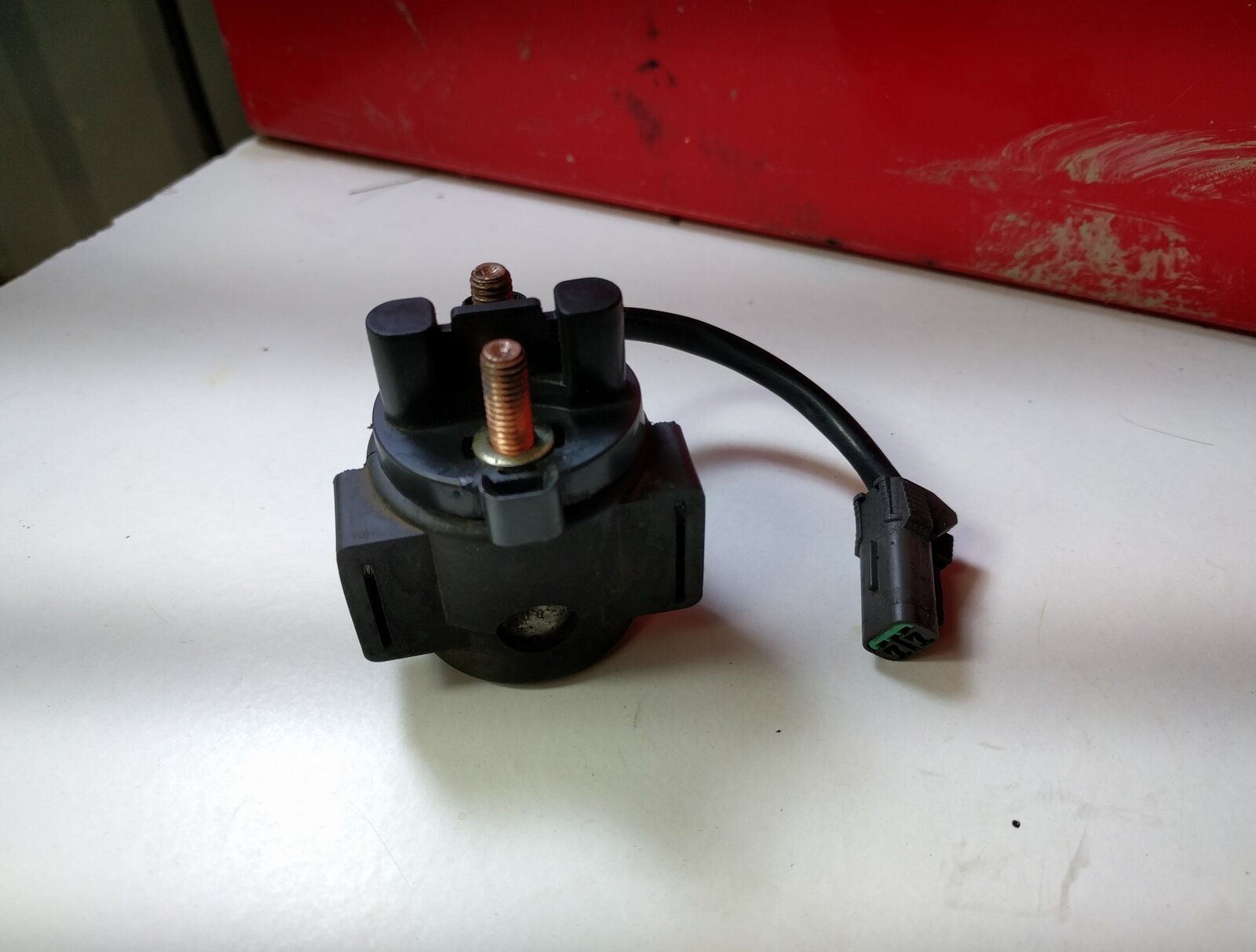

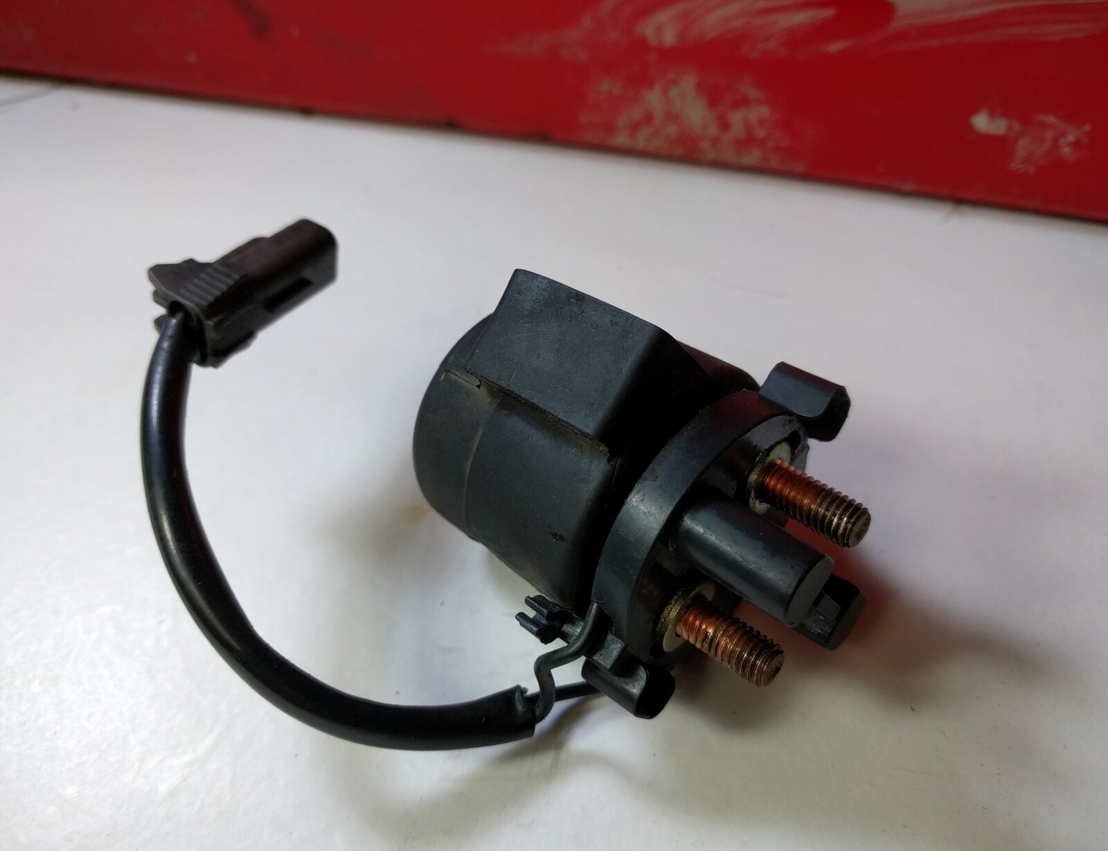

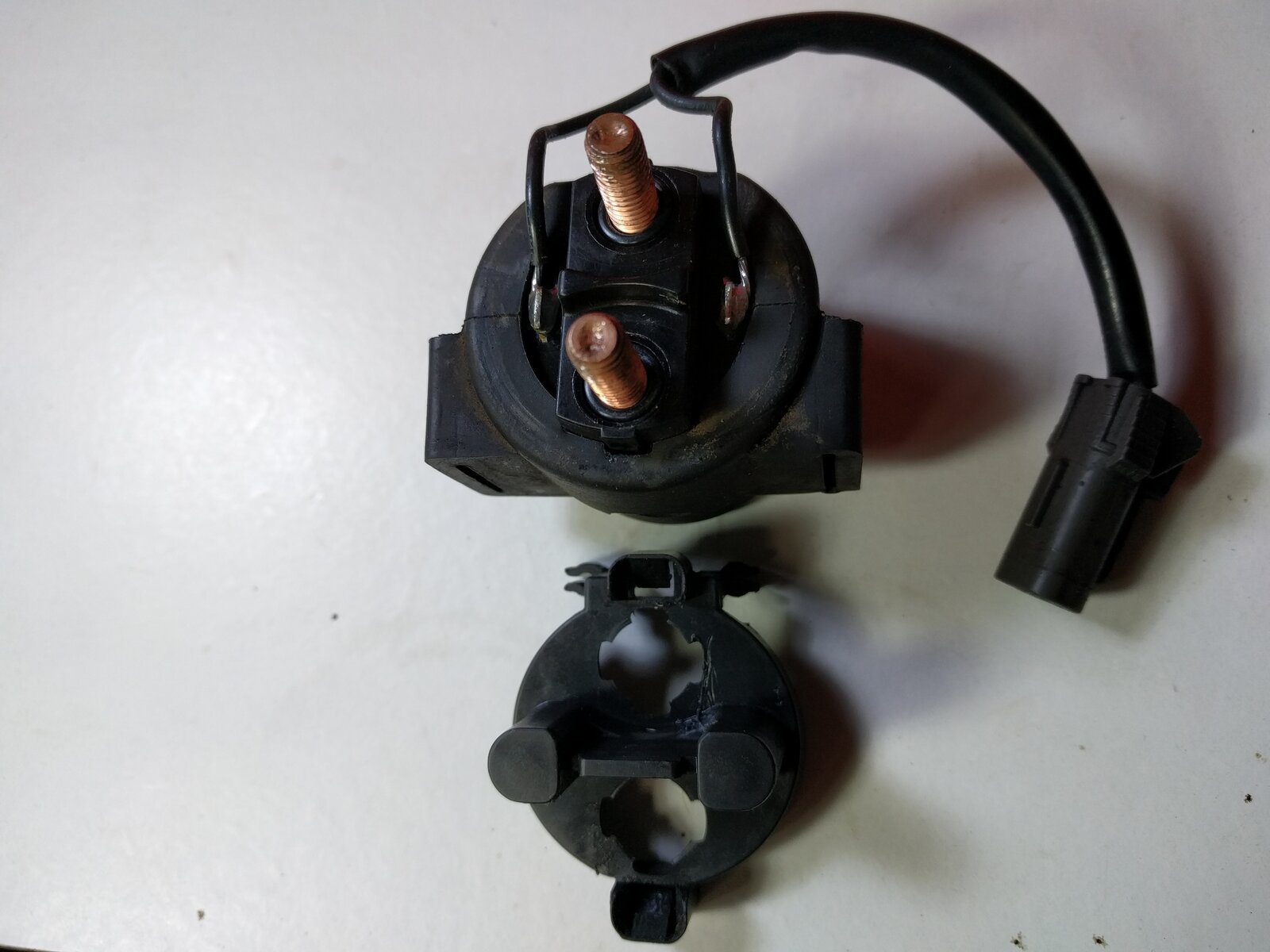

  4. Took it off this morning to make sure I got the correct replacement. Don't know if they all look like this, the rubber cover doesn't seem to come off so hoping a new (genuine) will come with one, and the actuator lead and plug. At least I can send a picture to Snells for confirmation. IMG_20190414_102902.jpg IMG_20190414_102550.jpg IMG_20190414_102425.jpg

  7. Already removed from bike, going to replace it anyway, then I'll find out if its the ecu!

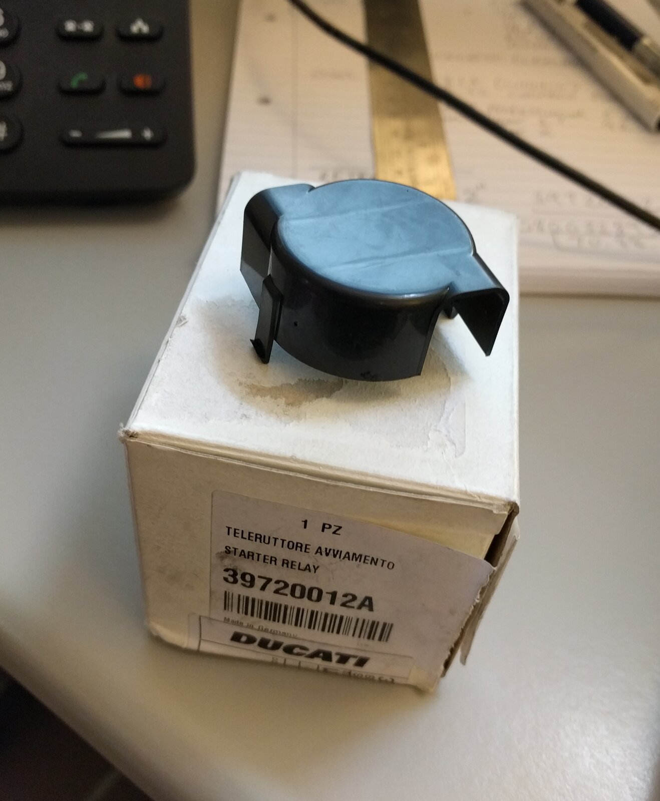

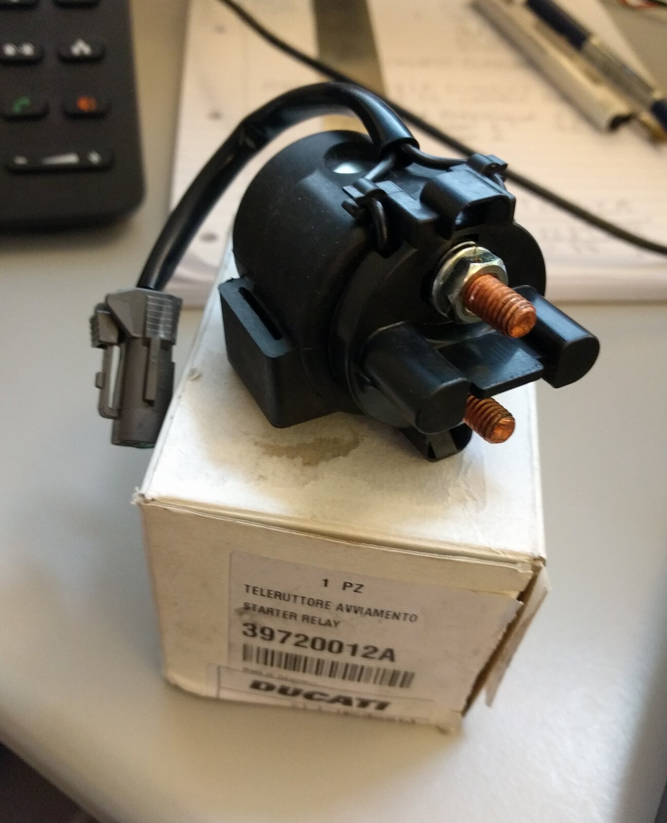

  16. New solenoid arrived this morning from Nick at Snells in Alton. The original part number has been superceded by an updated part, now 39720012A, and is apparently made by Denso, not Hitachi as before. Hope it's reliable!
  17. Comes with a new cover as well. A bit of a pain in the wallet at £73.28 Inc VAT, but at least I don't have to sod about changing connectors on a generic part. IMG_20190416_101257.jpg
