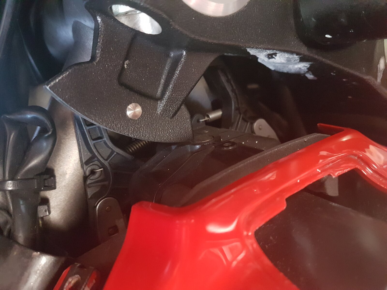

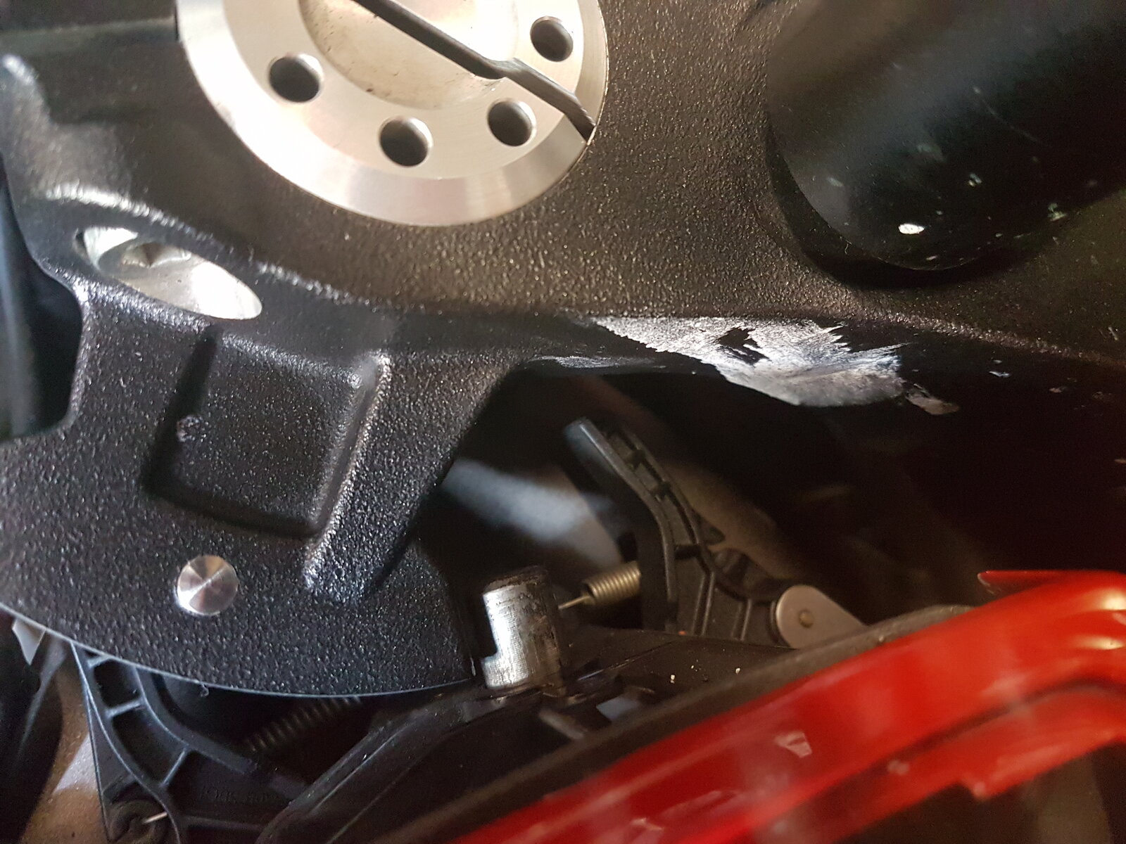

  8. Anyone got a zoomed in pic of where it’s meant to be oiled? I did all over the top earlier close to the tank.

  10. Top pic is full right, lock pin not energised.
    Bottom is pin energised.
