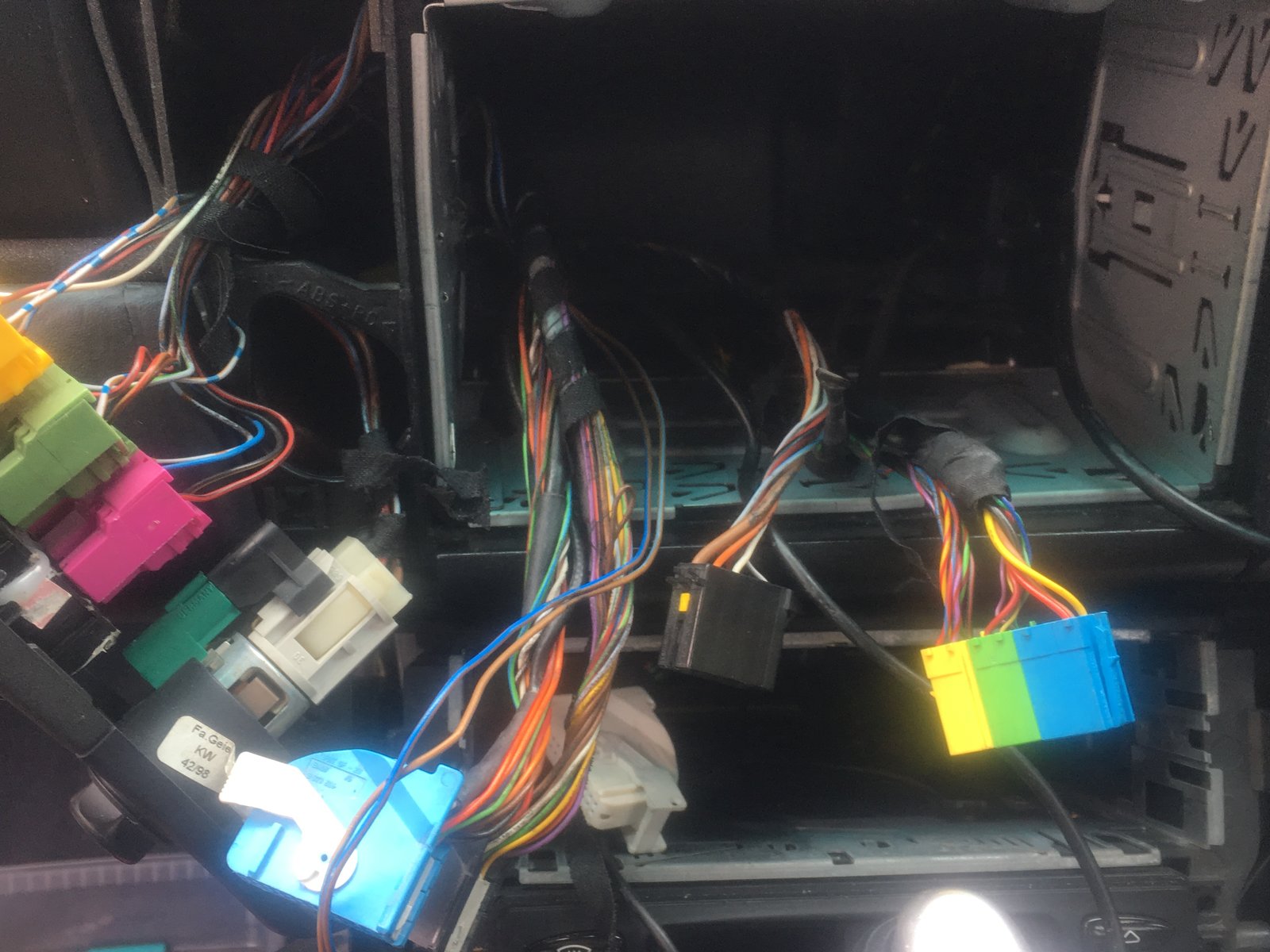

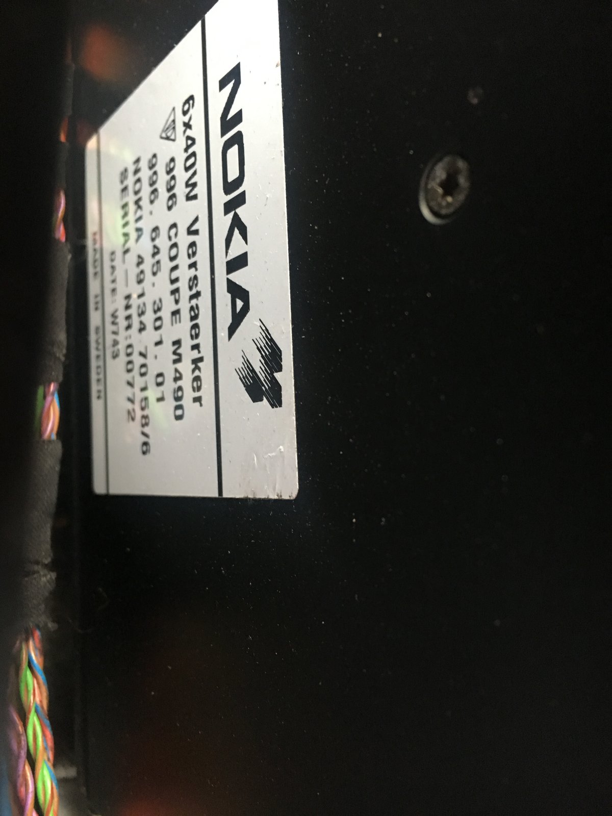

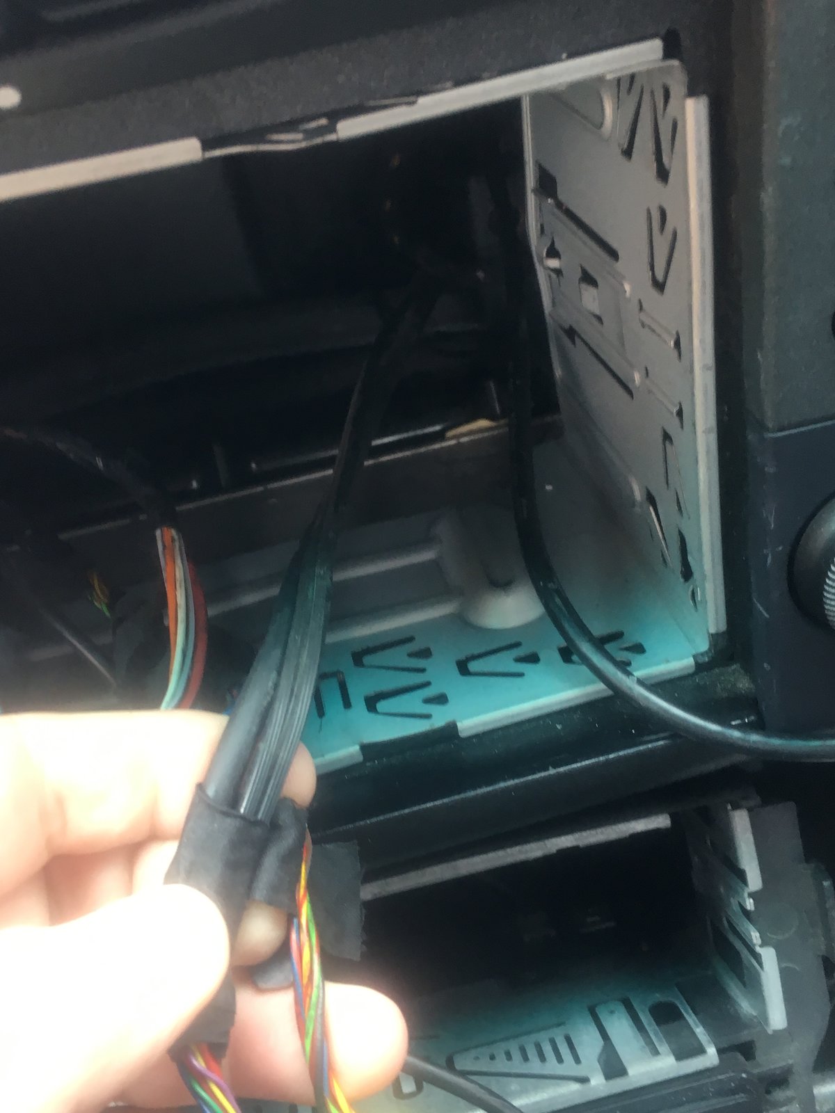

  19. Funny enough, what I though was a changer looks like its an amp.
    And these are all the wires available. Need to find a mobile technician I think!
  20. It doesn't beep, neither do.
    Think it may be a different unit was swapped when sold (another fucking small issue thats a big one on this car!!!!) and suspect the wiring hasn't been put back correctly.
