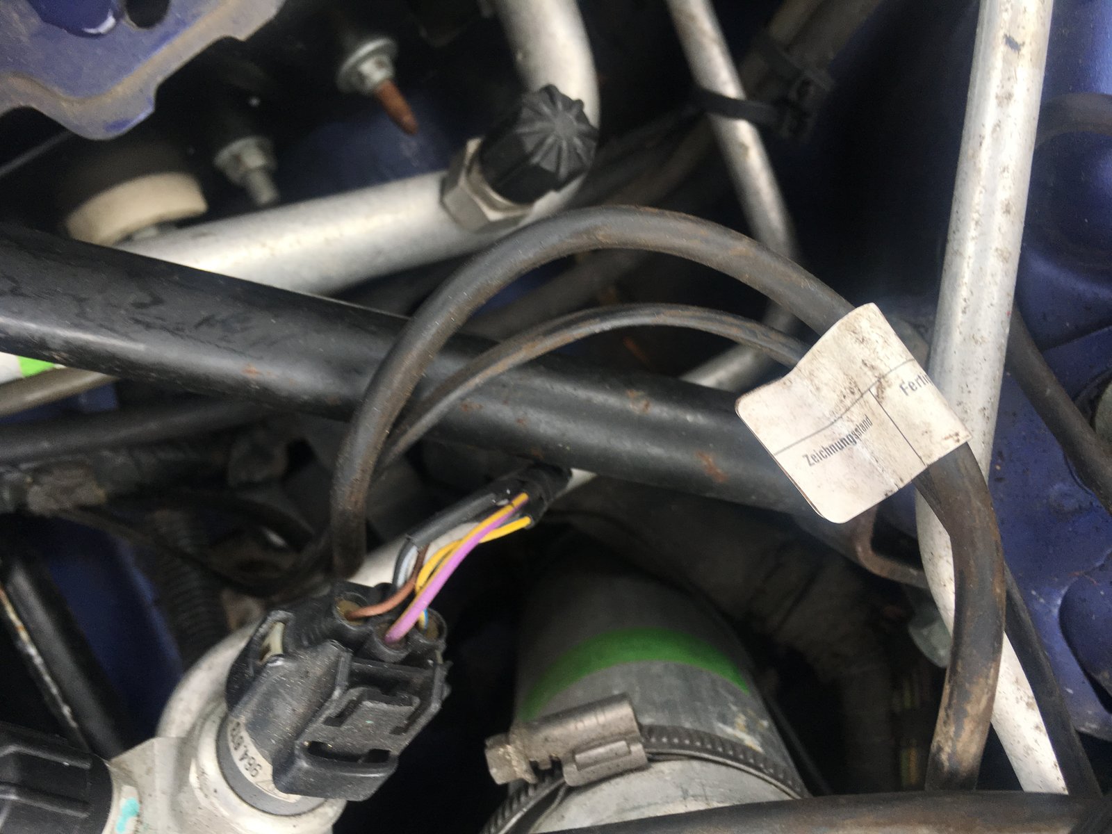

  1. The last picture, the two part wire, I think is this lot here...

    Does seem like it’s worth trying to trace the wires from at least one speaker all the way back if you can. Establish that line of connection although one suspects the bit you’ve found -the amp-may be the/a missing link.

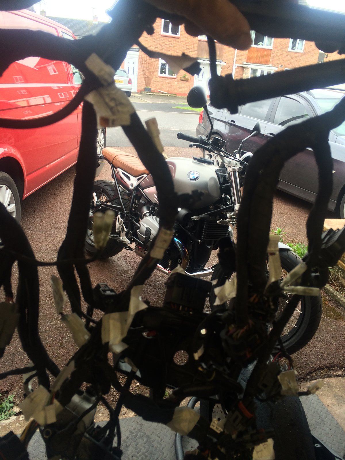

  3. image.jpeg Feel for you mate, I have a similar problem on my hands right now, where the feck do I start.
