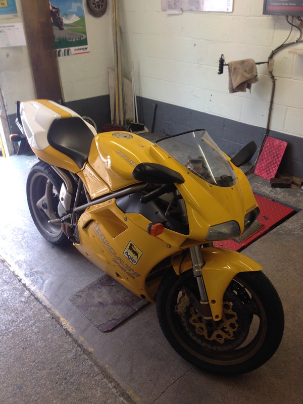

    I never set out to purchase an SP model but when this one came up locally and I could resist going to see it, now she was a little dusty/tired looking having sat for 3 years whilst the owner worked on various other projects but i could see the potential, the question was how much was it going to cost me to set it right on top of purchasing.

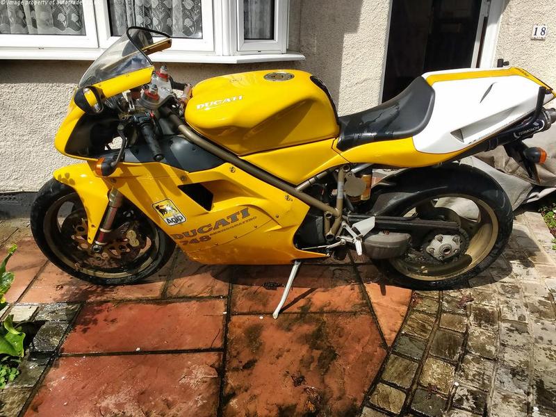

    (Picture from previous owner)
    What really appealed to me with this bike in particular is the fact that it had been owned by the same gentleman for 19 years and had covered a host of European road trips!

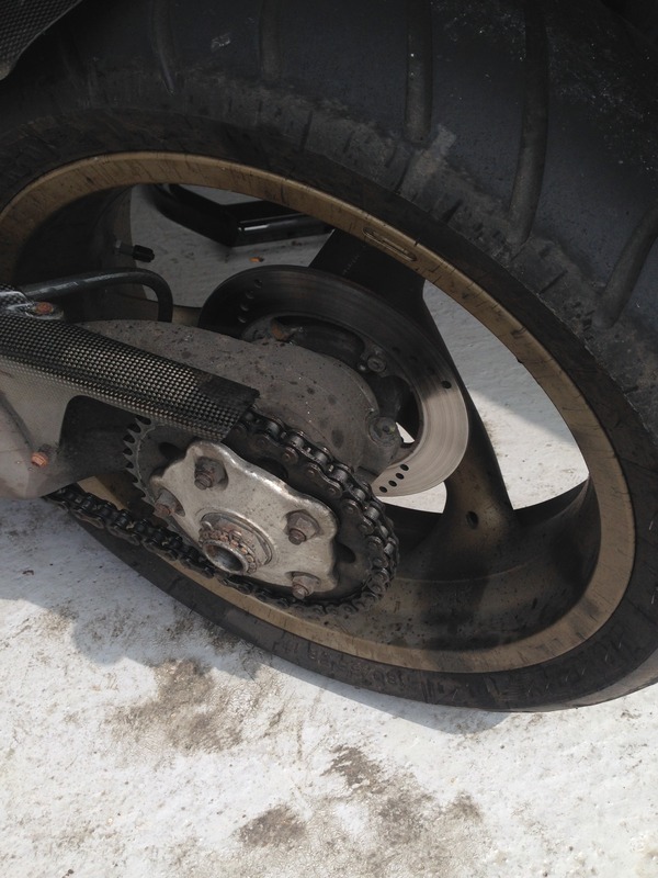

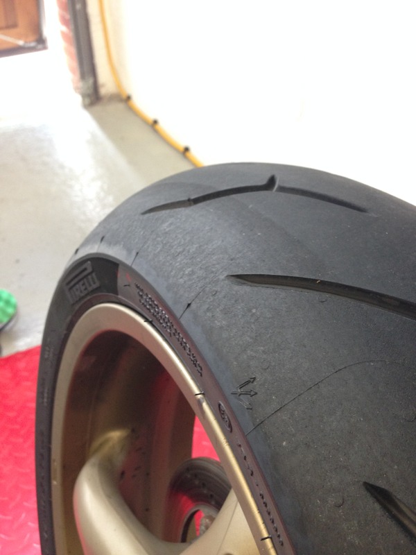

    I made the hero/high risk/ potentially stupid decision to ride it almost 90 miles having not moved in 3 years to the MOT center, the tyres made for a terrifying ride and had gone brittle and were heavily squared off, but the trusty old girl made it all the way there without missing a beat.
    Now it did fail the MOT (which i expected) butttt only on a front tyre being below the minimum tread depth other than that the MOT tester said everything else was spot on - Result

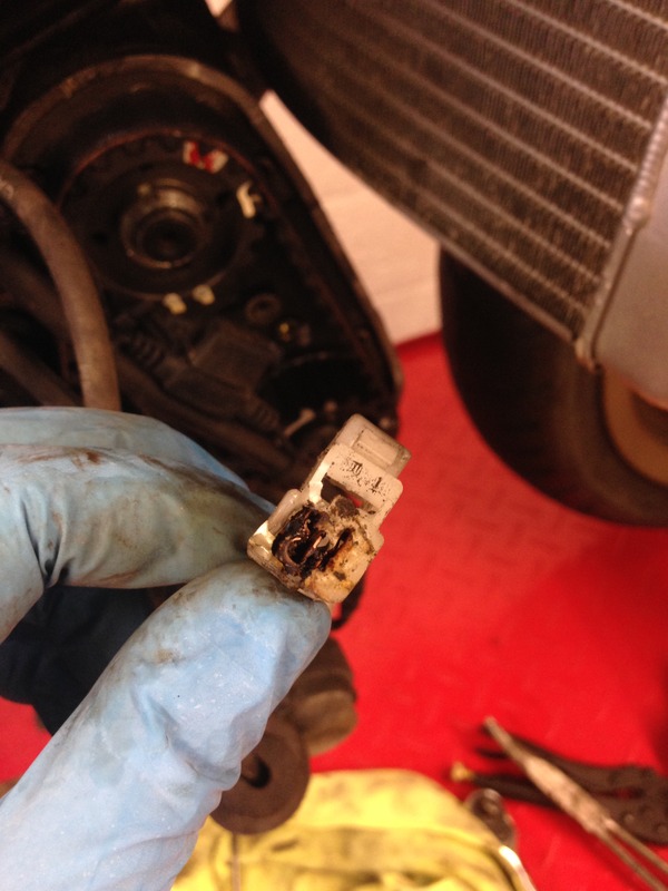

    It was now onto the maintenance, having read the horror stories of Italian electrics I went in with my eyes open expecting the worst. The loom did need some work and the cambelt was looking very aged (Lucky she held out for the 90 mile trip home)

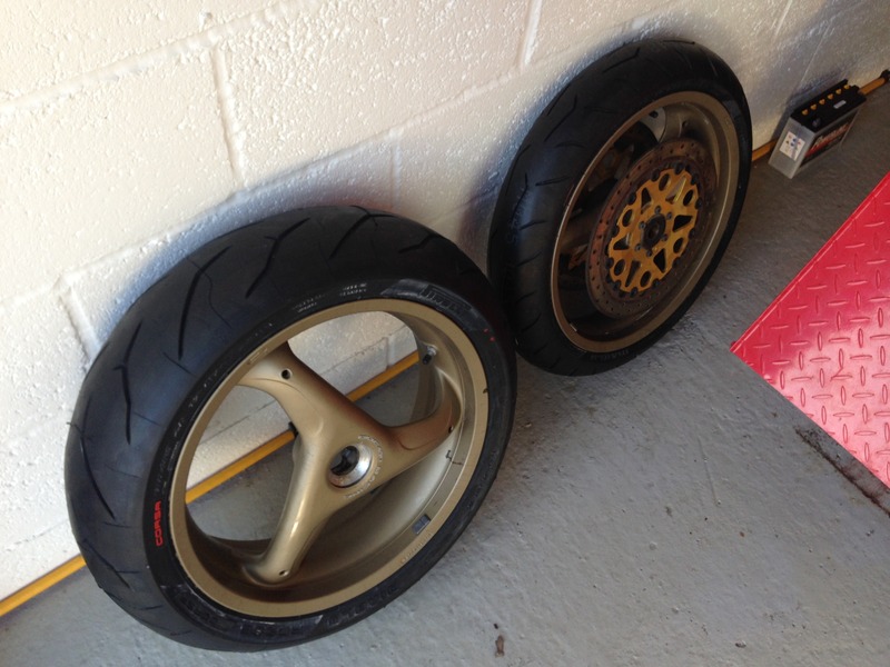

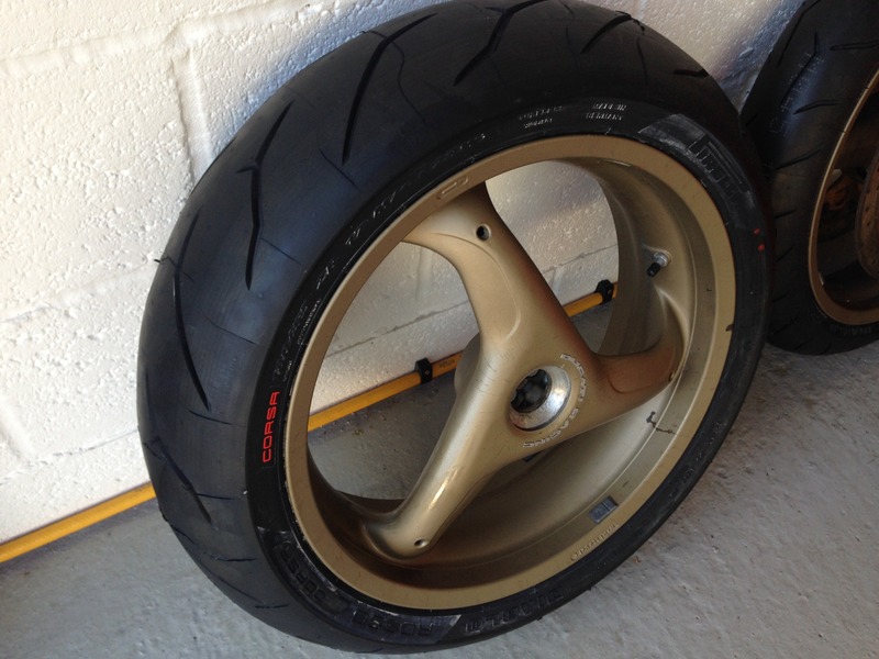

    First to arrive were the brand new tyres, for me spending the most you can is money well spent as at the end of the day there the only thing keeping you in contact with the tarmac!

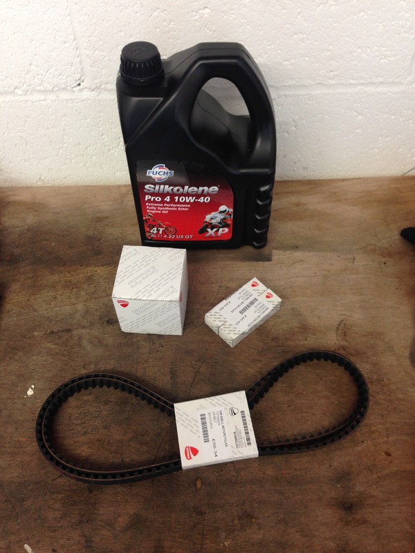

    Next up, Genuine Ducati cambelt, spark plugs, oil filter, sump washer & Fuchs fully synthetic engine oil.

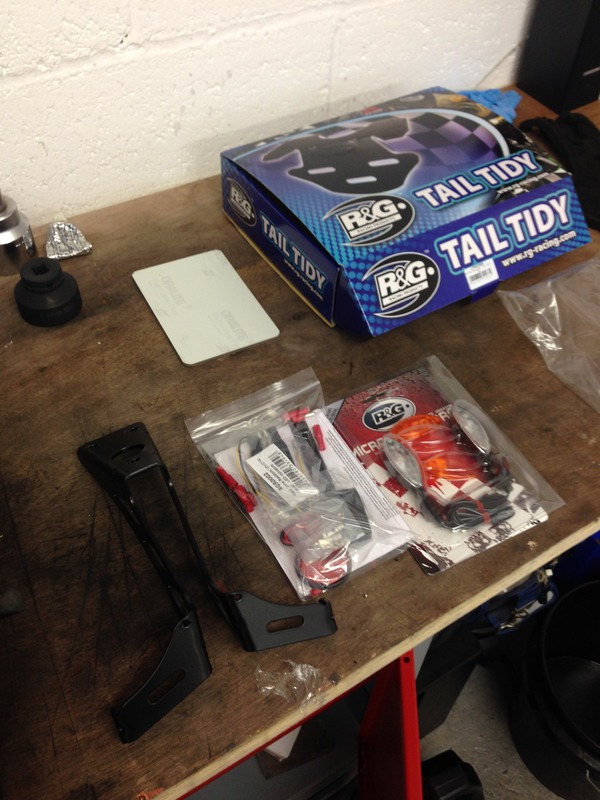

    R&G tail tidy with the orange lens cover to try and keep it all in theme with the age whilst clearing up the rear end.

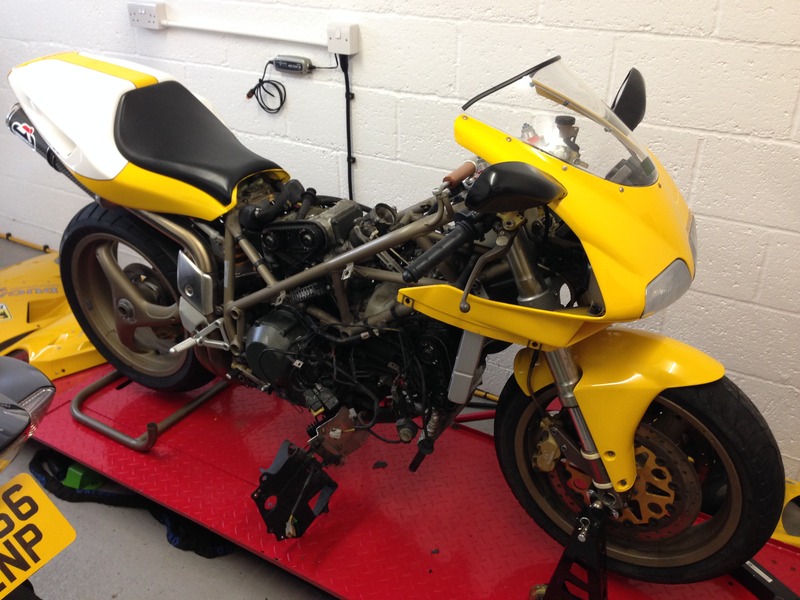

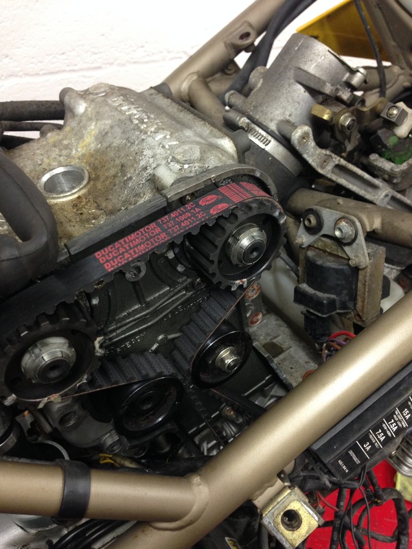

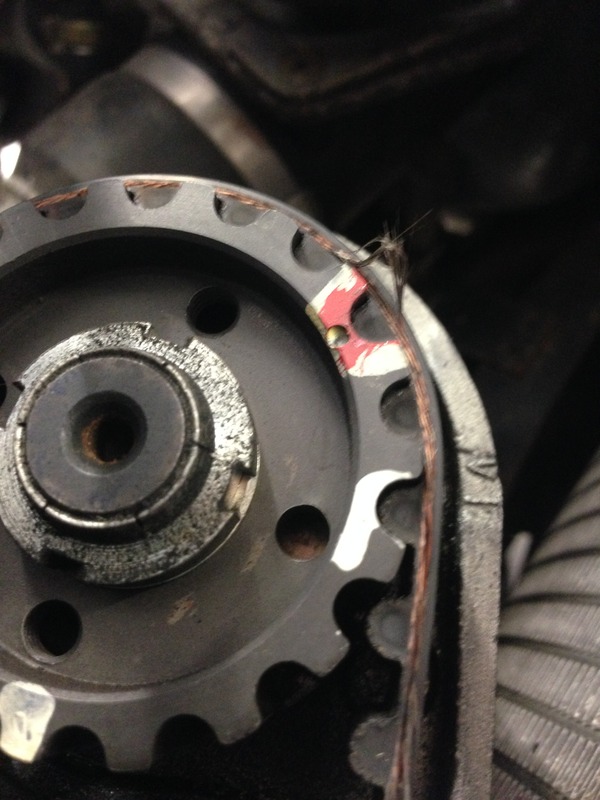

    Slowly going back together, spent an entire evening just tinkering in the garage, one happy boy (simple things in life hey!) I must say the cambelt replacement was so much easier than I expected, how garages charge what they do for this service is beyond me!

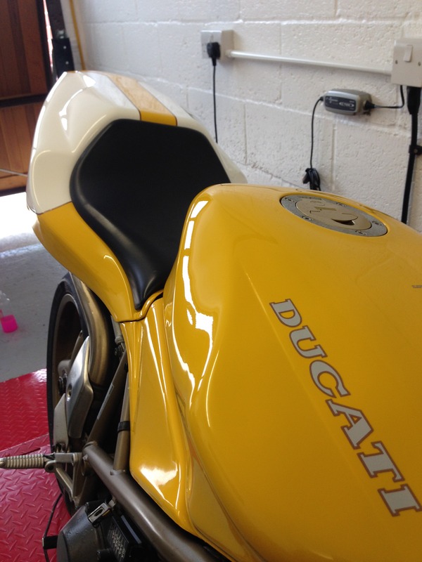

    The finished item, with hours of cleaning & maintenance complete it was looking and sounding spot on, having a throttle body balancer to hand allowed me to get the idle perfect and the throttle response razor sharp.

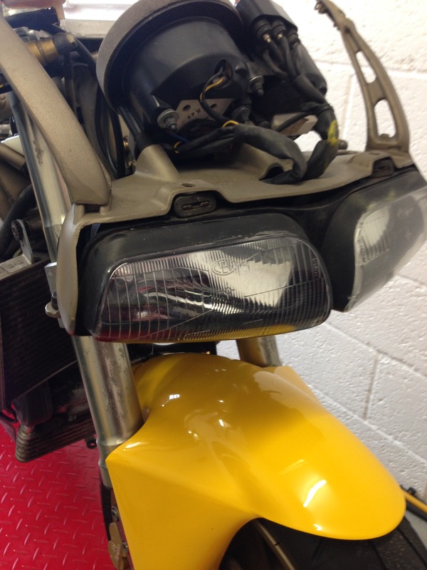

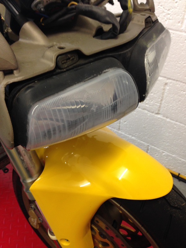

  2. The next thing that was winding me up were the cloudy headlights, I was budgeting for a replacement set but thankfully I found some info whilst googling away that they can be restored, simple home made cleaning bud and some WD40 transformed the appearance

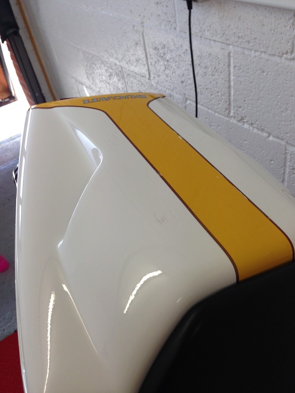

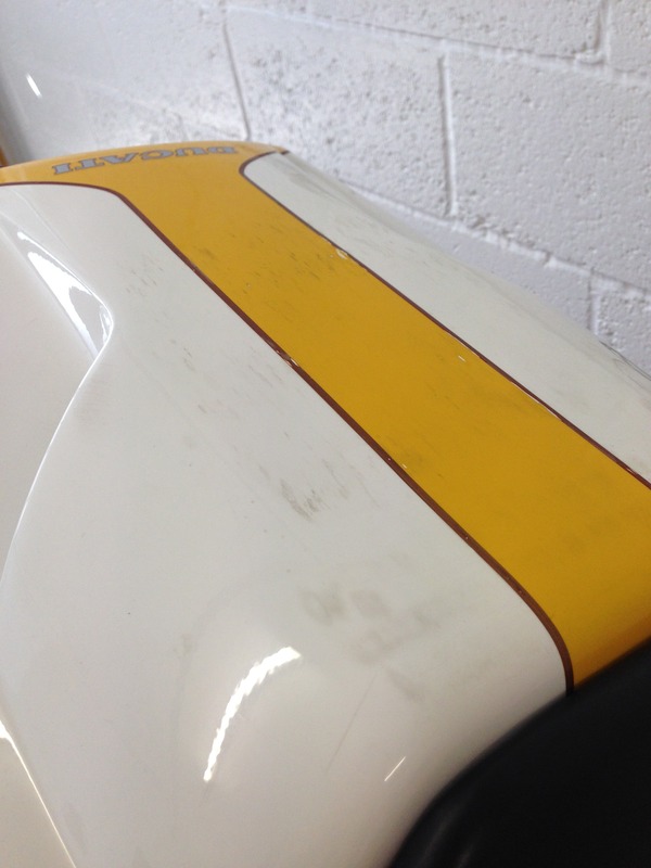

    One thing that had been annoying me almost as much as the cloudy headlights were the marks left from the luggage rack the previous owner had fitted, again this was something I did think I would need to repaint but a few hours with the machine polisher and 3M cutting compounds had it looking 95% perfect
    Before :
    After :
    Treated the rest of the bike to a very mild cutting compound

    One thing....the belts appear to be not quite wide enough for the pulleys...are you sure you have the correct ones?
    Otherwise - nice job!
  10. That's what I was thinking, any idea what a polishing service like that would cost? could be tempted to have a go myself first but as previously mentioned I would dread making a mess of them!
  11. Yep the belts are 100% correct width/ length, any wider and the belts wouldn't fit through the idler/tensioner tracks - I also provided the VIN number to my local Ducati dealer when ordering all the parts just to be extra safe lol.
  12. Belt looks too close together at the tensioner and idler pully, did you turn the tensioner the right way, as it will tension the belt in either direction, but one is wrong and puts the belt too close. Just an observation it might be the angle the photo was taken.

  17. I enjoyed that, bike looks very tidy, I also agree the belt does look very close, they should be tensioned anti clockwise, it could just be the angle the pic was taken.

    Interesting one with the Cambelts as I did think there's not a great deal of room between them and the reason I stuck with it was Ducati Proteam limited in Kent did the previous change and it was the same angle on the tensioner, I've got a picture of the previous belt fitting for reference, will upload it when I'm back on the desk top computer

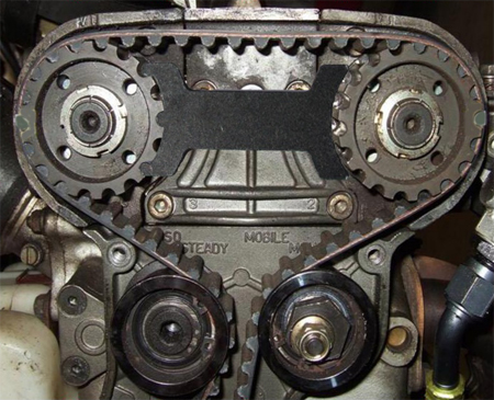

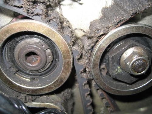

    The top pic is correctly tensioned anticlockwise, the bottom one clockwise.
    Steve
