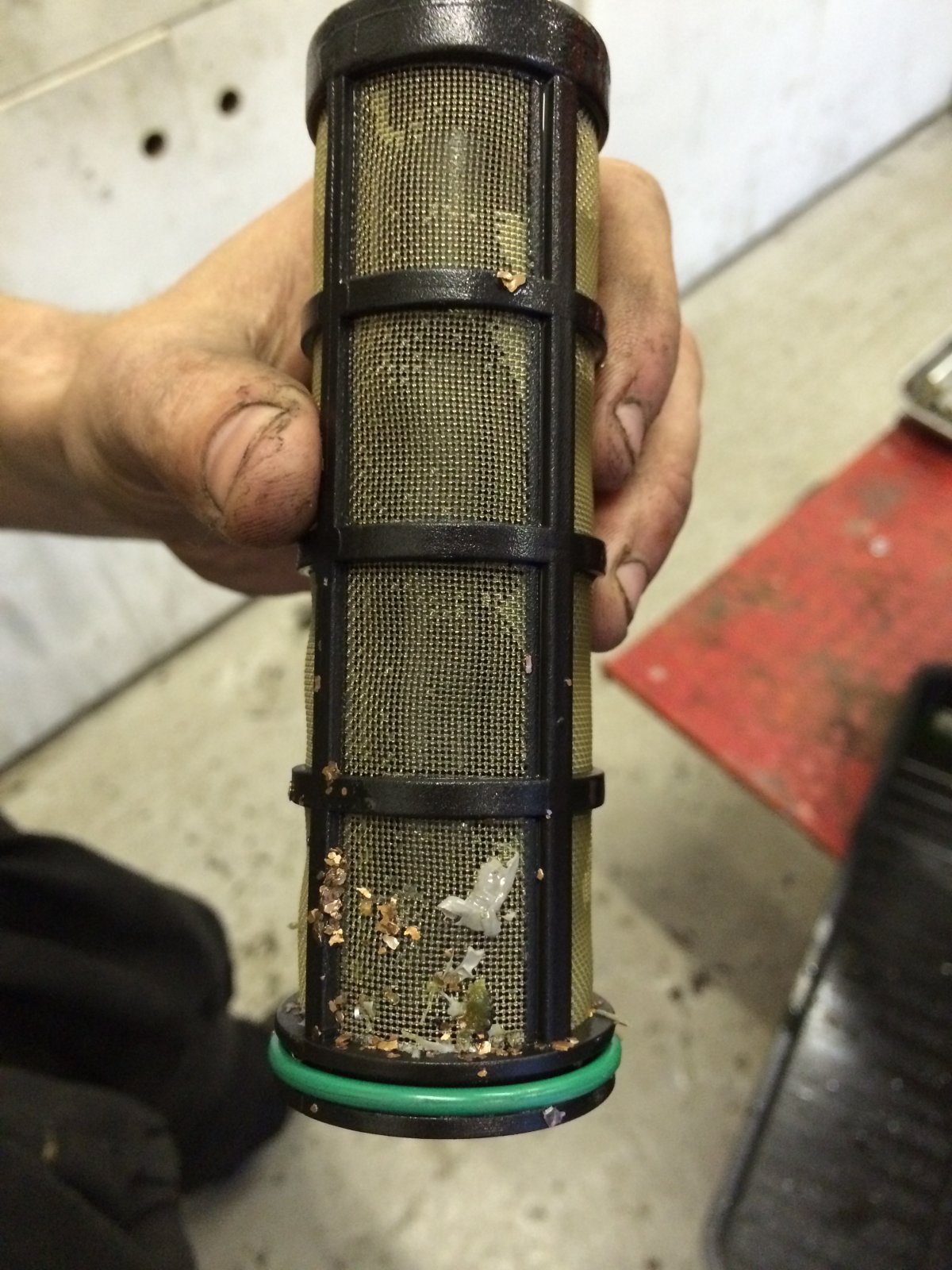

  16. Dropping the gauze (pre filter) will help give you an idea if the mains are going. Hope it something else.
  17. Thanks. I didn't do this last time. Will look into it.
  18. If you see this....... Then sorry.
  19. Hi jase. Glad you added that. I was looking for your thread but couldn't find it. Let's hope you don't see this!
