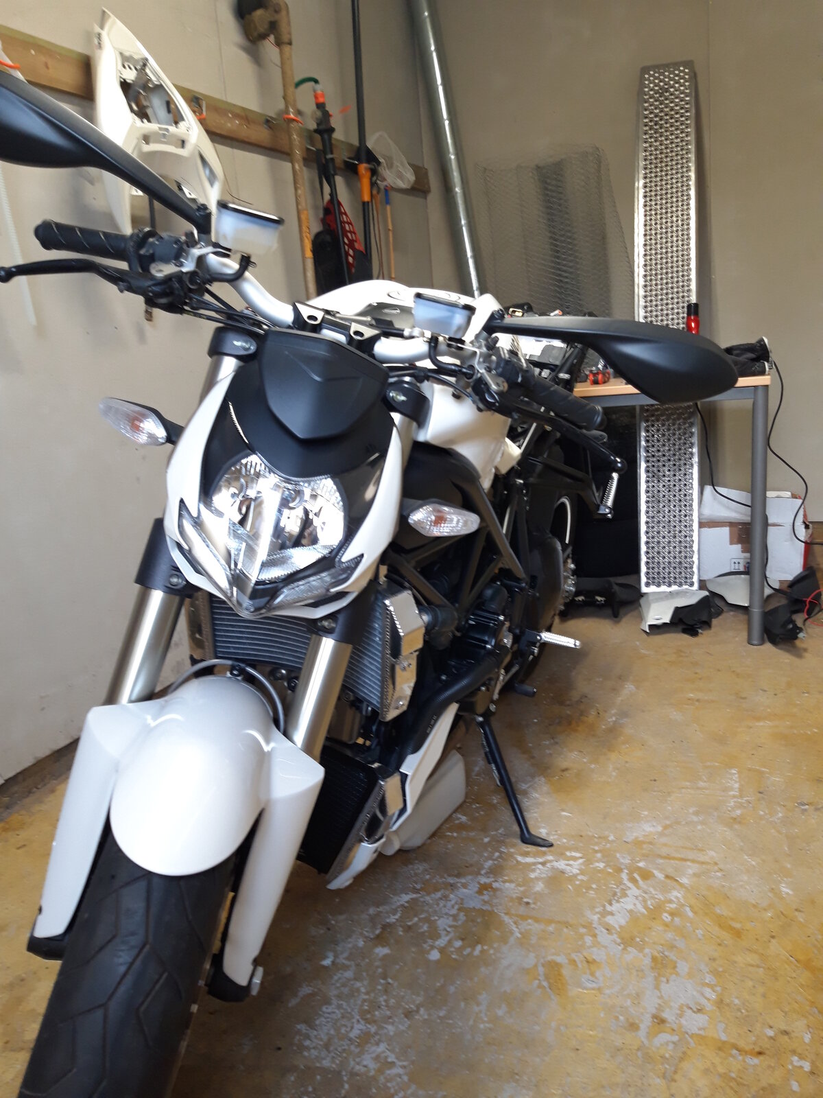

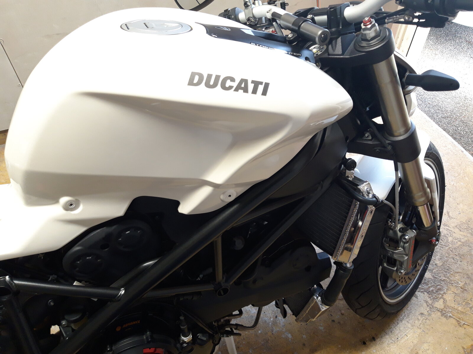

  5. SF fired up today and runs like a god. Battery was new but the dealer hadnt charged it properly. Some cooling leaks dripping on the lower radiator,did some tightening of the hose clips,easy fix. Im hugely impressed by the engine character,feels so different then my 1199. At the moment all i can say is,this deal & bike feels 2 good 2 be true!

    I had to change lower radiator,it was damaged where the small fairing screw threads into it. I dont like that design at all.
    I got a very good price and bought some chinese ones,replacing also the upper. There is no bracket on these for the horn but it was no problem to switch place to the side instead.
    Fans will not be re-installed,i have no need for them. Will get some plugs from the 1199 race kit.
    Also left to do is the upper radiator cover and thinking of going with Ilmberger side covers or maybe the Fullsix "special"ones to cover up the chrome & hoses.

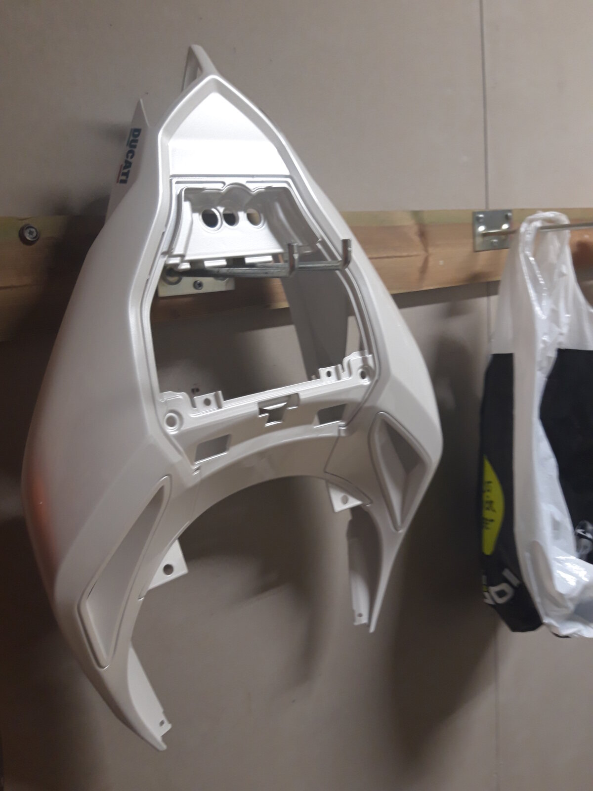

    A brand new tail also arrived today,the original one has some small damage in the clearcoat and i want this bike as new from the shop so it must be replaced.

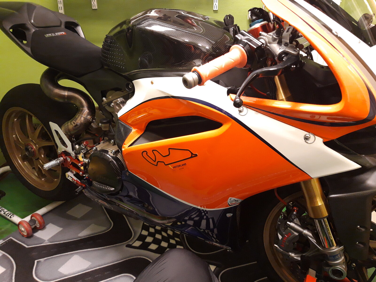

    Here she is for you:
  15. Oh my daze....now that is something.....
    Some day, some day, till then, I'll just have to put up with wind blast and wheelies. Enjoy the summer breeze
  16. Thanks,i will! To be longing for a bike is nice,im sure the stars will align for you soon..
