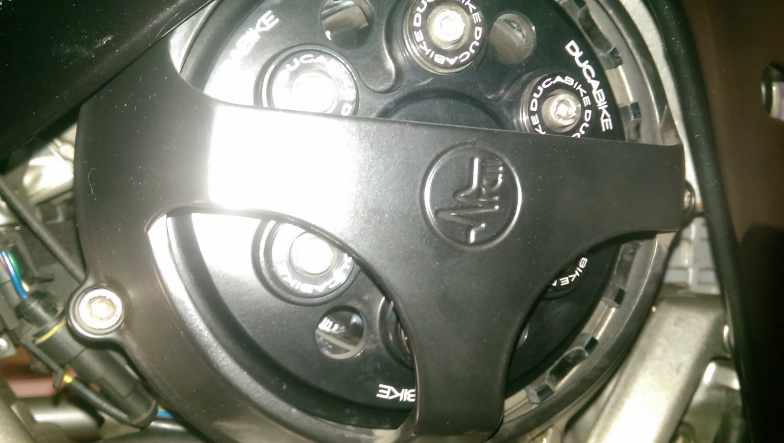

  3. A bad picture of mine

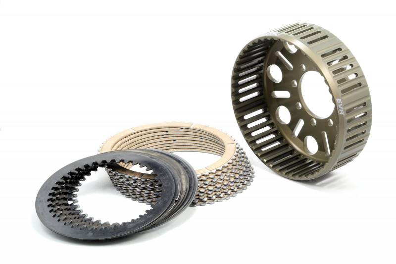

  8. Another question. Was looking at slipper clutches and google is so good at searching it threw up plates as well some are billed as 48 some 12 now is this the amount of tabs on the friction plate or teeth on the steel plate ?
  9. Most slippers use the standard 12 tooth Ducati friction plates.
    EVR do a slipper with 48 tooth friction plates, but you are limited to buying these plates when it comes to replacing them.
    On the subject, the steels have a lot of tabs, in case this is what is being referenced, but I think it's about 38 iirc.
