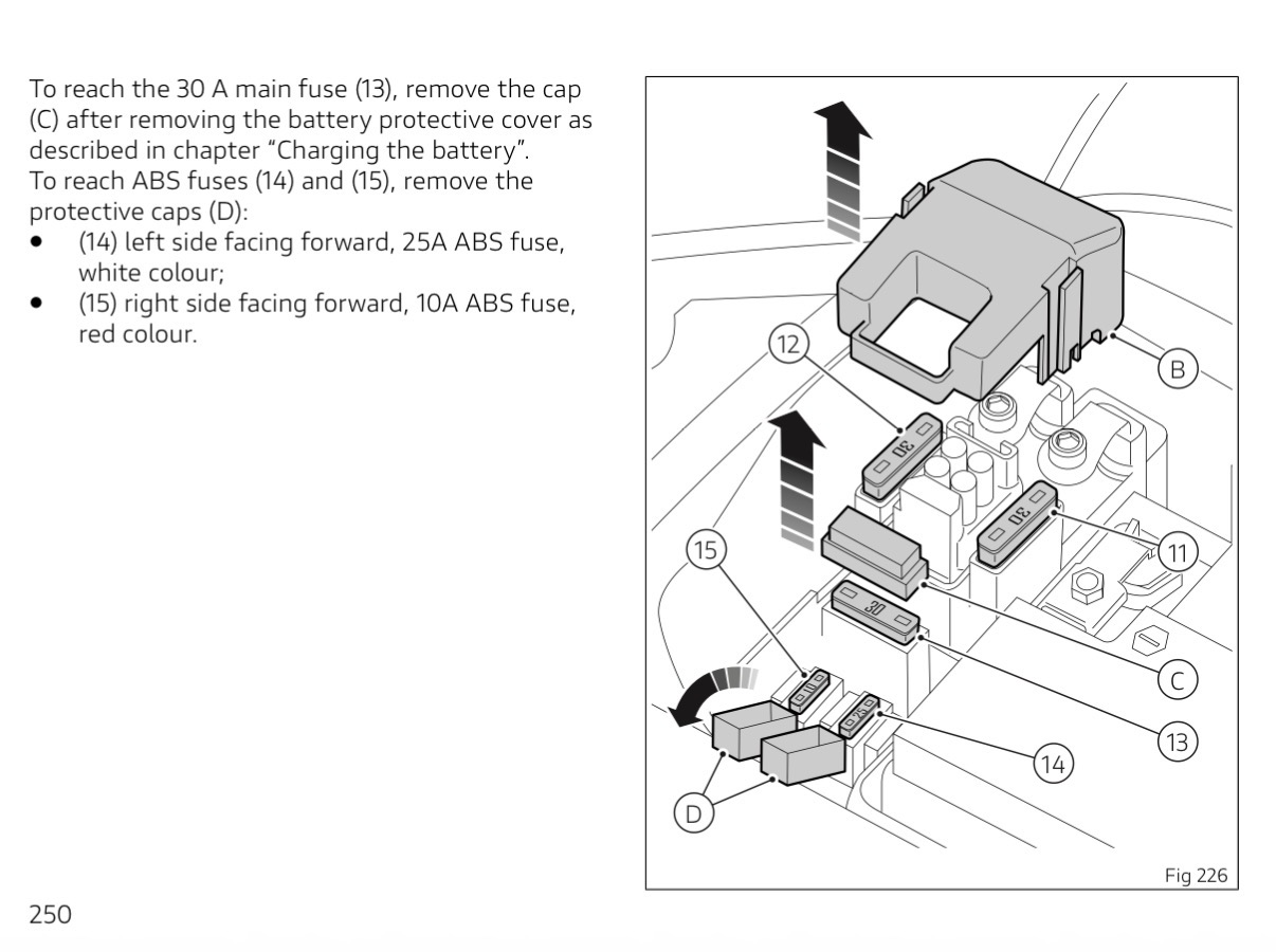

  2. I’m not sure it can cause a brake lock up of its own accord. It’s more a case of the fuse could go* which disables the abs which in turn may result in a locked wheel if one grabs too much brake too quickly.
    * Apparently there are 2 fuses for the ABS circuit, a lower rated one and a higher rated one, and they were inserted the wrong way on some bikes ie the lower rated fuse was put in the slot which should hold the higher rated one; if it blows the abs is disabled.
    I must look into it in more detail and get the fuse ratings and their exact location.

  3. Fuses 14 & 15 in the attached diagram have been incorrectly inserted on some bikes. Easy enough to check yourself.
  4. Tbh most people can just check themselves! Such a tiny recall. Unlike honda currently…
