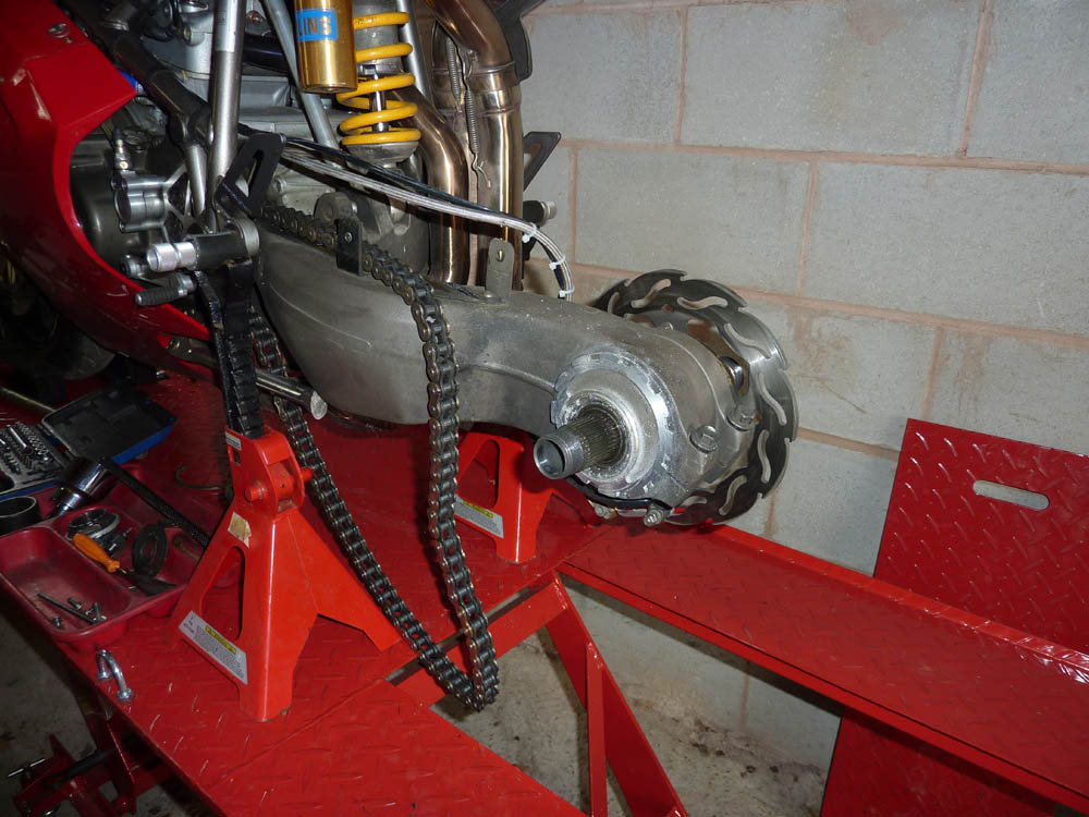

  2. Hi mate. Can't remember too well what's needed to be removed to pull the plate as it was a while ago I did mine...
    But for this and future use, see if you have a local fabricator who could make you something like this...
    Quite handy for removing most of the main parts and shouldn't take more than a couple of hours to make.
    Ian

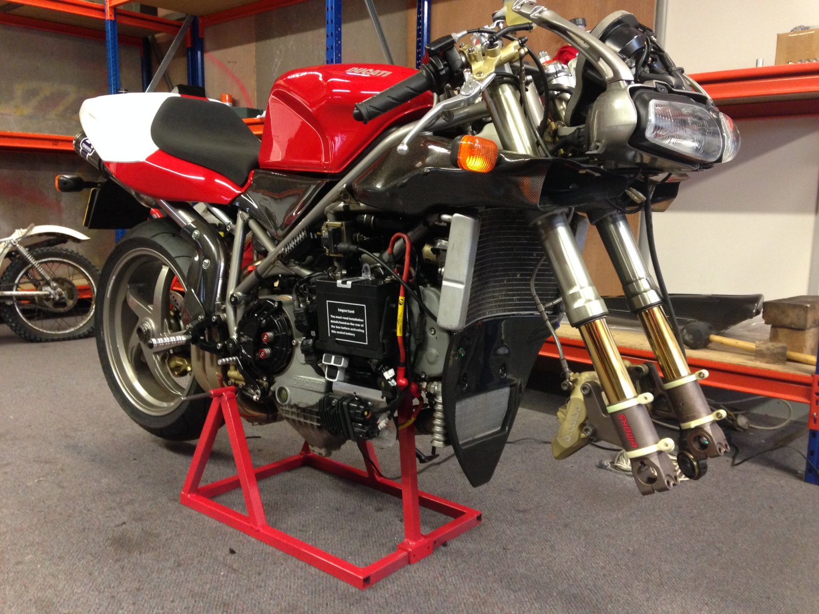

  8. I use a couple of axle stands under the footrests;
    As for tightening the caliper mount brackets, I always shy off the quoted torque as it seems too much for a thin alloy bracket IMO.

  11. You don't need to remove the hub, or buy fancy stands.
    If you use the convention paddock stand that goes of the chain side, remove wheel, caliper, then the large circlip to allow removal of the caliper hanger. Simple.
  12. Sorry but I don't think that works for the 998 as the disc and mount is on the outside (RHS) of that large circlip. Please let me know if I'm misunderstanding something though.
    Thanks.
