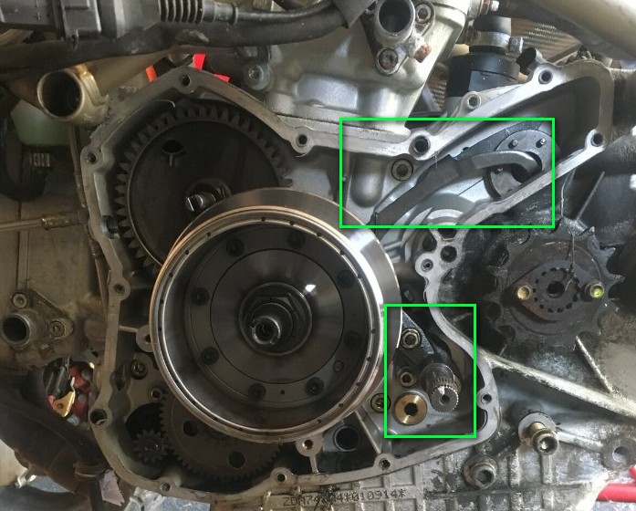

    I found this useful picture , which you had posted a couple of years back in this thread -
    https://www.ducatiforum.co.uk/threads/748-stuck-in-gear.69800/
    It's much better than the photos in the Haynes , and the drawings in the Ducati manual .... :upyeah:
    I've highlighted where I'm thinking ( hoping ! ) that the problem might be , and keeping my
    fingers crossed that it's not the spring ..... which I'm sure needs the flywheel pulling off to replace .
  9. My gosh, I’d forgotten I’d gone that far in on that one :eek:. Yes, that’s how it should look if all is working perfectly and hunky dory. I’d removed the alternator cover to strip and repaint it, mechanically all was sound :upyeah:

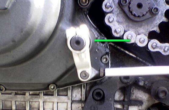

  10. Just in case anyone finds this thread in the future , this fix worked for me ,
    it was my last attempt before draining down , and taking the alternator cover off .
    I'm always wary of using too much force when something is stuck ..... but in this case ....
    I got the link rod out of the way , then moved this part of the linkage ( see photo )
    to about the 3 o'clock position , wrapped it in cloth and put mole grips on it .....
    rocked the rear wheel back and forward while working the clutch ..... and bingo
    .... it popped back into neutral , and now I can easily go through all the gears again .
    I'm posting this just for completeness , and maybe someone who is having similar grief will land here
    and get happy
