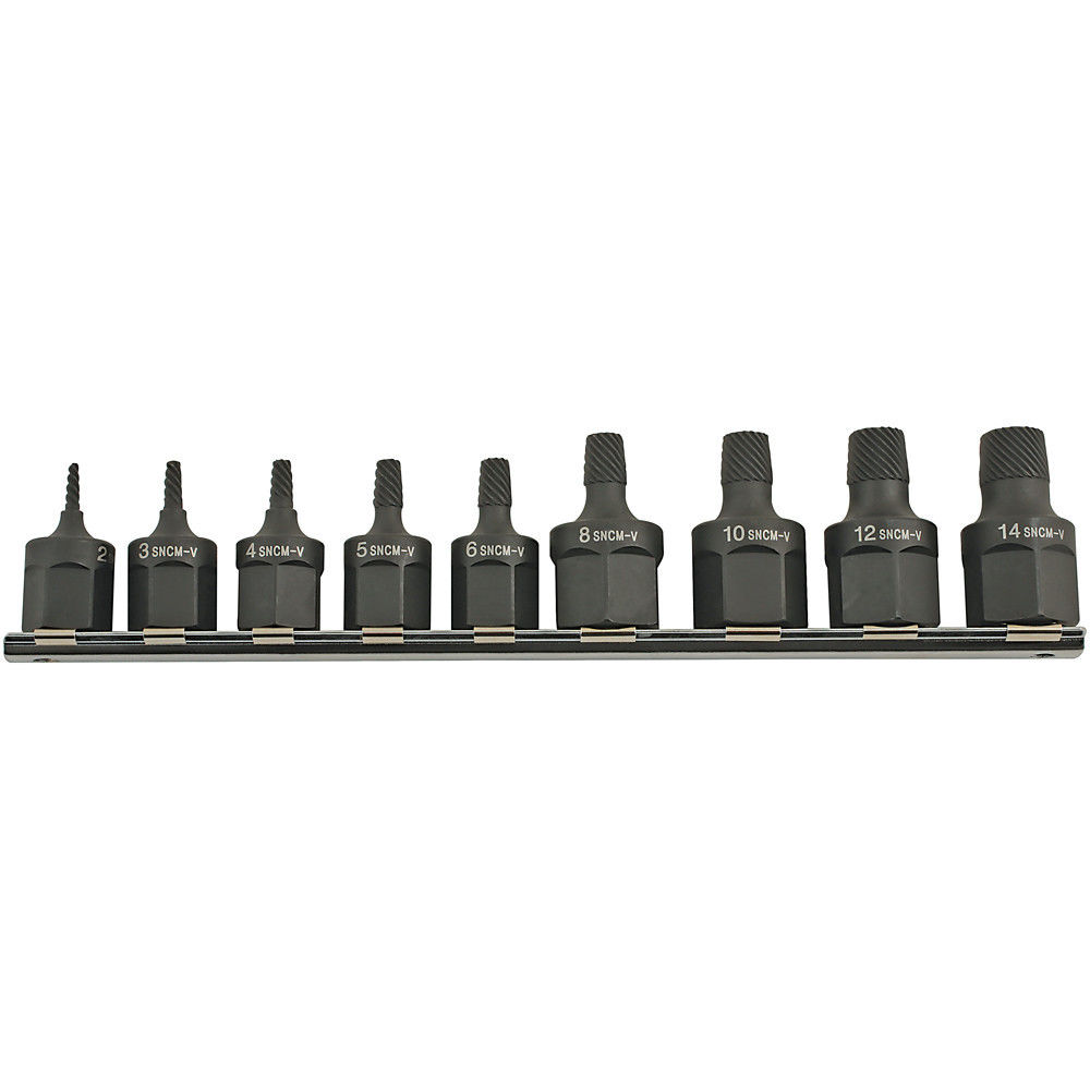

  3. Thinking one of these will sort it.
  4. I've never achieved anything with them. But that might just be me.
  5. Yeah tried the heat gun and chisel, taping and torx methods. I'm thinking the 12m extractor will bit into the plug and remove it. Crosses fingers.

  17. Never seen the likes of them before .... but they look like serious kit
    .... what are they called ?
    Do you have a link to where you saw them ?
