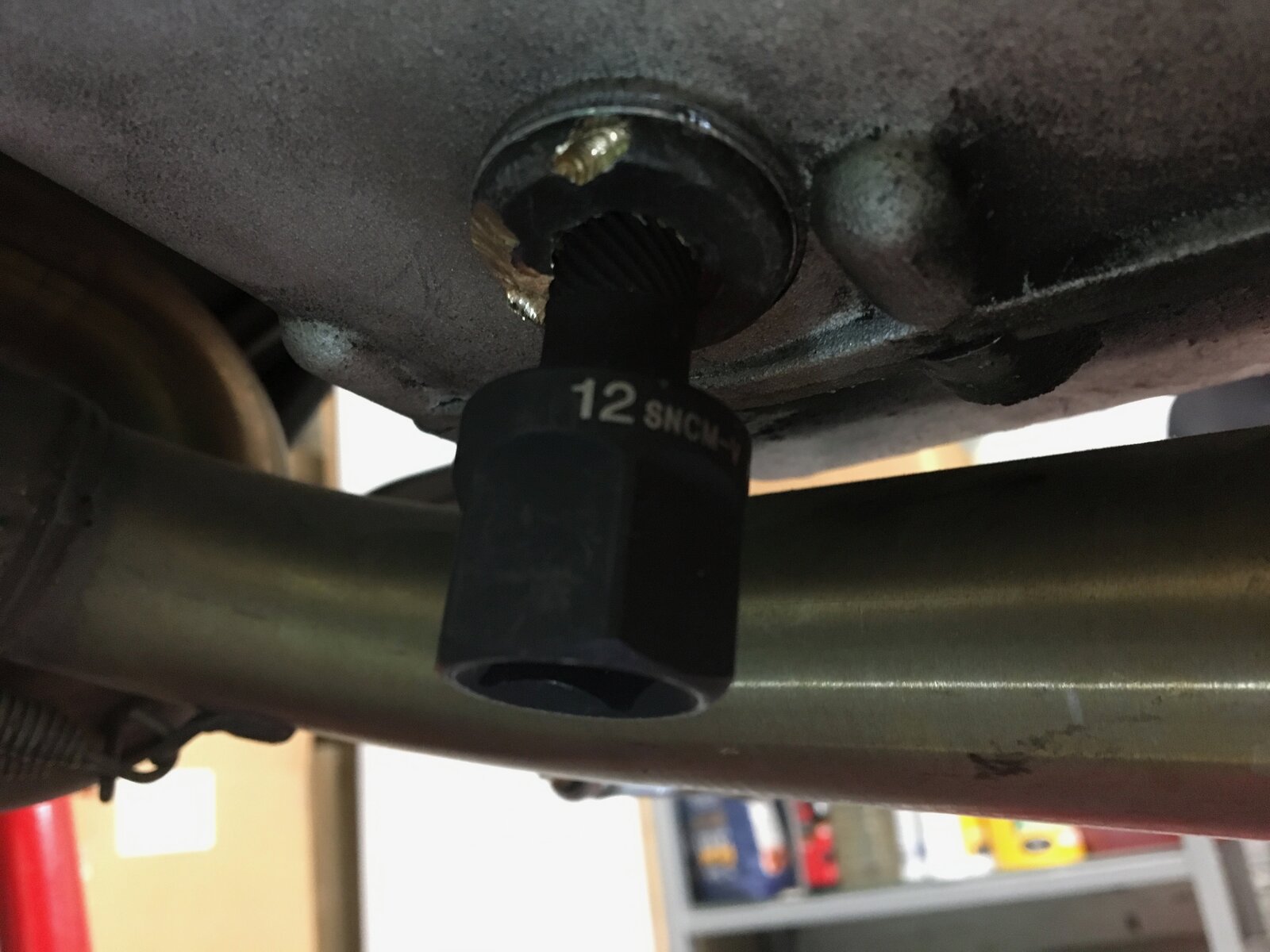

  1. And... its out! For those who's money was on "turned it the wrong way...." you would have lost all your money!
    12mm Laser 5967 extractor socket worked a treat but still needed a fair bit of force to budge it. The tool bit into the plug just nice and didn't stress the threads of the plug.
    Just need a new sump plug now :) Thanks again for all your support and suggestions.

  3. Would advise you get an aftermarket one with a hex head, easier to fit/remove and does away with the sloppy fitting allen key hole...
  4. Or...a torque wrench.

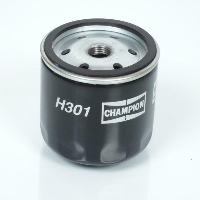

  15. You were right about the filter
  16. to cut to the chase in the worst scenario, it's best to make yourself familiar with the holes in the sturdy base of your filter, after tearing all the coke-can stuff off. I modified an old tool to locate in these but I know a mate on here who managed with a pair of long-nosed pliers..
