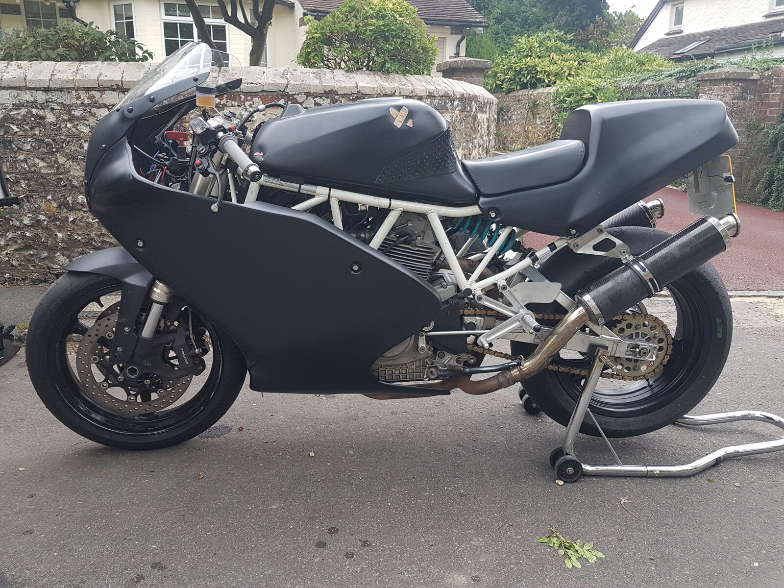

800ss and 900ss slightly modified and now wearing new spaghetti exhaust system, link pipe and titanium silencers. Sound great, run great and lighter than air (nearly)
800ss was 148kg with standard end cans. Not accurately weighed since but must be south of 145kg with no fuel. Engine is standard so that's the next lightening job. 900ss is just over 150kg with the fairing and bracketry. Light flywheel and various gears, balanced crank.
Mostly fresh air, no airbox, loom cut down, lithium battery, no fairing etc. Frame very heavily modified with all redundant sections removed. The list goes on. Tyres for supermotard save a little bit more. I could bore you silly!!
