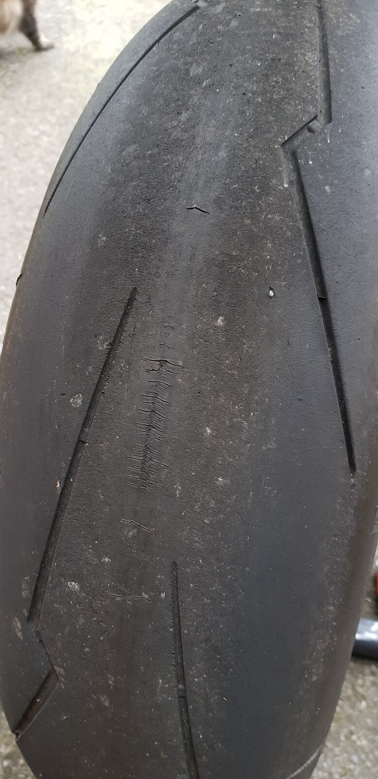

  1. Noticed this earlier today.. haven't seen this on any other tyre before. Rears probably done 1200 miles now so could be just indication the rubber is getting thin... Any thoughts?
  2. They always go that way when the centre is going thin. Typical Supercorsa problem of ‘Ive probably got 500 miles left’ to ‘oh shit there’s thread’

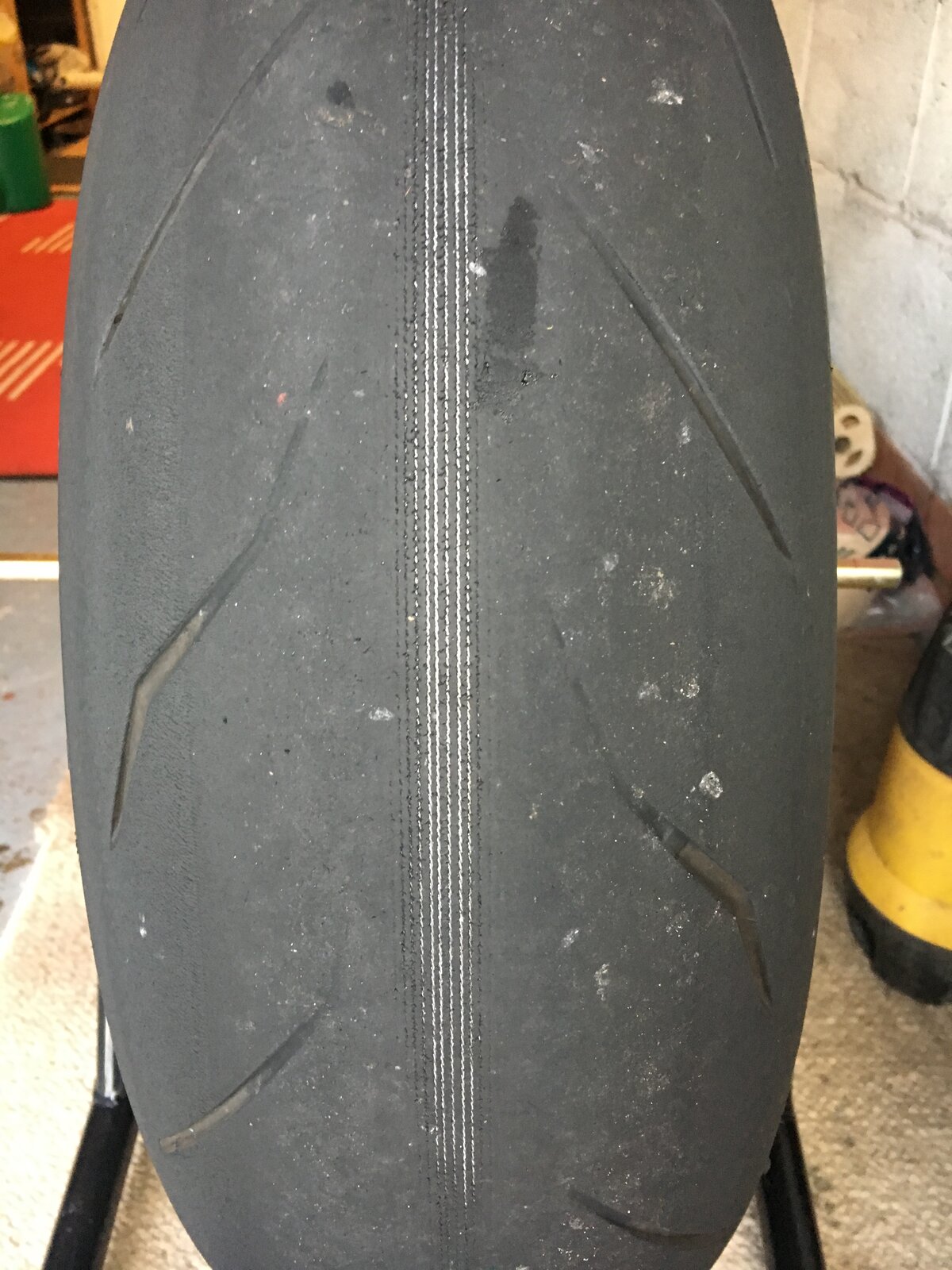

  3. 1A29DE8B-D96E-4A5C-97A2-B31BD6F1910B.jpeg Nothing that
  4. Exactly. Bet you thought you still had a tiny bit of life left in that rear :joy:
  5. Looks like I've got plenty left in mine then!
  6. Yep, plenty of 100 miles max
  7. Looks like tearing rather than cracking...
  8. It is. It’s basically so thin it tears. No indicator of depth in the middle of those so it’s the only warning sign you get.
  9. It’s fucked, worn out. Chuck it and get another :upyeah:
