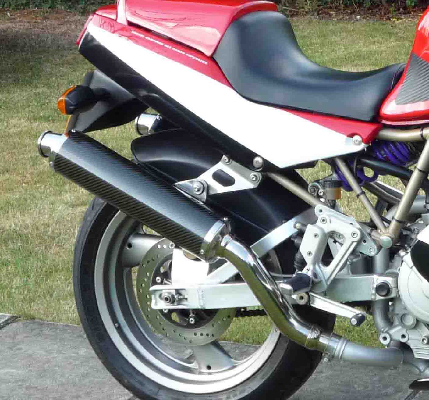

  2. I made my own - I was going to use 3mm stainless, but I used 4mm stainless in the end.
    They were effectively in 4 parts - the hanger threaded at the bottom with a nut welded to the back (made a longer thread), the bracket bolted to the silencer can, a rubber grommet in the bracket, and a top hat bush pushed into the grommet - fixing bolt went through bracket, bush and into the hanger thread. The small end of the bush was tight against the hanger so that left the can isolated from vibration because of the grommet.
    Never cracked or broke, plus I could adjust them with a slight bend if things weren't even.
    IIRC Steve Bailey may have used the pattern of my hangers for his versions. I know I said he could if necessary.
    Anyway the ones on mine are below.
    I think I still have the whole lot as a Cad drawing.
    AL

  8. Why not get a good hanger so you can use it as a pattern and have a pair made in stainless steel?
    Making the set the same as mine may not work out because they were purpose made so that I could properly fit the Laser cans and fixed link pipes which were intended for an SSIE rather than the carbed model.
