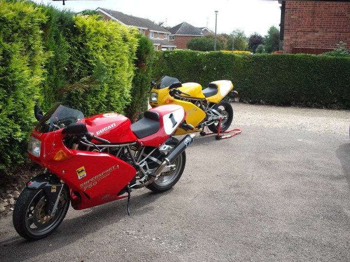

Superlight Single seat unit showing all the brackets etc in place.
Discussion in 'Supersport (1974-2007)' started by sim900sl, Nov 16, 2013.
  1. Those are the pictures I used^ made 2 sets, one for the 600 and one set for the 750ss :) image.jpeg
    Oh how I miss the red one :(
