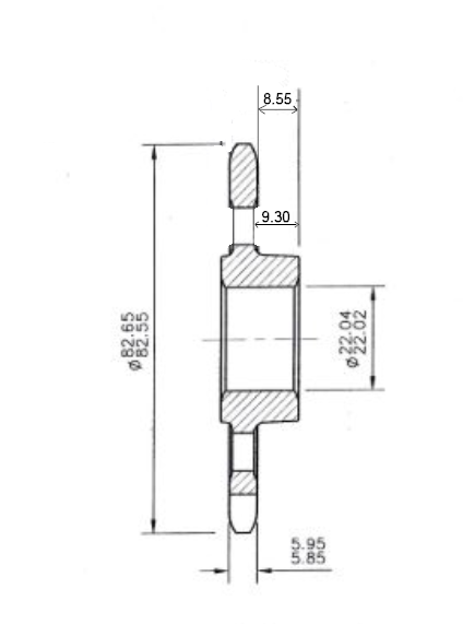

  4. I have just fitted the Renthal sprocket and it fits just fine. However, the lack of the 1.85mm offset from the front face of the JT sprocket is a misnomer and has nothing to do with the sprocket alignment.
    The rear boss of the sprocket seats against a spacer which is against the bearing with a nut holding both onto the shaft. The important dimension is the distance from the inner edge of the rear boss to the inner edge of the sprocket which I measured to be 8.75mm on both the Renthal and OEM sprocket. I have no idea what it is for the JT sprocket since it is not shown. According to Renthal's diagram it should be 8.55 ± 0.05mm
    Sorry if I have given anyone cause for concern but it would be worth checking a JT sprocket anyway.
    Edit : I had measured from the slight recess under the teeth and not from the edge of the teeth so I have corrected this post and the diagram to reflect that.
    #44 Derek, Feb 3, 2020

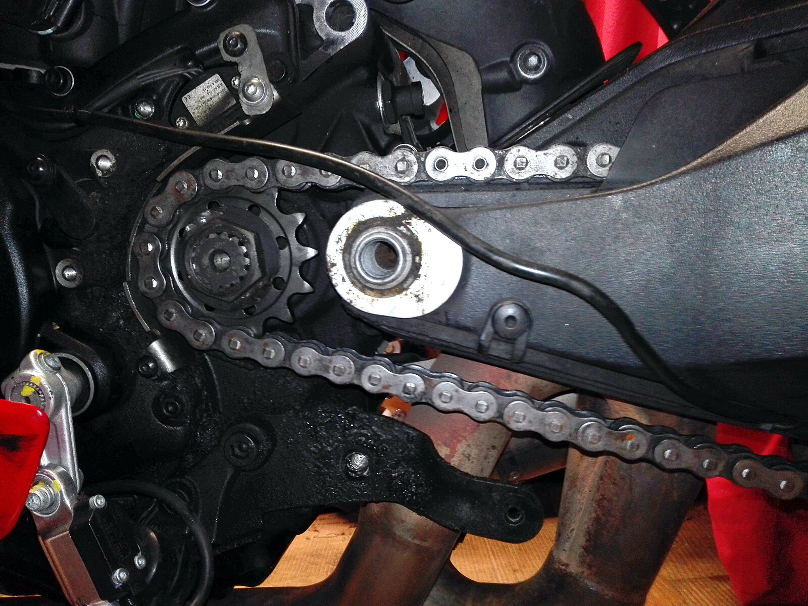

  5. While I was fitting the sprocket I thought I'd investigate the case saver that I have from the previous Multi. I knew it didn't fit because Ducati have altered the crankcase of the Supersport to accommodate the gear sensor.
    To fit it I made a small link that I bolted to the upper hole in the case saver which allowed me to secure the case saver using the gearbox sprocket cover bolts. With the cover in place it's completely hidden.
