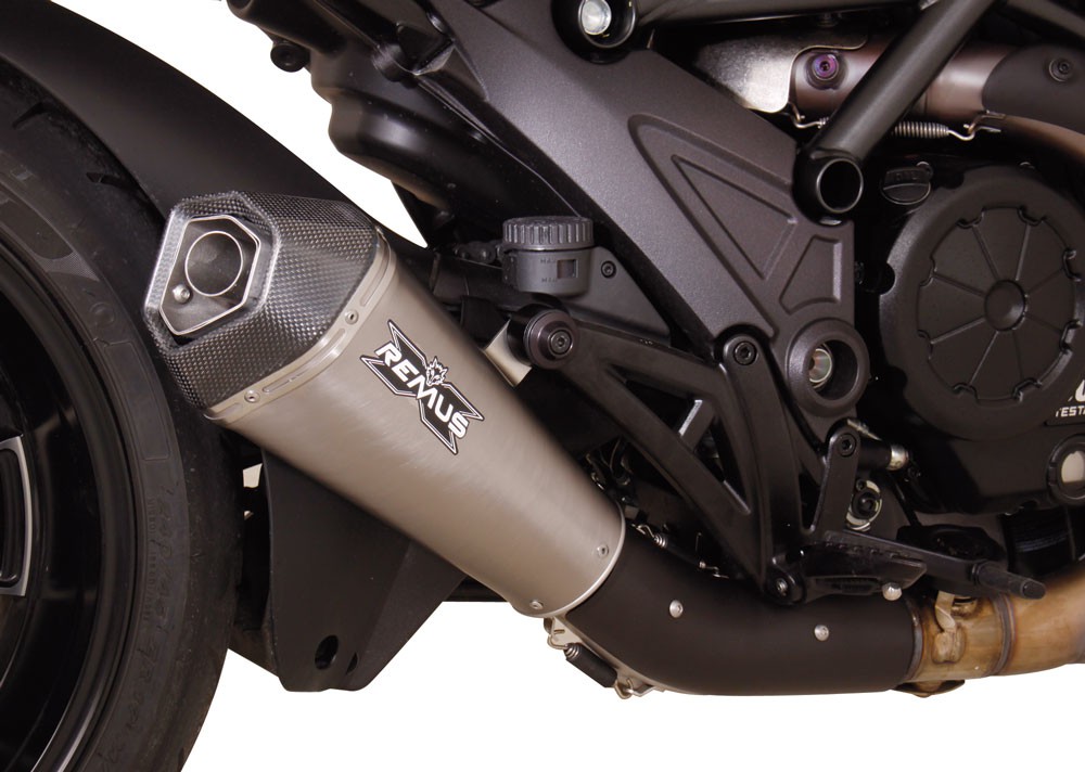

  20. As well as the original exhaust it also comes with this one :) but I think in black.
    Also noticed in picture, among other upgrades is the rear shock which is Ohlins
