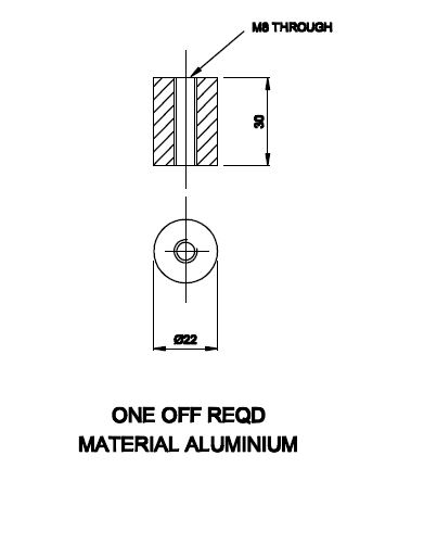

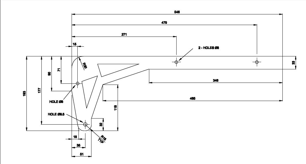

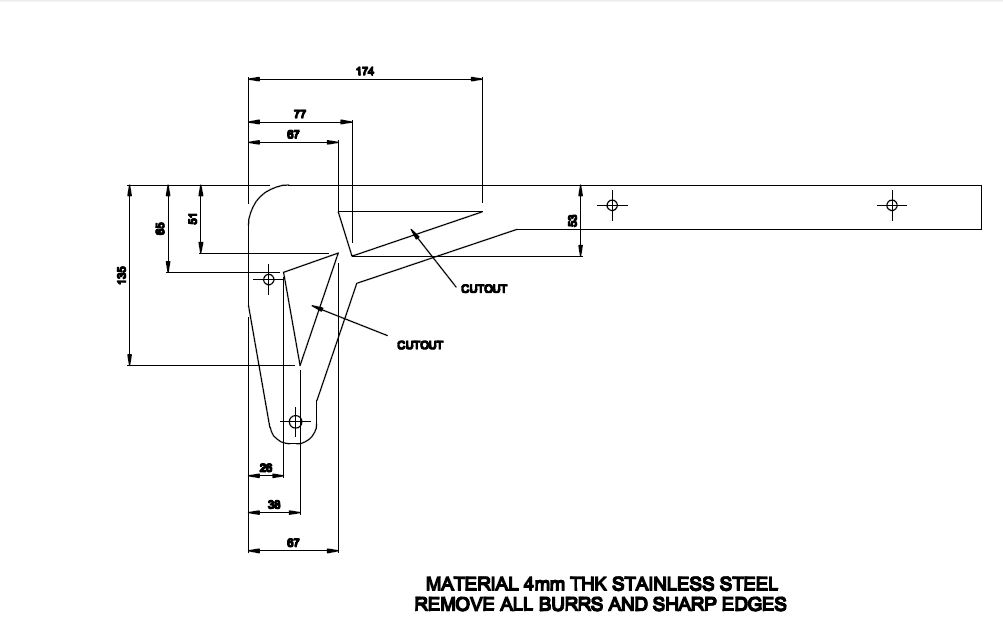

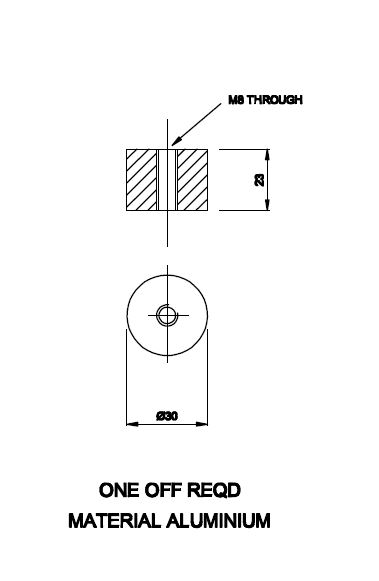

  13. I found this if it's any help, it may have possibly been posted on here before.
    I have it as a PDF file if anyone wants it emailed to them.
