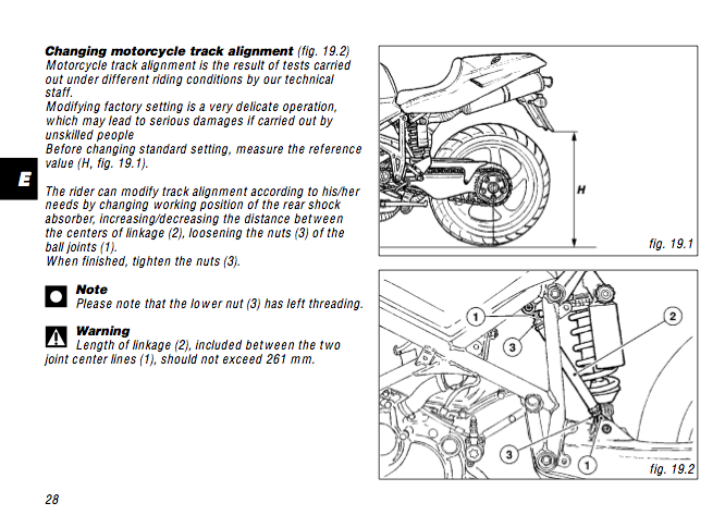

  1. The std length is 261 and the max is 261. Suggests possible typo
  2. It doesn't really make sense either does it BUT DARE I OVERRULE HAYNES!!!!!!!!!!
  3. heres a 748 manual but its the same it speaks of the 261 as the maximum.......
  4. Exactly the same as my 996.
  5. theres no way this is at its maximum.....

  6. i can wait for the fifty posts once you start to try to undo those lock nuts...........
  7. Cut it off with a grinder and donate to dusty bin. Extend the rod length by around 15 mm too, other wise its set up for Ronnie Corbet

  9. the thing is i wouldn't waste your time pishing about with those bits until the more important stuff is in place.......
  10. Ok, fair enough. I will give Luigi Moto or Baines a call tomorrow and ask them about link length.
