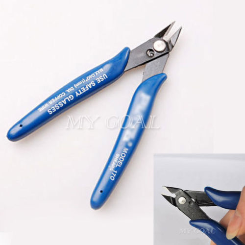

    I have seen the cable tie approach but what I'm not sure on is if it is tight enough to stay put how do you get it off, don't want to scratch my stations with snips, etc.
  14. [​IMG]
    Flush cut pliers
  15. Hacksaw.
