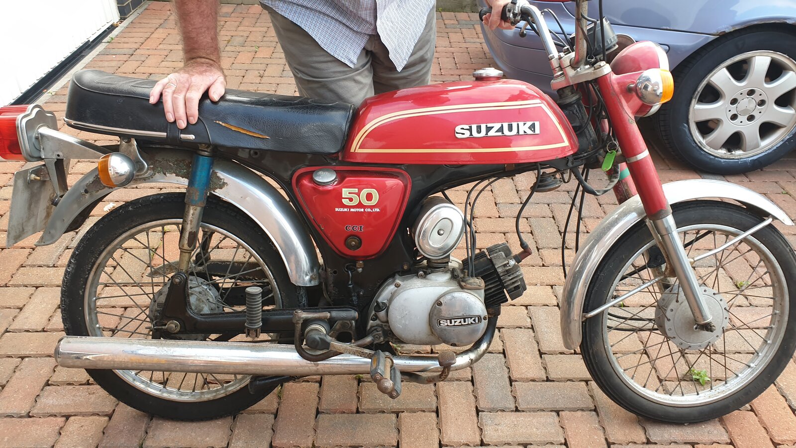

  1. I've got this 1977 Suzuki AP50 to get up to a reasonable standard. My uncle bought it new in 1977 and it has been in storage since 1993. I'm not clued up on two strokes or carbs for that matter. I was born in 1989. This is a cool little bike. 20200801_194112.jpg

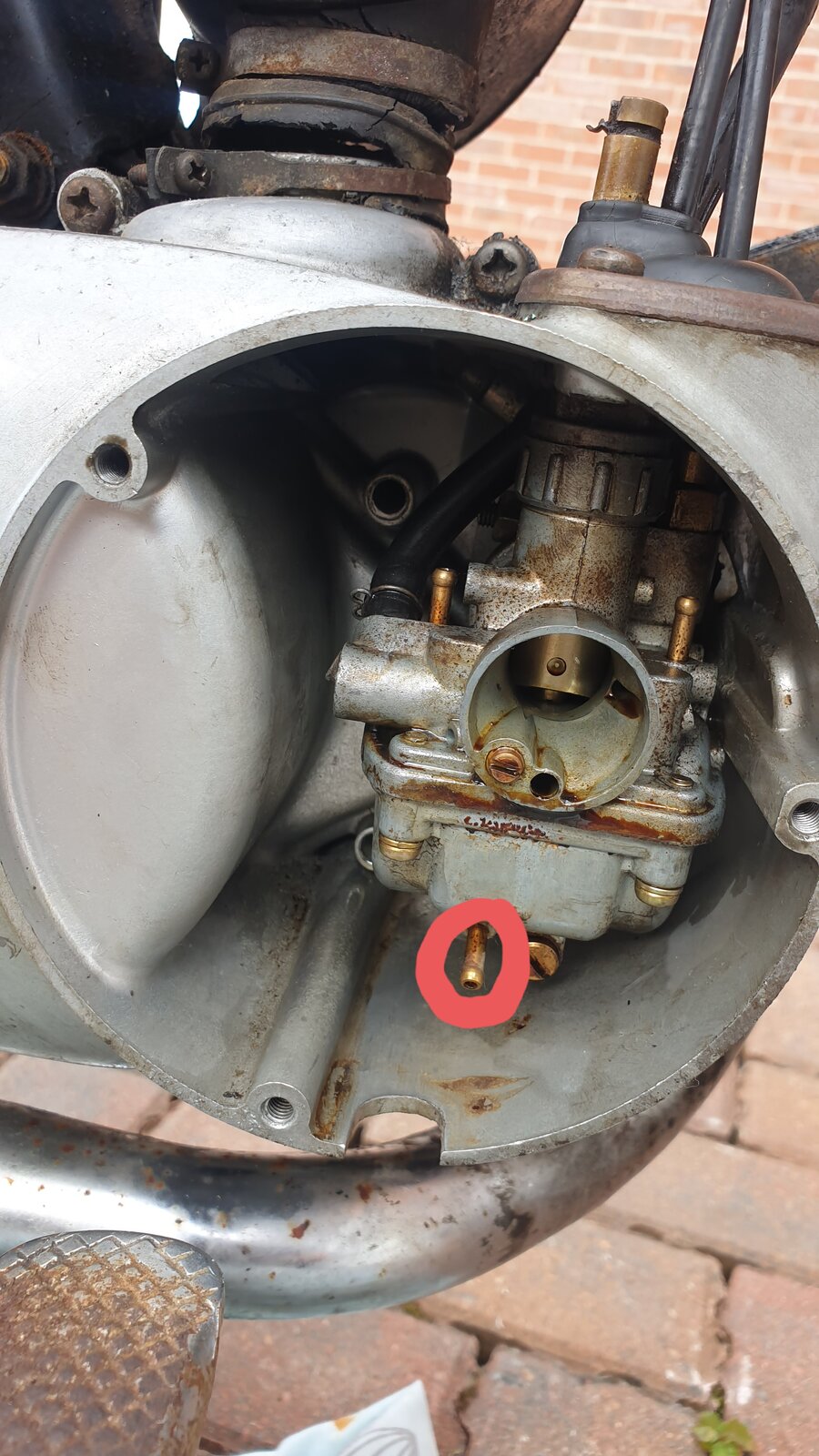

    It's not in the best condition. So I'm going to start with getting the engine running first. Then brakes and tyres then look into the cosmetis. It's got a fuel leak though so I haven't attempted to start it yet. It's got fuel pouring out of the bottom of the engine. Its leaking out of the pipe circled below. The throttle was jammed as well, which I've freed off for now.
    Anyone on here know much about these? Any good places to find parts? I've found wemoto sell a complete carb for £73. Will save me stripping it and the prices on the Suzuki vintages parts website will add up fast!
  2. Drop the engine out and start stripping it. Carb, just clean and maybe a little rebuild kit. There is a little float at the bottom of the carb, prob just stuck and over flowing. The carb is a simple little thing to take apart.
    Pull the head, check piston, crank etc etc etc.
    Nice little bike, worth spending a little time on it, doubt it would take much to get it running.

    The float is stuck, that’s why it’s leaking from there. As said, probably just gummed up with old fuel.

  5. I initially thought there was a rubber hose missing from that pipe at the bottom.
    With it not being moved in 27 years I'd rather get new parts for peace of mind. They're probably well past it. I'll get a list of parts together and start stripping it.

  8. No x ray vision here unfortunately. It was more to check for the cost of parts and availability if needed really.

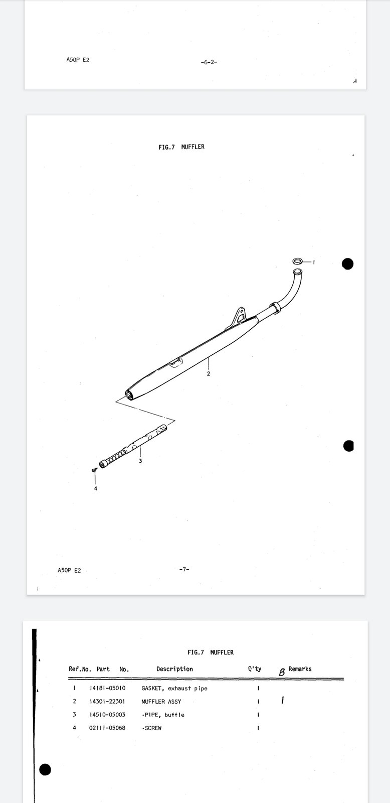

    On the spares front, Suzuki have reissued loads of spares under their vintage bikes program. The AP50 does feature in that so you can get lots of parts from a Suzuki dealer and know it is right. The parts are not generally over priced either :) Always worth checking there first
    I have added an old AP50 parts catalogue to my post here :) Hopefully you can download it and make use of it .. its as old as the bikes are though so even on scan, it looks worn out
  10. I have another parts catalogue for the AP too, but its over 3 meg and too big to add on here. If you want hat as well, message me an email addy and I wills end you that too. Its very similar, just covers slightly different models ;)
