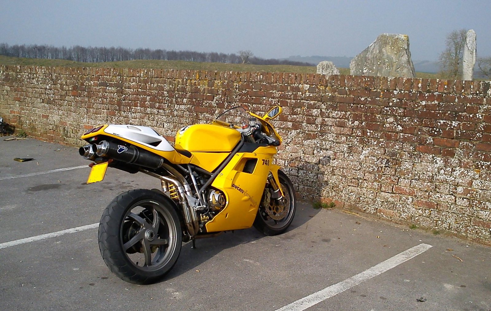

    I bought a MY2000 748R in my salad days and I went through the same baptism you are.
    I loved the bike, but the clutch was fecked and I didn't know how to unfeck it, the bastard kept stalling, which turned out to be the Nile flood siltage in the fuel filter, then the fecker started to fart on the over run, which I sorted with a tweak of the trim pot.
    The bloody hours I spent on the internet, then in the garage sorting the bugger!
    Finally got it all sorted and some dopey Polish sucker of cock T boned me at a junction!
    RIP my poor yellow bikey. :(

  7. Oh Nelson that just ain't right. She looked lovely. Even when/if the insurance pays out it is never the same as your lost love with all the time and emotion that we put into them.
