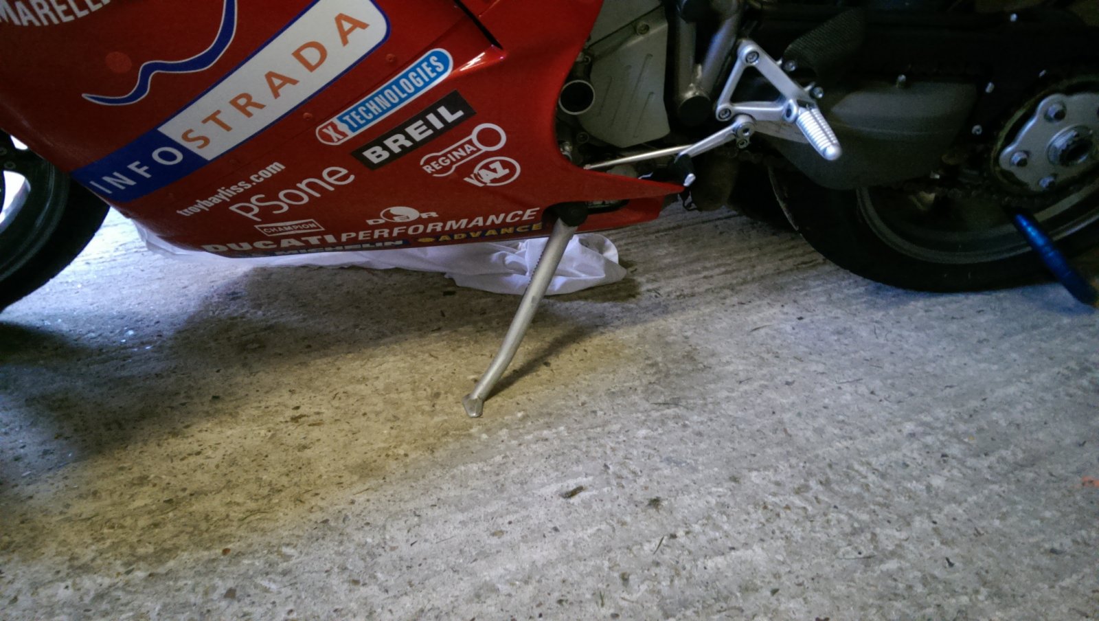

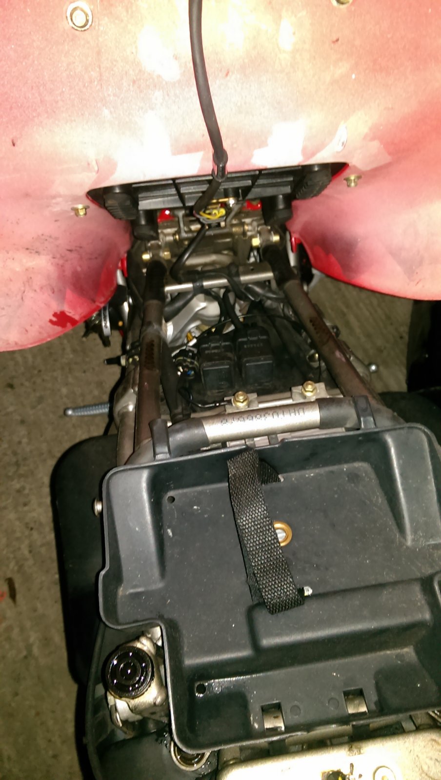

    Here is under the seat (thank you) and the side stand, I assume all is normal here.
    Which bit do I need to wrap in a carrier bag to stop them getting wet? Is it the two connector boxes under the riders arse?
    I have learnt that the little holes where the tank bolts down like to fill with water.

  13. Sorry for confusion I just wrap a plastic bag to cover the fuel pump relays WHEN CLEANING.Worth a squirt of WD40 in there now you have the seat up.
    Also although owner manual states to take bike to dealers for chain adjustment you can do this at home.You will need the c spanner in the tool kit.And you must get the torque correct on the two swingarm pinch bolts.
    At the top of the sidestand there is a bracket.If bike starts to lean more check this as one of mine had cracked most of the way through and started to bend.Luckily this was spotted before it gave up completely.

  15. Mr. @Cream_Revenge you have purchased the most beautiful bike in the world.
    Stand is normal...never sit on it side saddle.
    Others will answer the other question and I'll try and be good until the end of class.
  16. Thanks Matt, confusion averted and I will follow suit as its so easy to get up.
