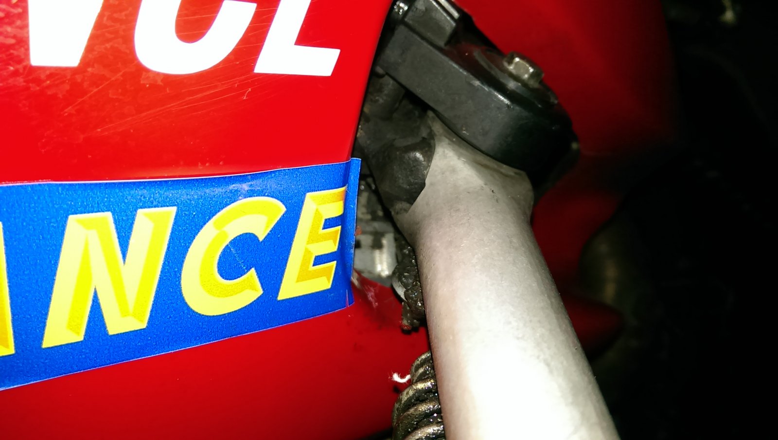

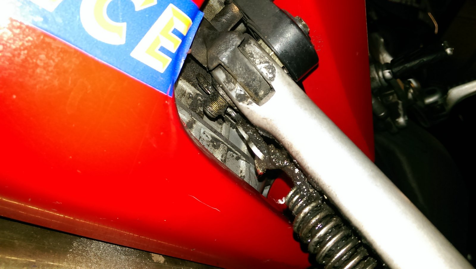

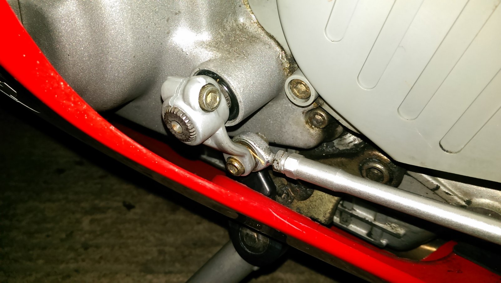

  1. That looks (at least in the pic) too far forward.
    Check the bolts are both there and fully tightened and that the bracket has not snapped.
    Do it soon or your bike will be on the deck!

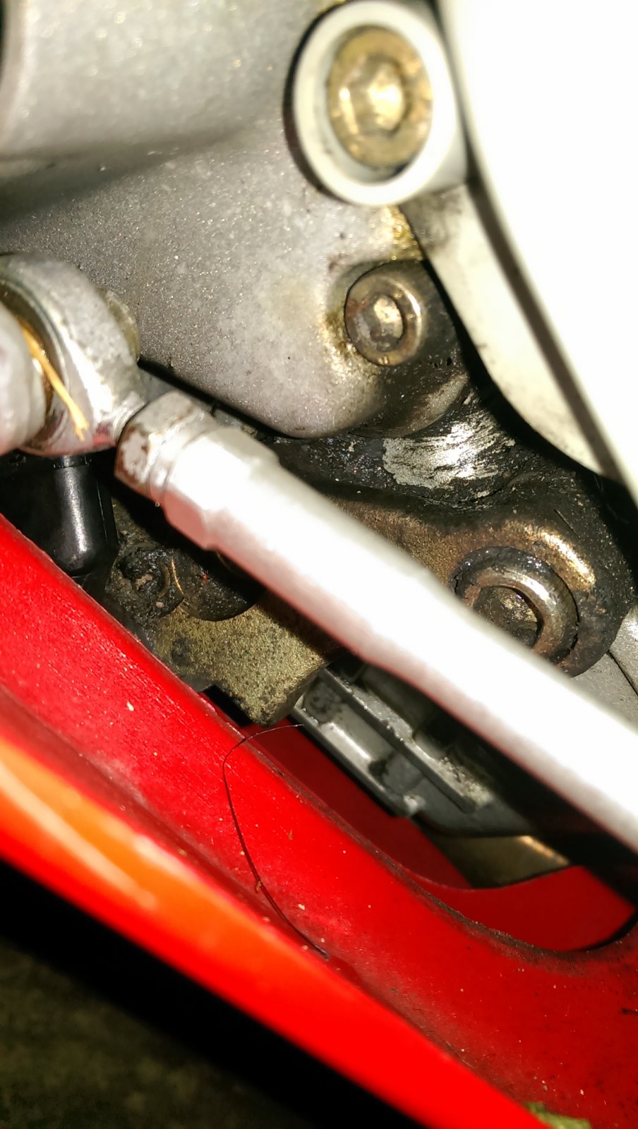

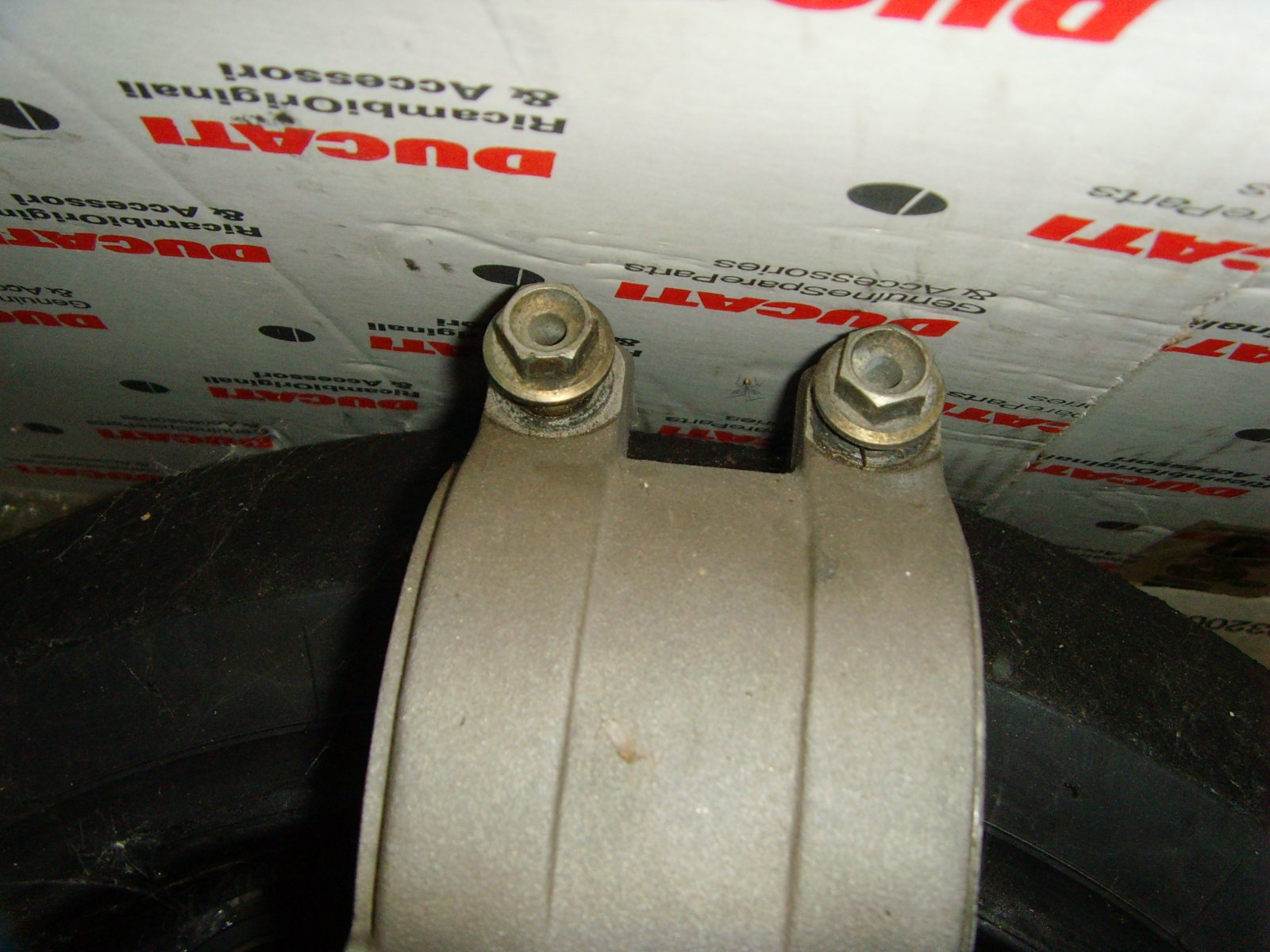

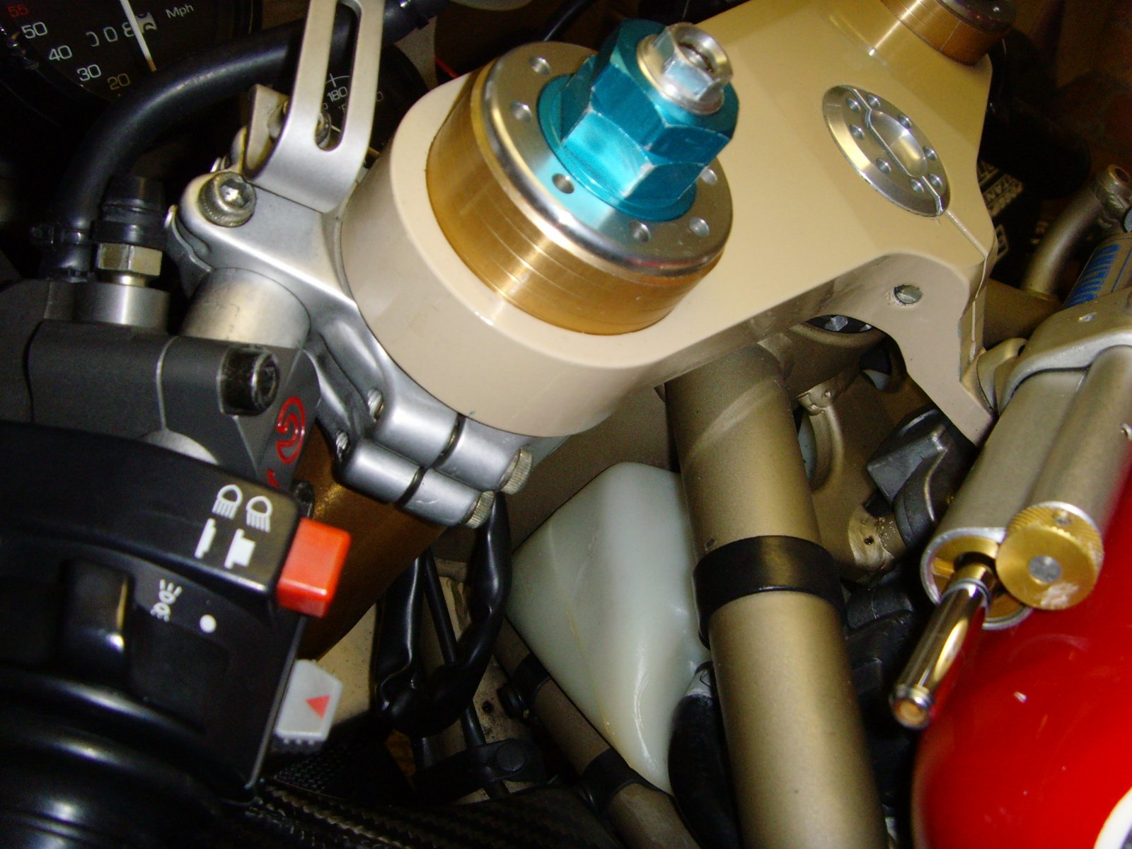

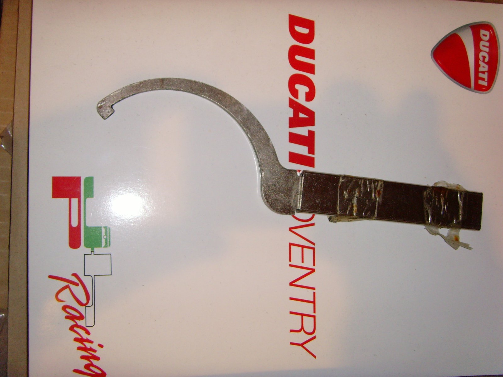

  2. Hope these pics help.
    1 .Side stand bracket
    2. Coolant plastic bottle
    3.C Spanner for chain tension adjustment

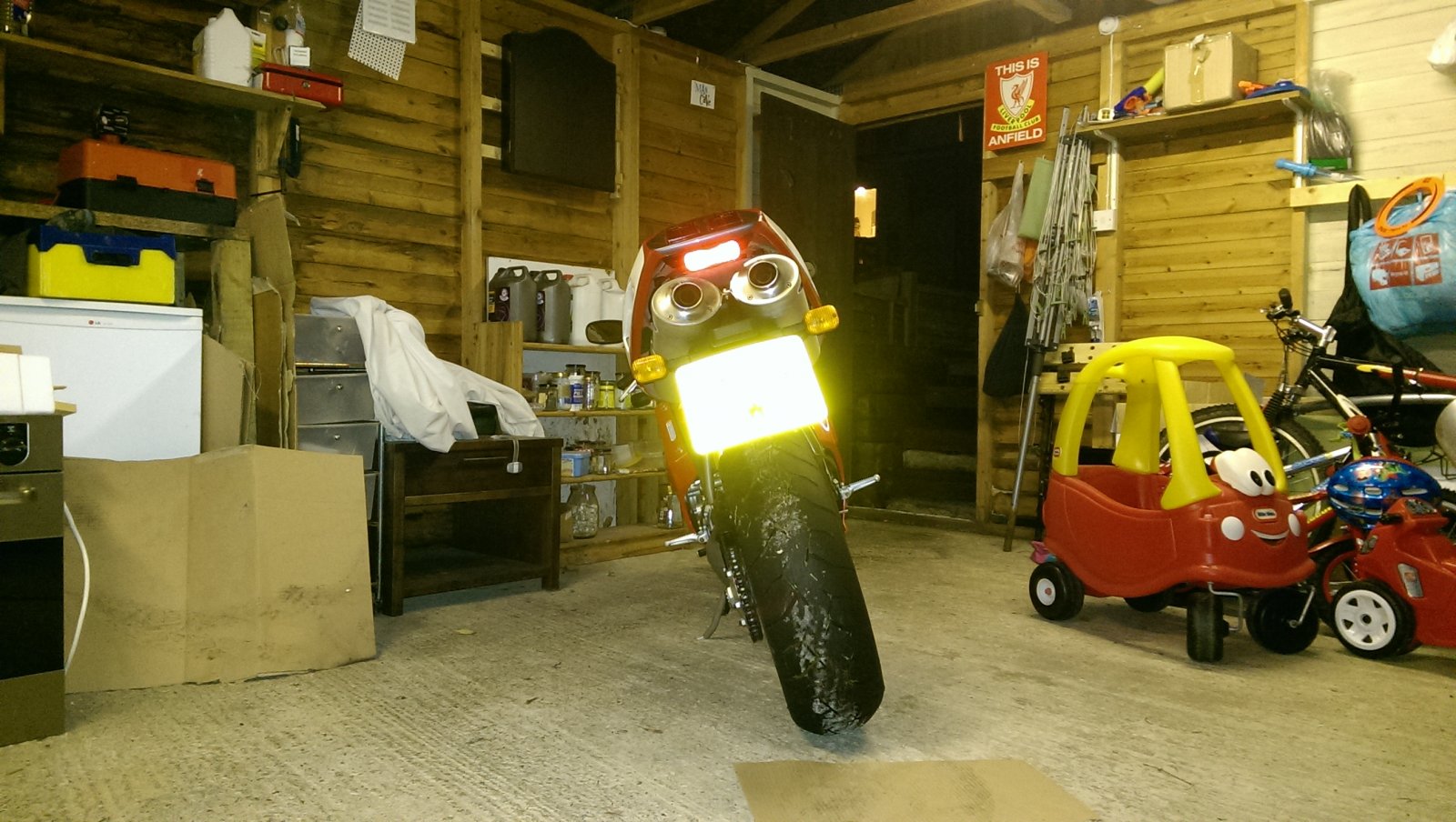

  3. Ok here are some more pics (after a quick re arrange of the garage to put it next to the wall). Both screws for the bracket are there. The pic of the lean angle is with the front wheel pointing straight forward.
    Should the side stand have that 'kink' in it?
  4. The little kink at the bottom of the stand is normal, looking at your picture from the rear of the bike the lean angle doesn't look to bad to me, I have seen a lot worse. The lean angle does change when the chain is adjusted due to the concentric hub.

    Garage has been rearranged so the bike now leans towards the wall so if it does do it will only be a few inches then the mirror will break its fall!
    I have also left the steering lock off (massive chain and ground anchor attached so if they get through that the steering lock would not stop them anyway) and pointed the wheel to the right to keep it as upright as possible. I will get OnYerBike to check it when they do the cush rubbers. Its quite hard to check a side stand with no paddock stand as you need the side stand.

  10. Just spoke to Baines racing, they think I have bent the side stand bracket. apparently you can't bend it back again. Whoop, another £100. Off to buy an Abba stand now.
