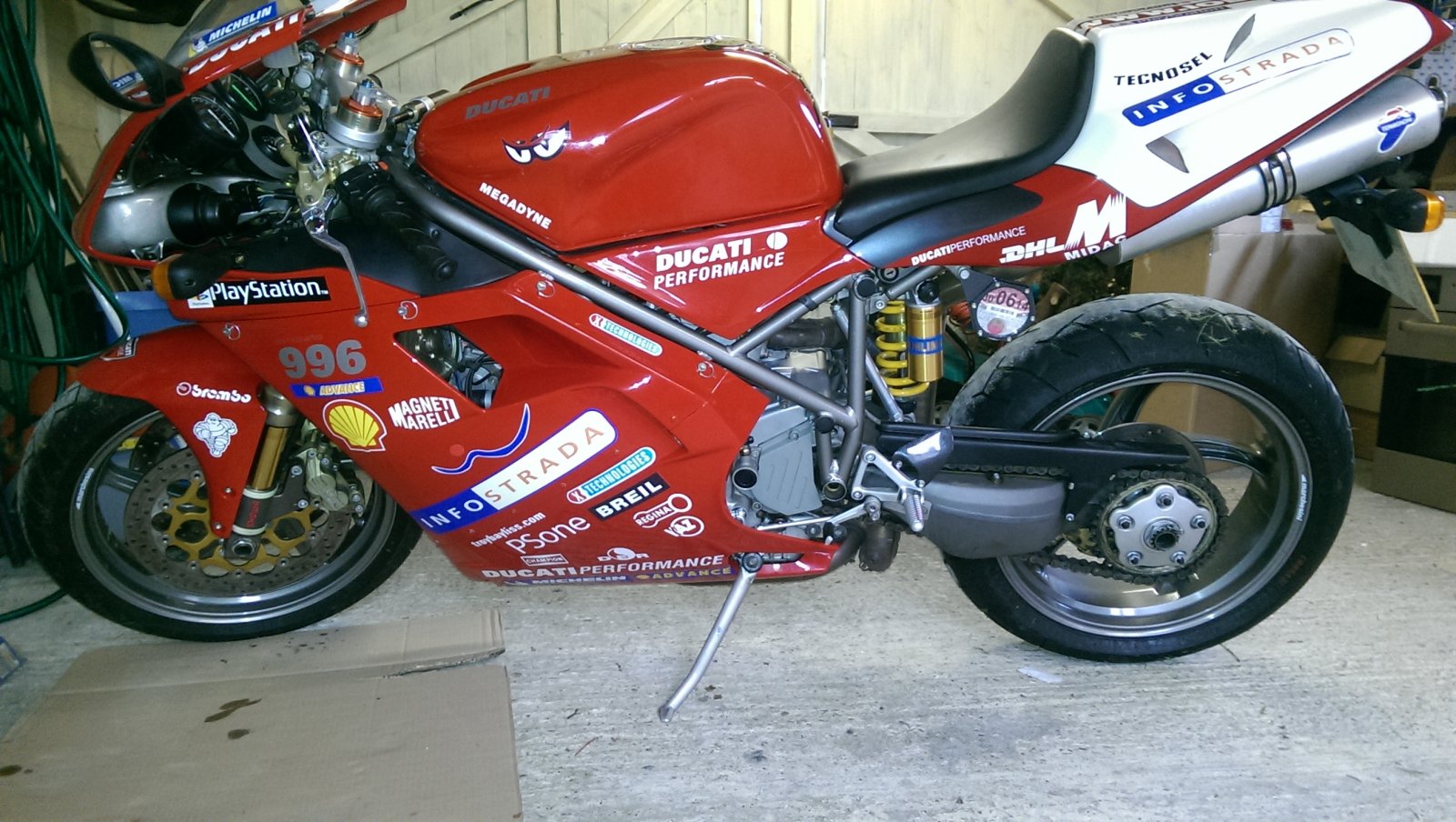

  2. those look like standard stock termi pipes? so them termi stickers you have are just for show?
  3. No, the 2002 996 came with OEM Road legal Tergi's. I think.
  4. Sorry, just 're read. I think the stickers should be on as they fit over an engraving of the Termi symbol. Don't know for sure.
  5. yeah, but they dont suppose to have termi stickers on them
  6. Ah OK. I think the previous owner was a little sticker happy.

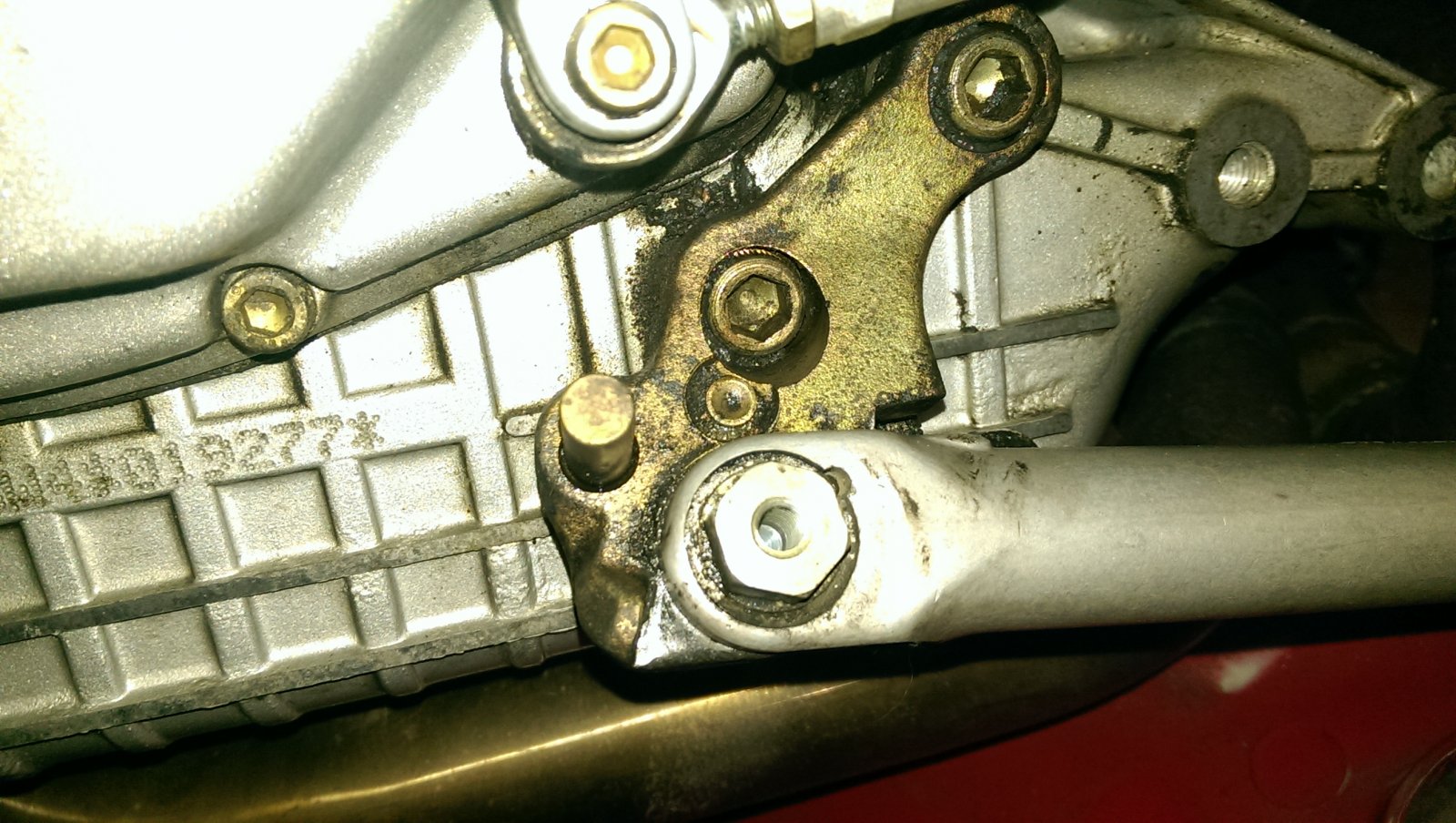

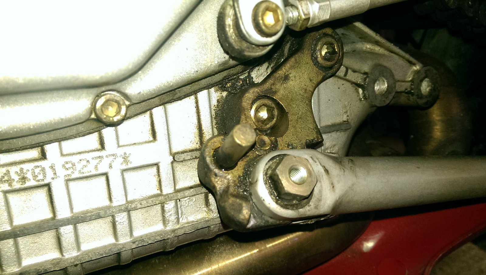

    Firstly, Abba stands are awesome. Only irritation is it flicks up the side stand and you can't get it back down again and that I could not remove the fairing past the side stand. Note to self, remove fairing before putting on Abba stand.
    Secondly, the fairings are amazingly easy to get off (if you take them off before putting on the Abba stand) and put on again (sideways screwdriver through the D clip required for the two under the belly pan, I would imagine caused by a little dirt).

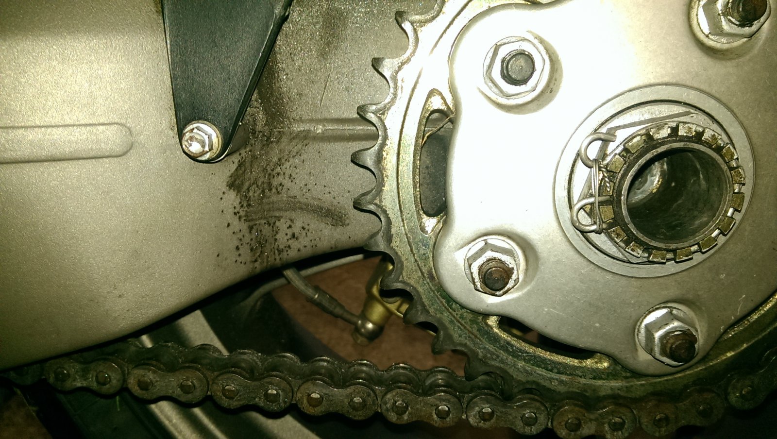

    The bottom bolt for the stand was 1/4 turn loose. I have tightened her right up (1/4 turn with a poxy little allen key so not over tight I would imagine) and it looks better, pics below. Opinions please.

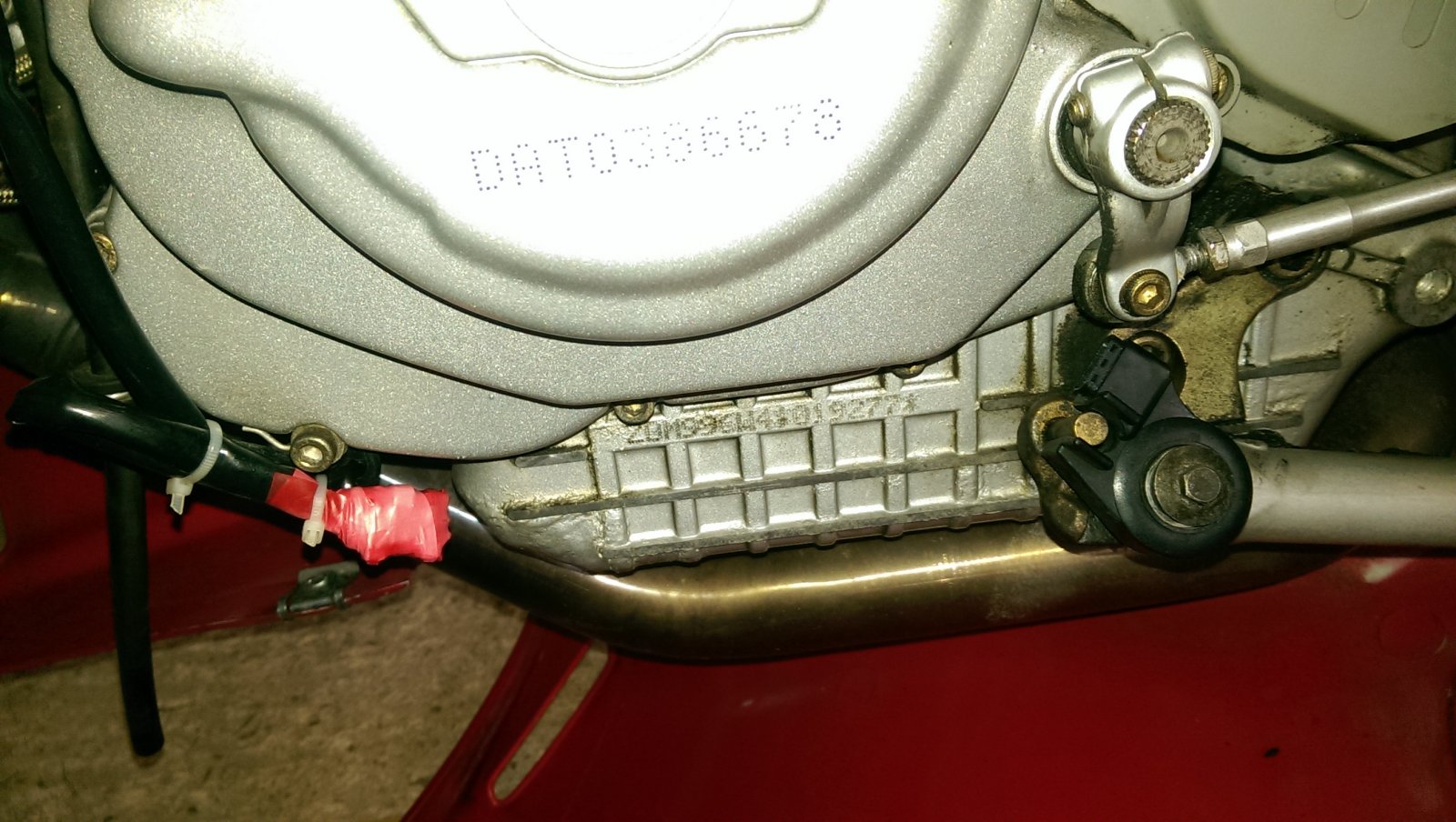

    Also, am I right in saying the cut-out switch has ben unplugged? Would this be so you could start it on the side stand to warm her up?
    The engine looks in good condition although a little flaking silver paint but she is nearly 15 years old so I imagine this is normal.
    However (ain't there always) I could not see any oil through the site glass when on the Abba stand? Is this normal as the oil goes to the front? I have not held her bolt upright not on a stand yet to check if any oil appears.
    Peace

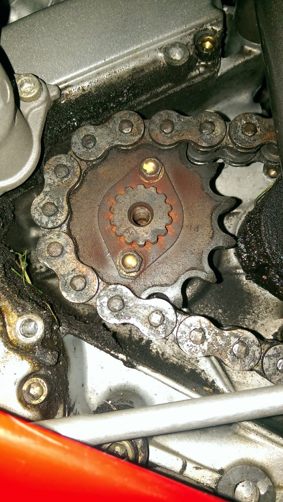

  11. Also (again), does this front sprocket look a little worn? the rear looks OK to me.
    14T front, that's not standard is it.
    PS, don't they look dirty close up on a stand when you get in close. Mucho cleaning this winter.
  12. It looks like the sidestand cutout swith has been disconnected - no wires going to it plus red insulating tape on what is probably the original wiring.
    Sprocket looks fine - very serviceable.
