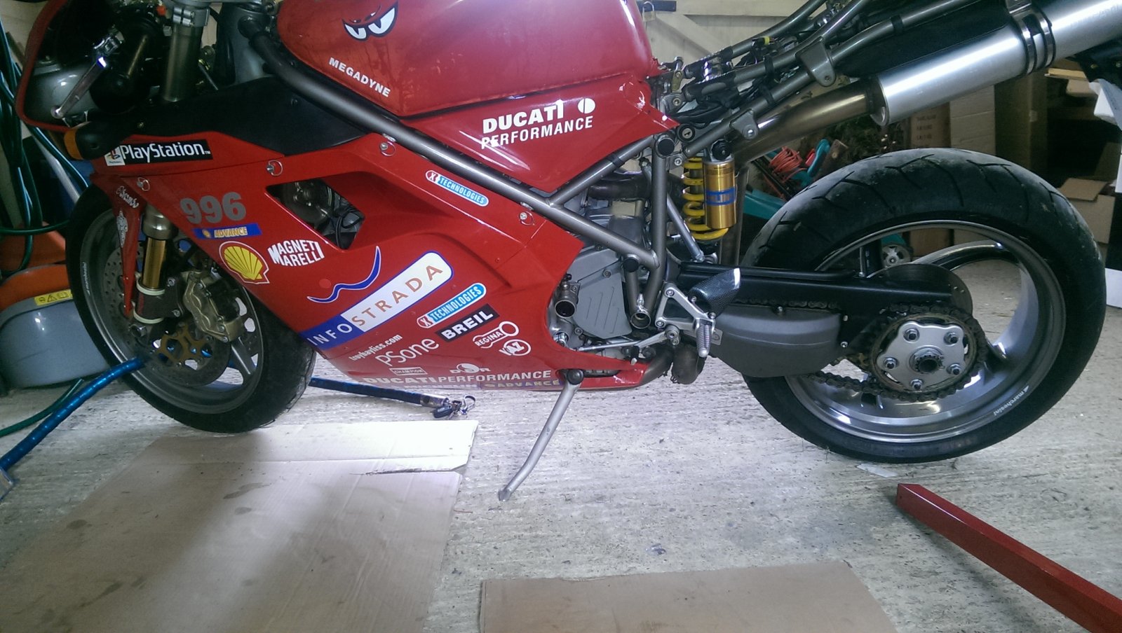

  1. Last pic of the side stand (until I get a 1098 stand). I loosened it right off, moved it around on the bolts as much as it would give to lessen the side stand angle and bolted her up hard (not bought any thread lock yet) and think she looks fine now. Happy morning tinkering.

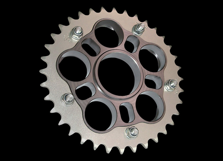

  17. Obviously they are sending the JT carrier too?
  18. Are you saying the JT sprocket will only fit on a JT carrier and not a OEM?

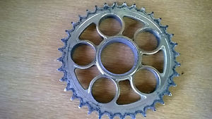

  19. OEM is a single piece steel sprocket, the JT is 2 parts a sprocket & a carrier.
    JT
    OEM
