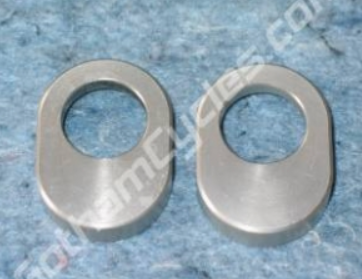

  2. your pictures dont work...eccentric washers do you mean the offset alloy parts that sit in the frame?
    as i remember the spindle spacers bearings etc are both the same..
  3. you mean these... i think all 749 999 had them

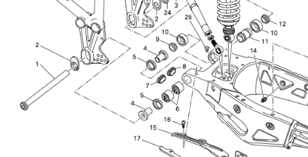

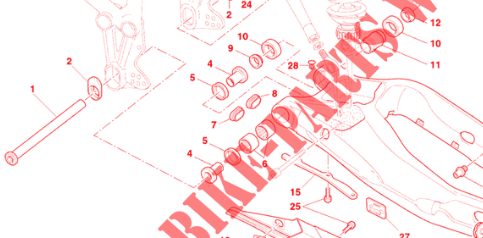

  4. No 2 on both styles of arm...
    Screen Shot 2020-02-06 at 21.25.20.png Screen Shot 2020-02-06 at 21.25.30.png

  7. Early 749's didn't have the Swing Arm pivot adjustment by the looks of the part diagrams :thinkingface:

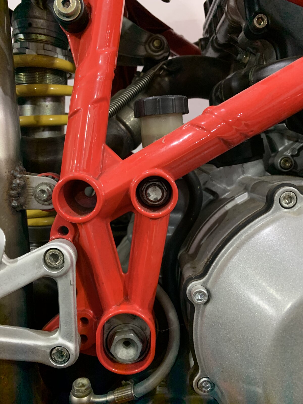

  10. Same image used from the 999 on the Parts Fiche, that's a 2003 749 frame in the pic and the Op will be able to verify if he has a round hole :eek:

  13. Parts books from 03 749 to 06 999 all have the same pivot shaft part number and show the same oval washer with part number 75610071A, 748 pivot shaft has a different number to the 749/999 one

  15. Not on-line where I'm looking: they don't show the oval bit on the 749 - the 2003 999 does show the same pivot shaft though, but cross referencing the 749 doesn't show the 999 on the listing - I think the shaft is the same, 749 frame is round and not oval from the pic I posted earlier...
