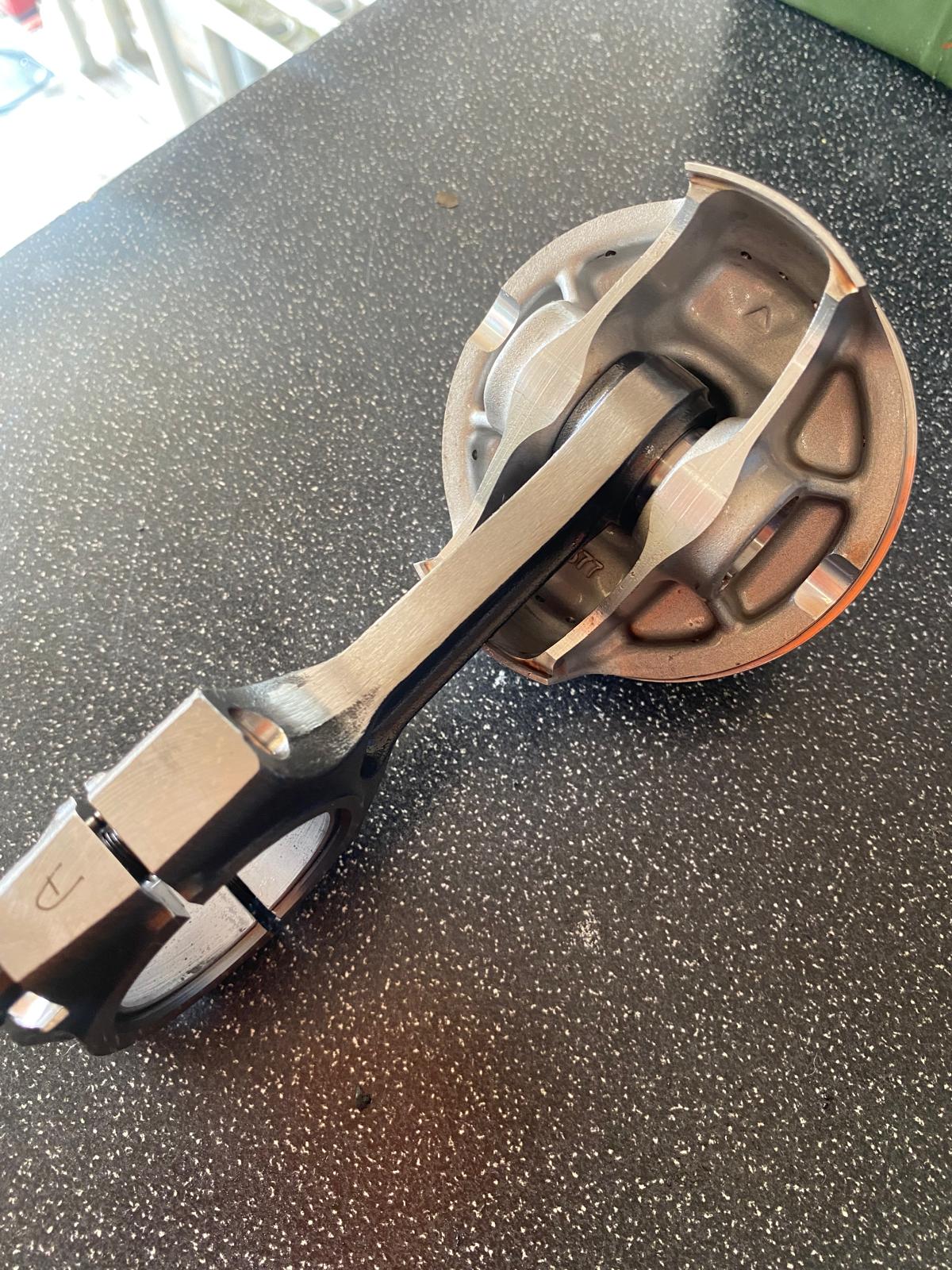

  6. So far everyone thats commented hasnt seen it....im in for a crank and shells to him but i got off lucky....engine is back with me now, going in saturday night.
    Might sound weird to a lot of people but once it had failed i was almost happy (in a weird way) to get the motor out...
    Quite excited to get in there saturday night....
  7. Lovin your dedication to this project, it must be heaps of fun to ride.

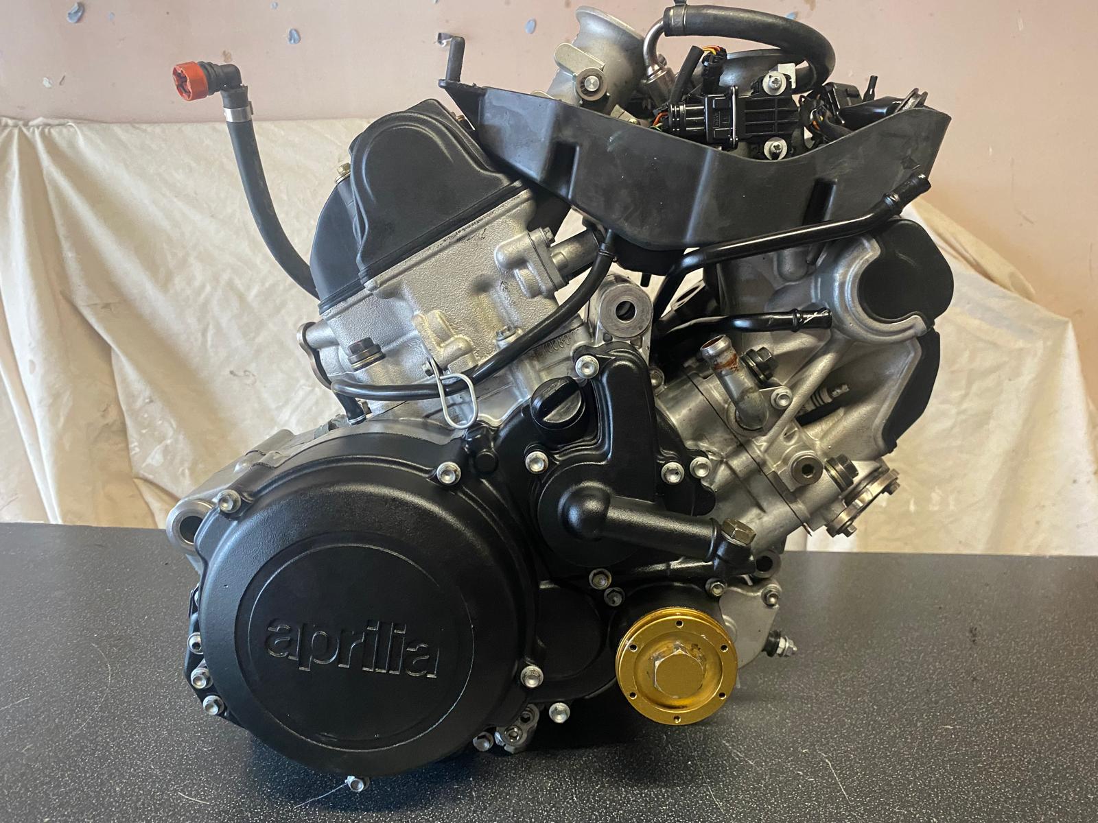

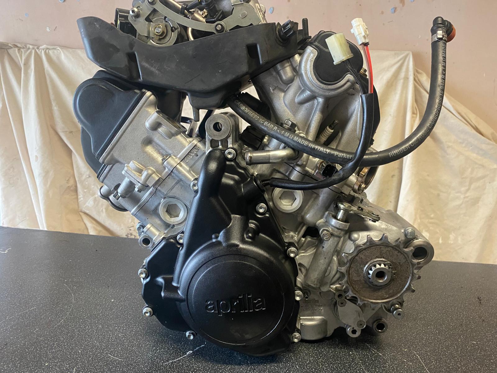

  8. It will be (and it was!)...just got the engine back in this morning. And, i have to say its probably the easiest engine ive ever refitted....so im told by one of the lads on the forum i think from bench to riding about an hour and 40 mins... prepped engine with no fuel start to get oil round the shells. Prime the fuel pump and it started straight away.

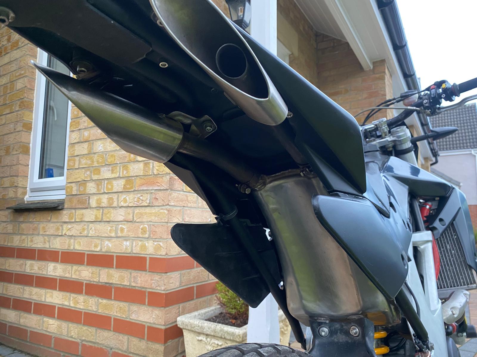

  15. Yeah I’d seen that one but it looks like a track bike to me which is a little off putting. No headlights no brake lights, I know we’re supposed to be rebels but just makes me wonder if it’s had the loom hacked to bits.
    I don’t ride at night it just that screams ‘pull me over’ mr plod.
    The plastics don’t look great either, maybe having a chat with him might yield answers I’m happy with.

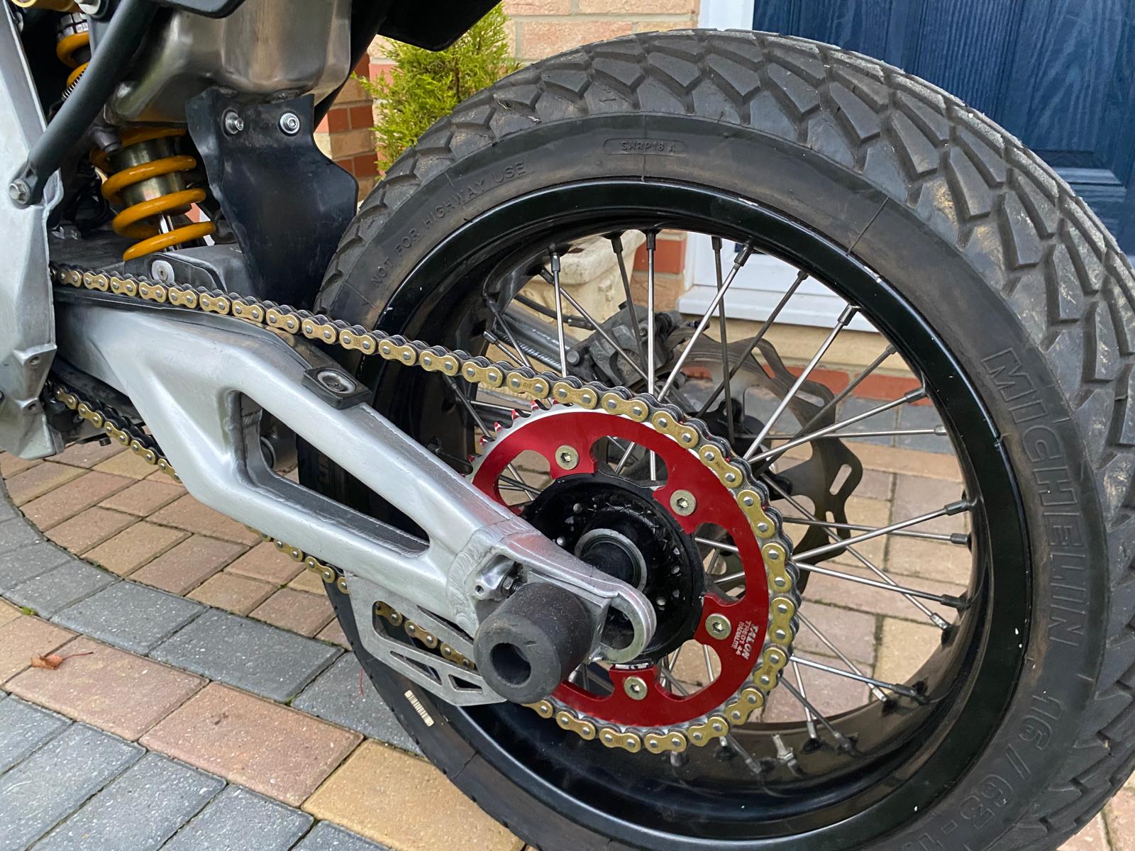

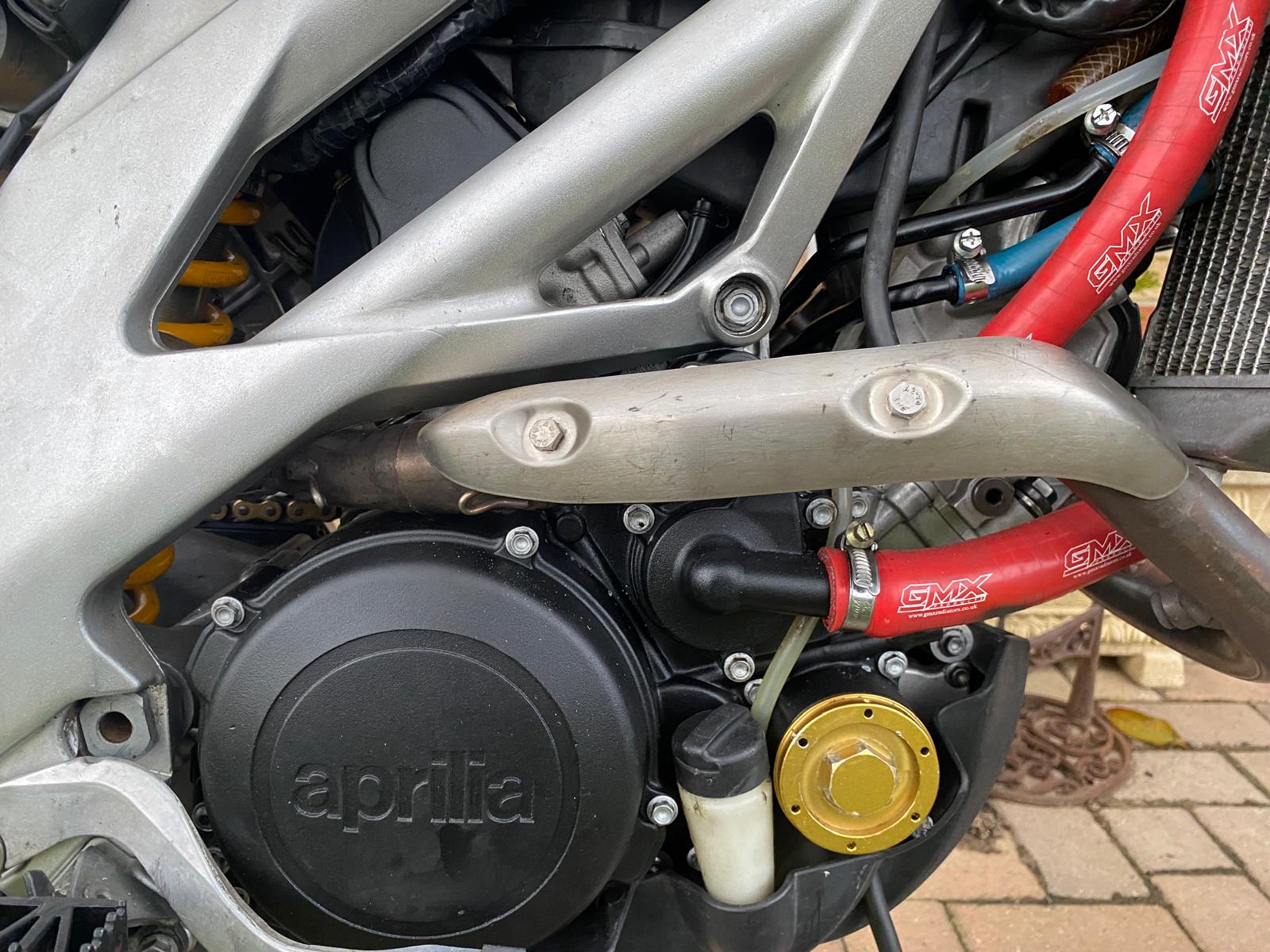

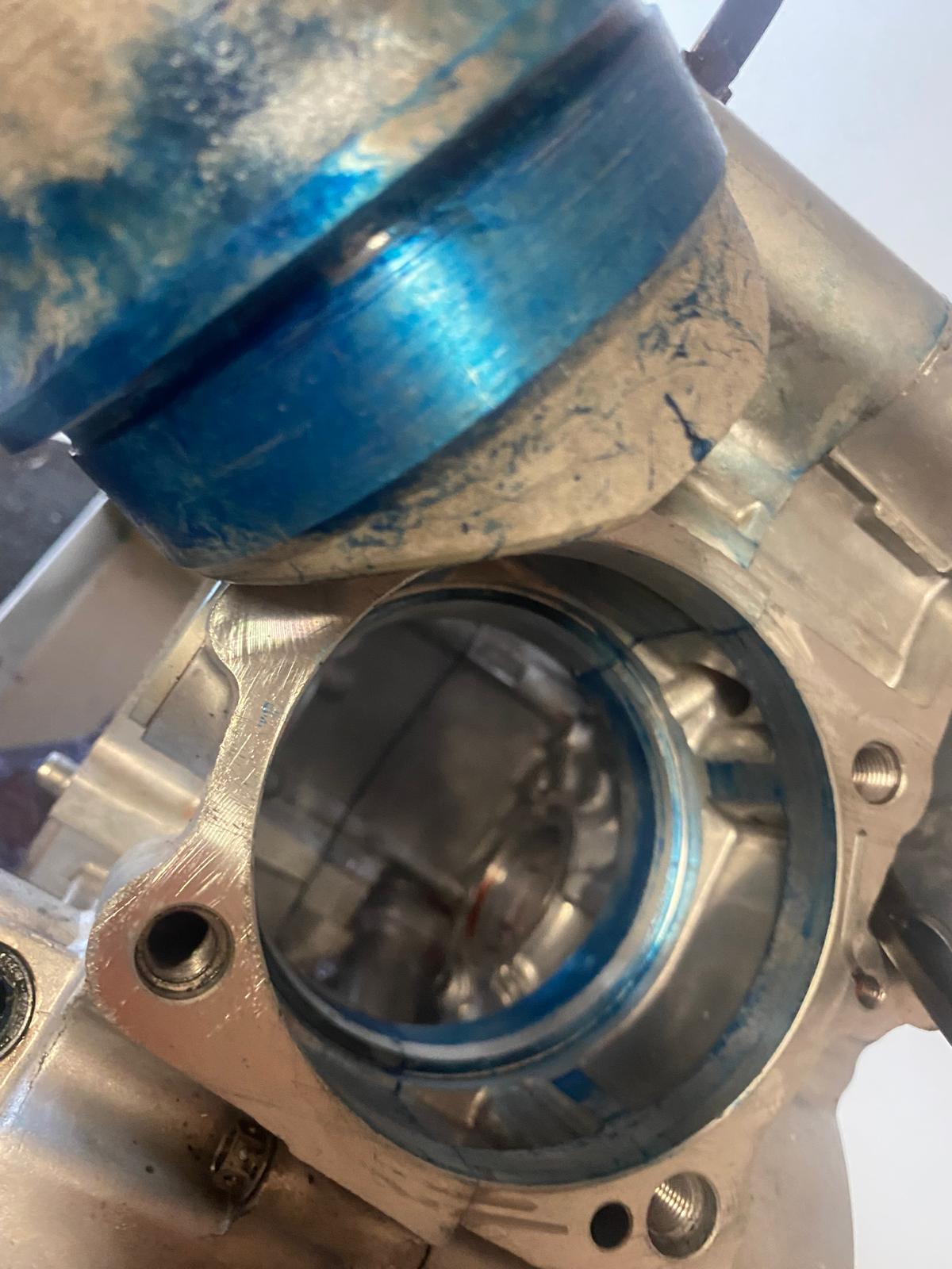

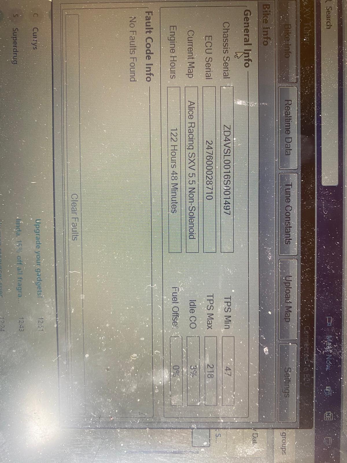

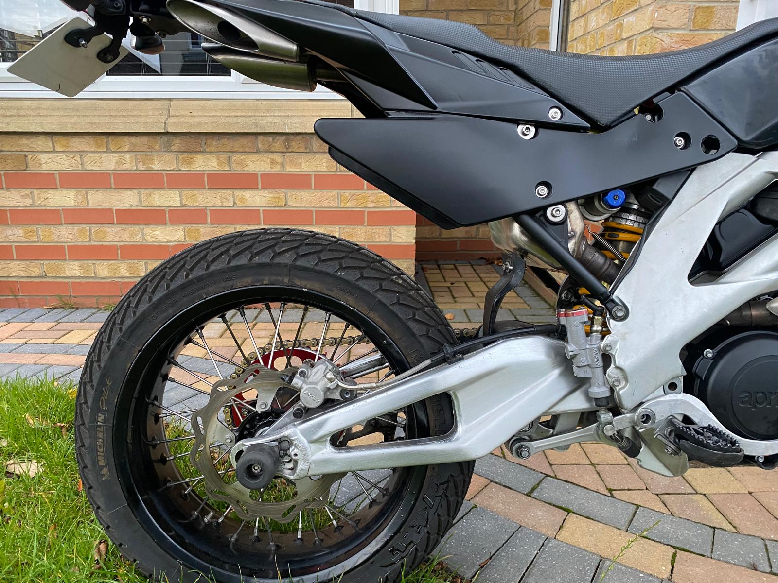

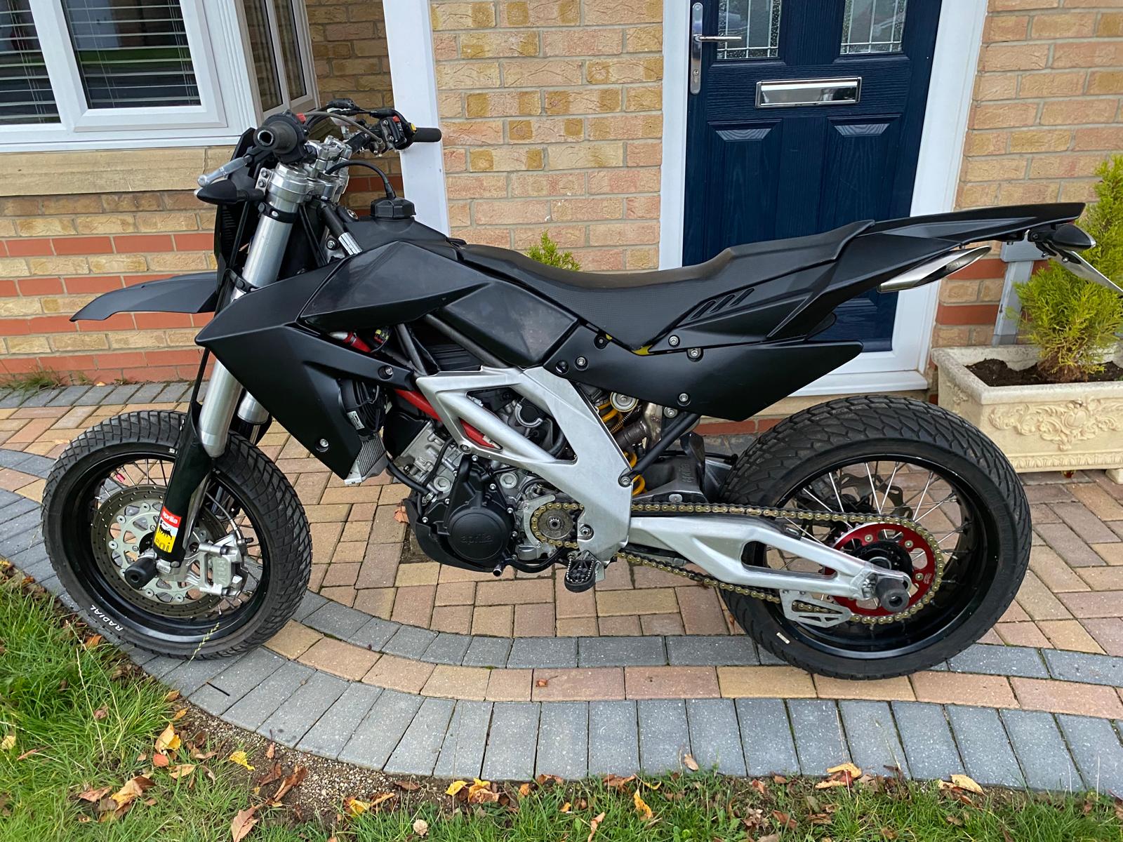

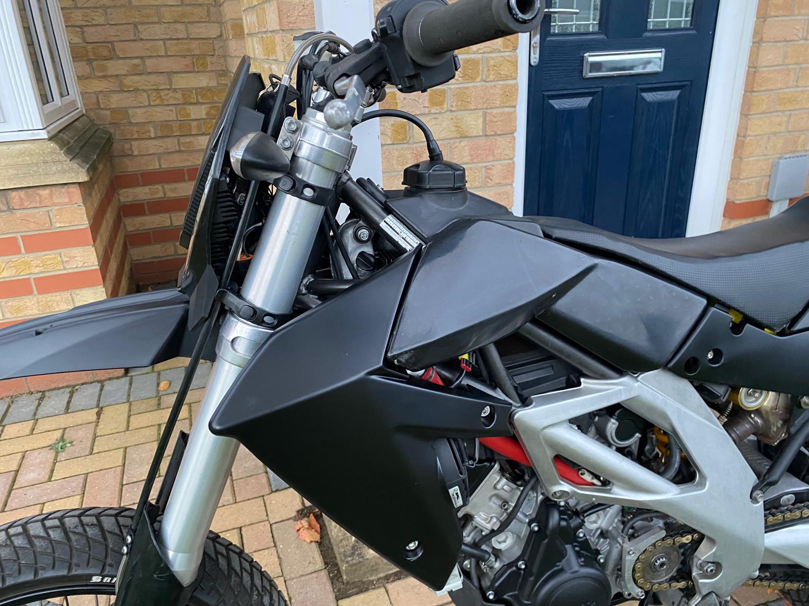

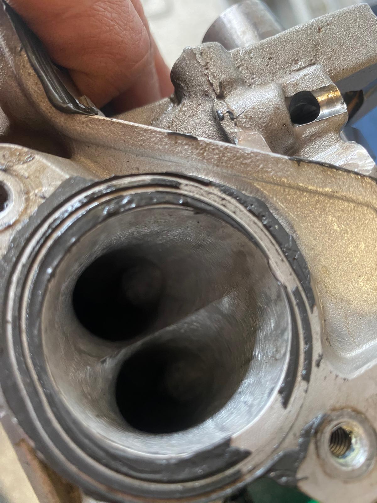

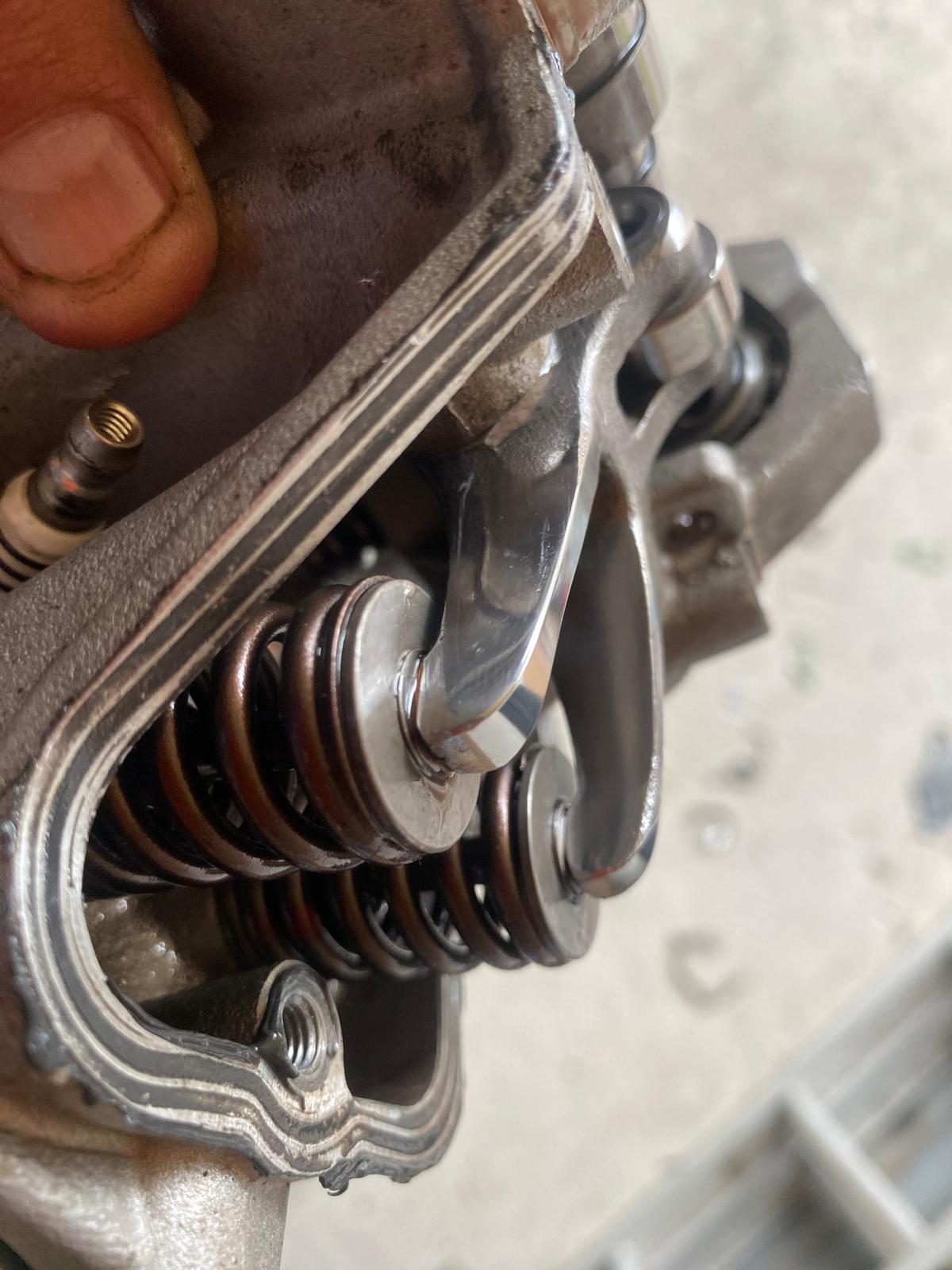

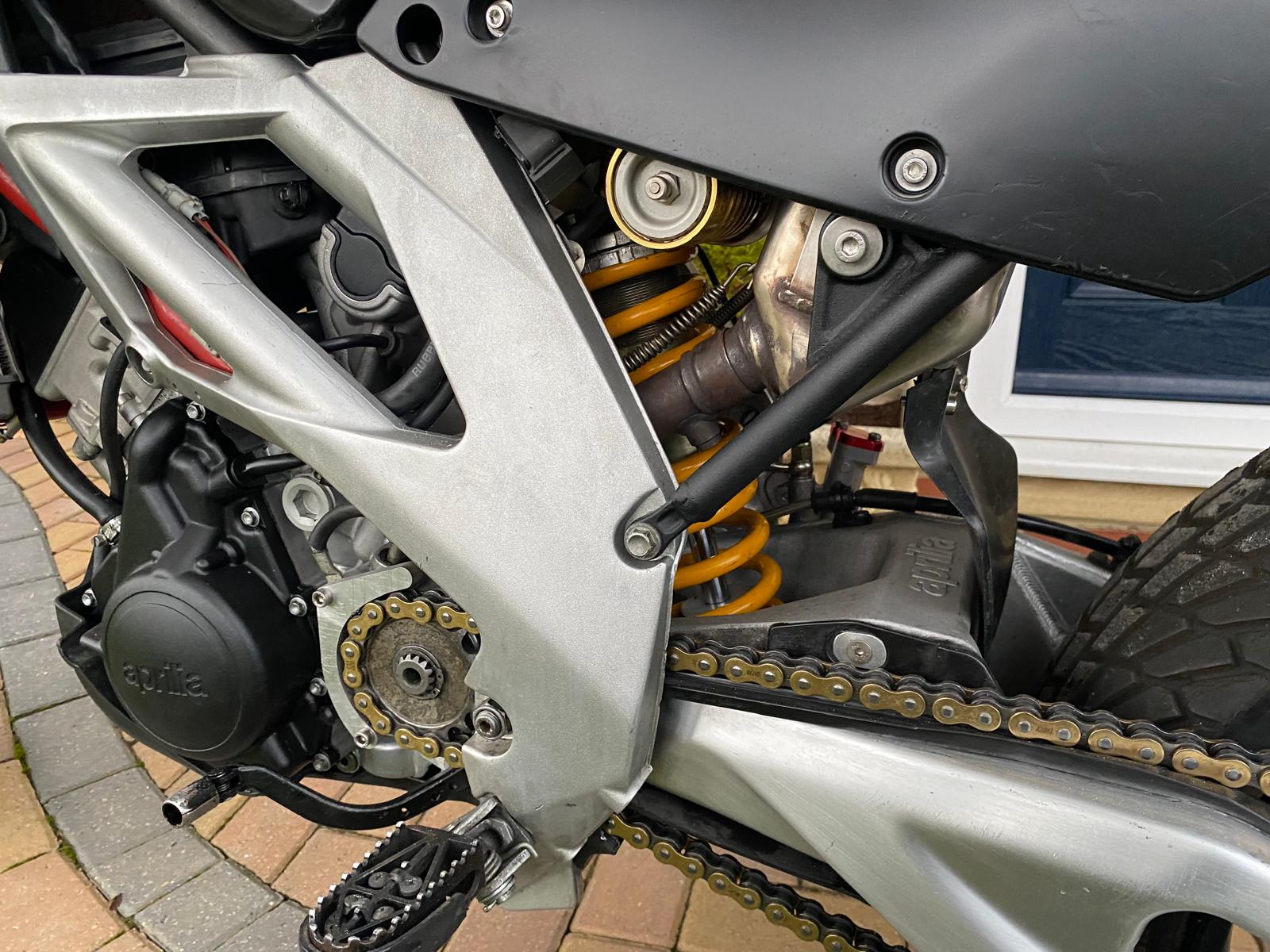

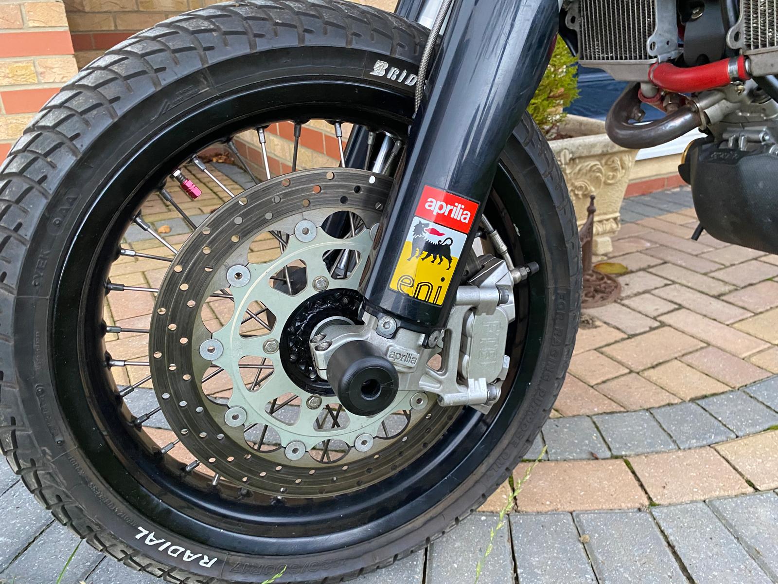

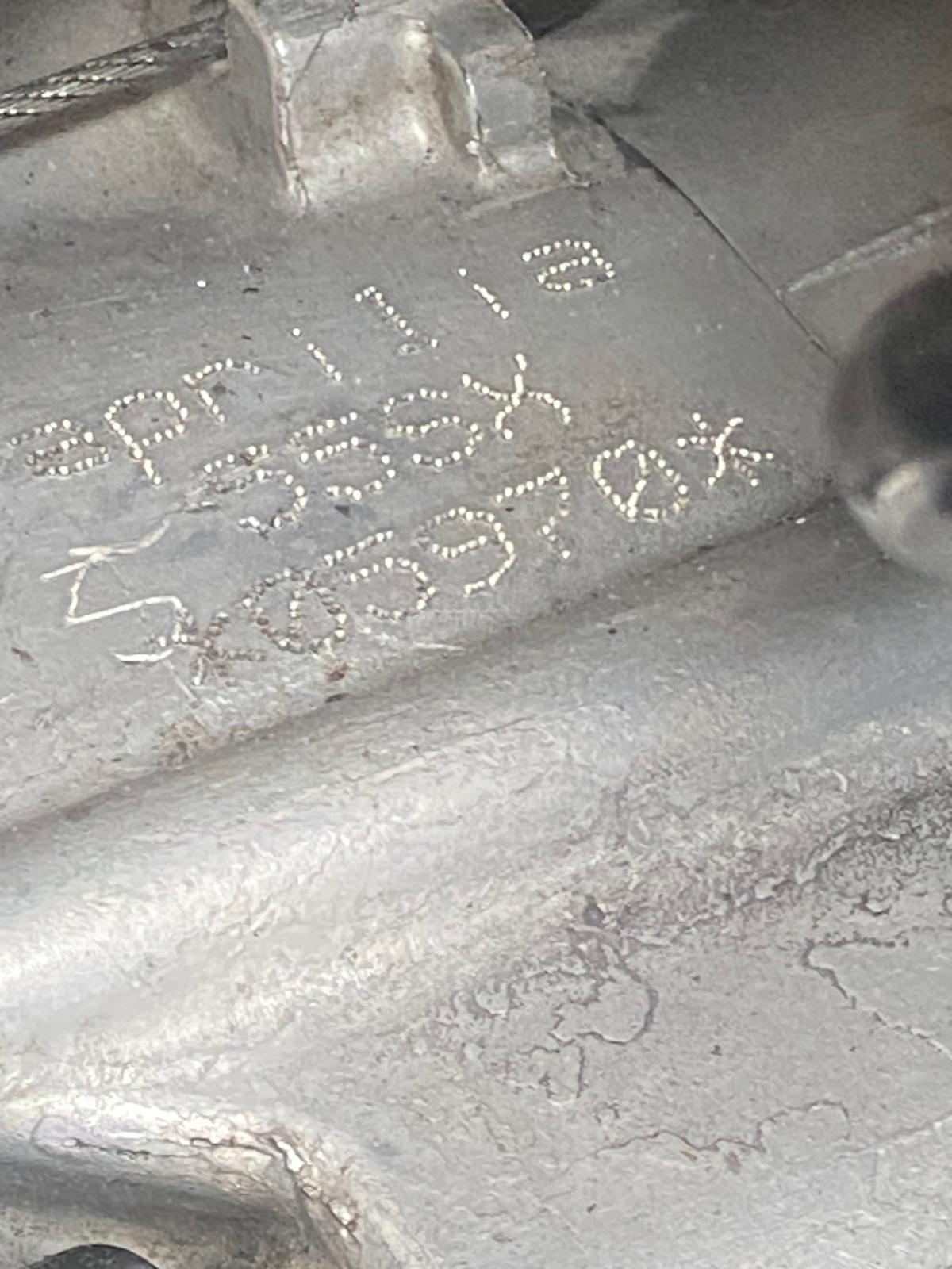

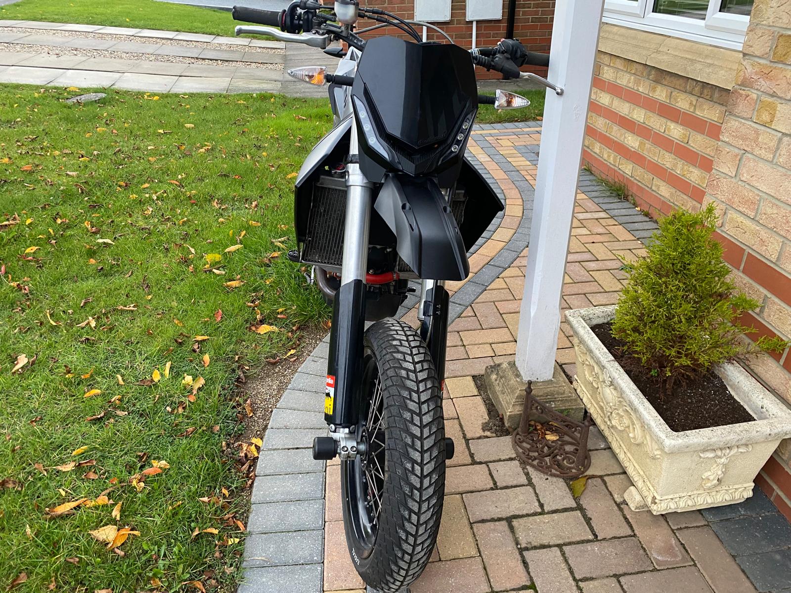

    Looking to sell my sxv 550. This bike has just undergone a light restoration as you can see by the photos. Loads of powdercoating and new stainless steel fasteners. Plastics painted satin black. I think it looks awesome. Condition is superb. Bike wants for nothing. Starts every time hot or cold and runs perfect. Here’s the best bit. It’s just had an engine refresh. Cylinder and casings lapped in and deck heights set. Liners machined to ensure no more head gasket issues. Everything measured and to spec. Rebuilt with new gaskets, oil seals and o rings where needed including the all important oil pump and stator cover. Engine is absolutely like new inside and out as has only done 120 hours. Frame and engine numbers match the v5 and also match info stored in ecu so this is a very original bike. . See photo. Conrods and valve rockers are polished and mild porting has been done on the cylinder heads. You won’t get better. Just had a full years mot put on it.
    Bike was never road registered from new. I’ve just done this and it’s in my name and I’m the first and only owner on the V5 logbook.
    Bike was never a race bike. It had only done short hills climbs from new. It’s an official 2007 uk bike .
    Currently does not have clocks or side stand. That’s it.
    To summarise, this bike is in great condition, needing nothing. Starts on the button every time. I have done 50 miles or so on it to run the engine in and check everything is ok. Has current mot.
