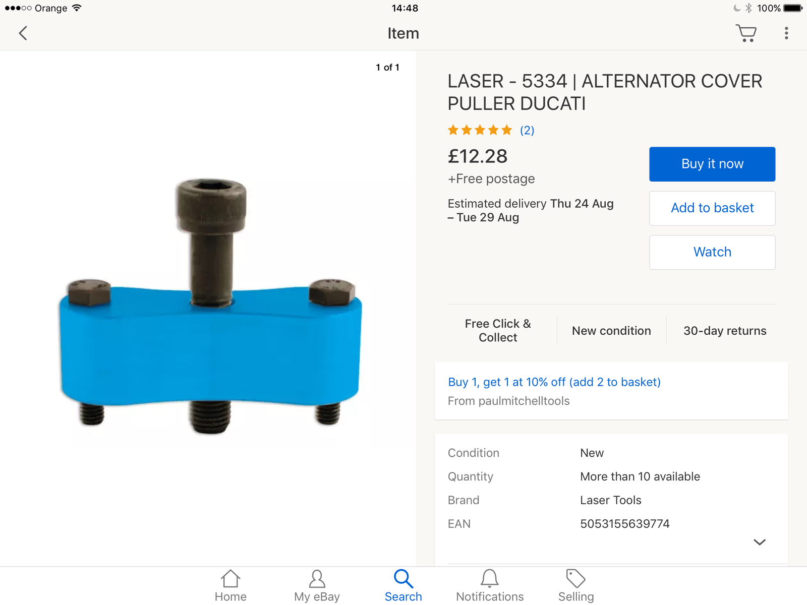

  2. IMG_2265.PNG Hi pal. Best to use the puller tool. Only a few quid or make your own. Best to take the water pump cover off too as it makes lining the water pump shaft up easier.

  6. Thanks all. Thanks Ian for the puller link, have ordered that so will have to wait for it before I progress any further.

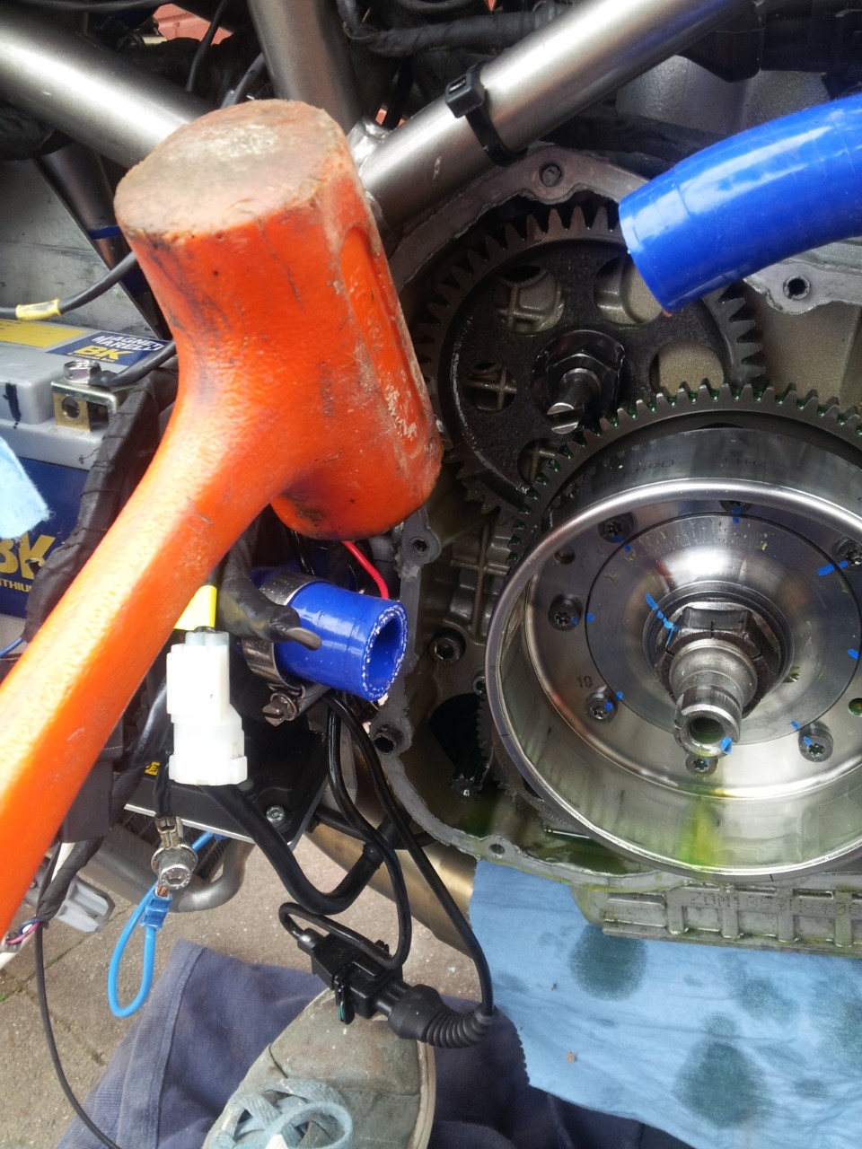

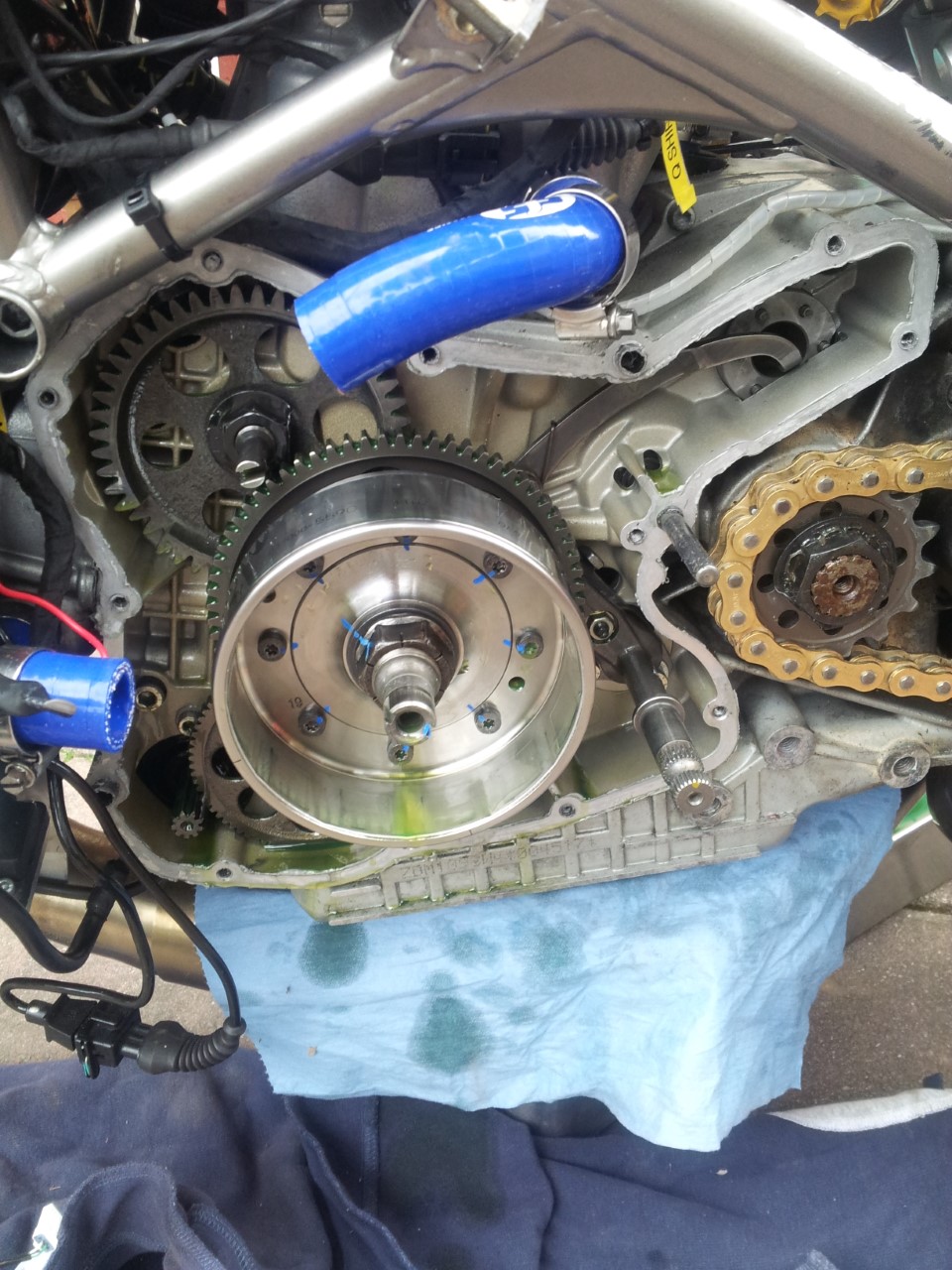

  7. I have just taken one off since posting earlier.
    I used the head of a dead blow mallet between the frame and the water outlet pipe on the case, to the left as you look at it. using the handle as a lever, it just popped off. cover.jpg cover2.jpg
    #7 ducati dad, Aug 20, 2017

    If you have the flywheel off, you can shock the nut loose with an impact gun. Tightening ( torqueing) back up u should really use a flywheel locking tool.
    I purchased the 'Laser' brand of tool and found it wouldn't fit properly ( not offset enough) and ended up borrowing a genuine tool.
    Just to save you a faff!......

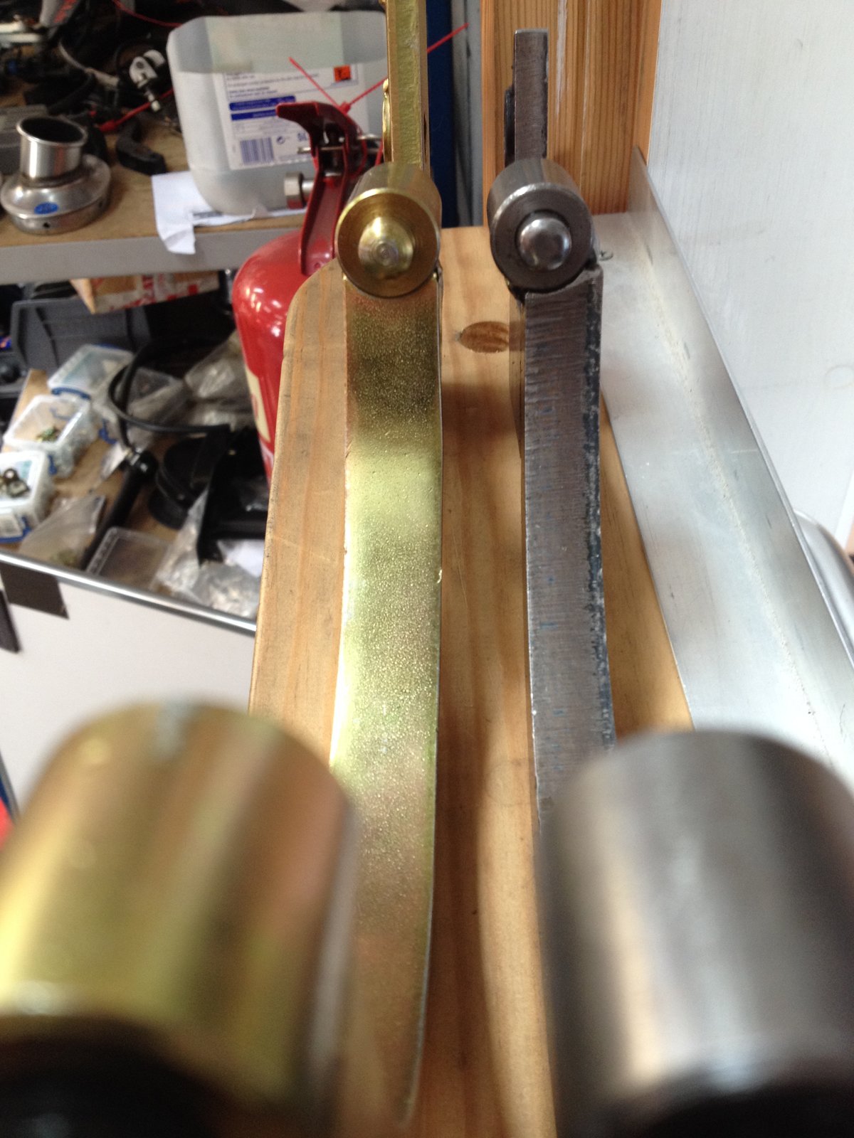

  18. No, just turned down on a lathe
  19. Downsides??
  20. Yes they fit and no they don't :)
