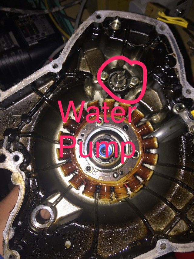

  1. No, not that i'm aware of. Bike didn't get hot or anything, just had trouble starting and then made a metallic noise as i was going along, which i presume was the bit that fell rattling around the internal of the engine.
    Do i strip it down myself (never done it before) or get a mechanic to do it - any idea how many hours labour?

  5. Just a thought after perusing the photos a bit more, is the black bit in this image supposed to be there, looks like it is making contact with the teeth which would lock it up and might explain the part snapping off?
    https://ibb.co/mgUYGv
  6. The black bit is the timing sensor and should be around 0.7mm clear of the teeth, almost touching.
  7. Nope. Thats the crank position sensor. And needs to be within about 1mm from that gear. You may find there's a notch in the side of the gear too.
  8. I'll go check at lunch and see if the timing sensor is indeed clear by the 1mm, and also if the water pump is still turning or seized (thanks for the info NM).

  12. That shaft drives both the water pump (in the left-hand casing) and the cambelts on the right hand side. It's the water pump drive part that's broken off, is it the whole tab that's broken or just part because it doesn't look that broken to my eyes? could be the angle of the picture (or my eyes) though but I'm just wondering if there's enough of it left to still drive the pump?
    As said above, you need to split the engine cases to replace the shaft.
  13. It's a shame the corresponding part on the water pump couldn't have been designed to fail instead of the shaft, if the water pump seizes.
    It would have saved an awful lot of grief...
