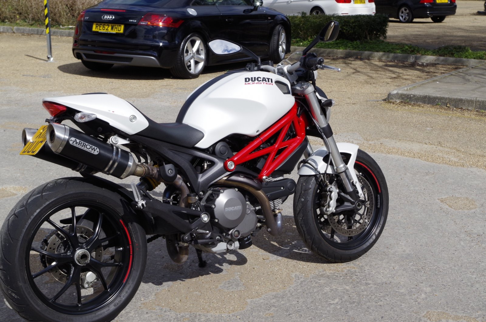

  6. Build quality of the Arrow I've just fitted to the 1200R is good, noise is not offensive with or without the db killer (in the shed at least! Lol!) and price was good on eBay
    Ped
  7. Had Arrows on my old 796 - good quality , not too fruity with the baffles out - but had the little Cats at the front of the silencer too - no mapping required if you keep the cats
    Probably a different story if you remove them tho

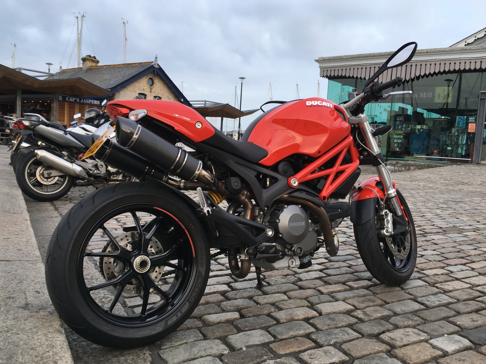

  8. IMG_0047.JPG I think the SC projects look good relatively cheap and look much better than stock
    #8 Paul Mason, Mar 31, 2017

  11. Those doo look good! Much better than the huge OEM things they supply it with. It's a toss up between these and the LV Ones I think for Mrs M...
